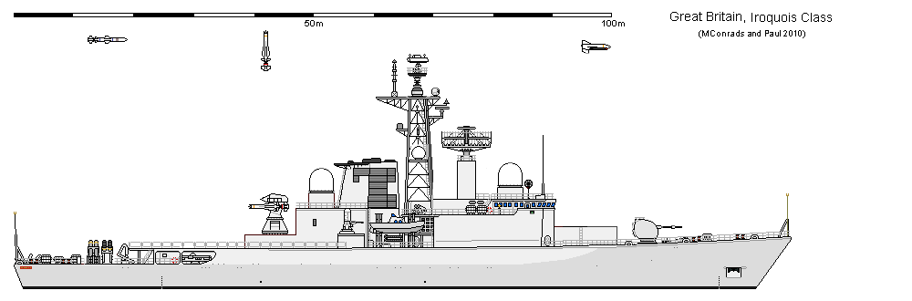

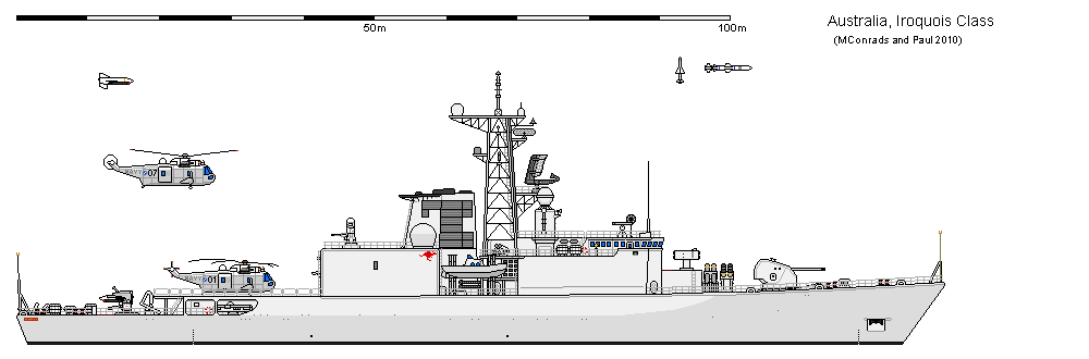

Had the inital idea for the RAN, RNZN & RN then when I posted them. I thought for the RCN one to reposition the Harpoons
DarrenP
#18
RAN Bunurong Class DDH
RCN Haida Class DDH
RNZN Te Kawerau Class DDH
Oh well done Darren - nice one (s)! :thumbsup:
Makes me realise something else though: if it had VLS Seawolf, then:
a) The VLS array would probably take up all the space from the bridge to the turret,
b) It would need two Type 910 Seawolf tracking arrays fore and aft for 360 deg coverage: the aft one would have to sit where the Phalanx gun is on the post-TRUMP Iroquois.
DarrenP
Yes had figured that out as well also the 6 round launcher obscures the forward vision from the Bridge. Though Phalanx could go on the hanger roof abaft the funnel where the satcom dish is. And the Radar will fit. If you took the Ikara off then the Harpoons could go in its position
Quote from: DarrenP on January 08, 2010, 04:14:13 PM
The six-round launcher also needs a ready-use missile store and working access & space for the reloading party (all those doors under a Type-22's bridge). If you had Phalanx abeam the funnel, where the satcom dishes are, then you could have the smaller RN-type satcom dishes on the side of the mast. If the forward Seawolf tracker was above the bridge, then you could have Harpoon behind it, in a similar installation to a Type-22 batch 3.
Something that always puzzled me about Canadian Sea Sparrow: the launchers come out of the sides of the deckhouse thus allowing it to be mounted under a radar or weapon, and yet in the only actual installation of it it's put in B-position, on the centreline, just like a regular launcher, with nothing on it's roof because it would obscure the view from the bridge. My inclination would have been to put it amidships, just forward of the mast, thus freeing up B-position for something that actually needed it.
Silver Fox
Great profiles!
That early Sea Sparrow launcher was manpower intensive... maintenance wise. I think it went in the 'B' location simply so it could be serviced... probably why it also only got installed on one class. There was a rumour that the US looked at it for the Iowa class, apparently the weather shield would have protected the missiles from blast effects during main battery firing. Interesting thought. :)
DarrenP
#23
That might work weaver though top weight and obstructing radar arcs might be an issue. Though when you remove the sparrow radar's it does give plenty of room on top of the bridge and main mast space is saved fitting a type 967/8 at the top of the mast. On the Hanger roof then is the issue of getting clearence of the Type 910 over the launcher and again access for the crew and ready missiles to the hangar roof though maybe not a problem with VLS.
Some of the top weight may be saved by cutting the number of Sea Kings to 1 or carrying Lynx instead.
Silver Fox
Narrow the hangar and add VLS cells down either side? That would be interesting!
I had wondered about a less drastic TRUMP, without the role conversion from ASW to AAW. Keep the 127mm in the A slot, replace the Sea Sparrow box launcher with a VL Sea Sparrow as fitted to the Halifax frigates. You would need some standoff from the bridge front... but could be a good fit.
Humurous to imagine a 280 DDG with no helo facilities. You get a lot of available displacement to play with and space. Big VLS array aft? CIWS in B and X positions? You would definitely want Ikara then... gotta have some standoff ASW capability!

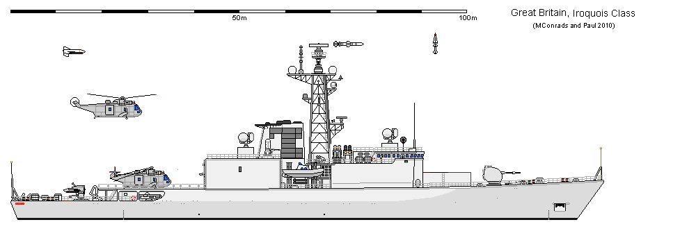

#27
RN Iceni Class DDH
RN Brigante Class DDG
Love the topic, any chance of the profiles based around the original configuration ?
Dont forget the UK variant would more likley have a plated mast of possible different configuration.
If the Hanger was configured to a Single seaking then you could use the offset side for VLS missiles in a similar fashion to the Karel Doorman class the Dutch had.
Alternately there was also the light weight seawolf launcher which could be installed behind the bridge.
Now who is going to build them ?  ;D
G
DarrenP
#29
I do like the original Funnel configuration but it gets in the way of adding systems.
Yes the single hangar/VLS is a good option for all nations. The lightweight 4 round launcher might be an option or maybe a 2 round power loaded system infront of the bridge.
The DDG has no hangar just a landing platform but the space would be taken over by accomidation to replace some lost to the sea dart system/magazine.
Engine plant as sugested tyne/olympus or tyne/spey.
