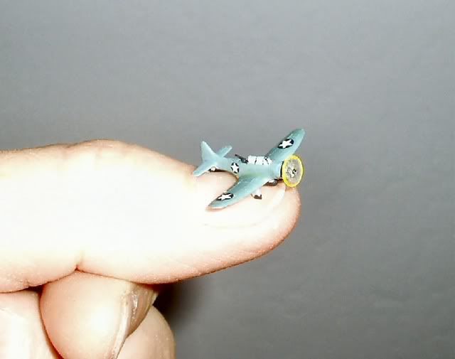

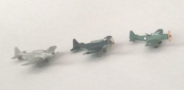

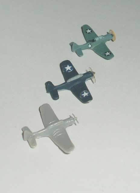

I had some setbacks with the decking project, so while cooling off, I decided to test out a scheme for Enterprise's aircraft.
The main "armament" will be a squadron of SBD's, though I will also have a token F4F and TBD. The pictures below depict the "raw" kit SBD (notice TWO-bladed prop!), the former model's rendition, and then my new rendition. The former model had too-dark paint, silvery decals, no side decals, and although the "spinning prop" was a grand idea, this particular one had the center offset. Notice the "elephant trunk" undercarriage.
My new rendition has proper light blue-gray topside, cocades in six locations, thinned undercarriage and "tires" painted, a bomb underneath, cut-away gunner's position, rear-defense gun (regrettably, only a single fishing-line gun-when I tried two tinier fly-fishing-line "guns" it was just frustratingly impossible to get it right), canopy framing, and centered "spinning prop" with yellow tip ring. Seemingly a lot of work for a plane that could fit on your thumbnail like a carrier's elevator.
Are they 1/700 scale?  :o
Whatever scale they are, and they must be small, your new SBD looks great, well done indeed.
#23
Not quite 1/700, but tiny all right!
This first "prototype" of a Dauntless went pretty well, though for the "production" SBD's I think I will used thinned yellow for the props (too bright as it is), actually use a round black circle for the wheel (half-round was a good idea, but looks like the Dauntless had two flat tires) and a smaller bomb. Otherwise, I like the look. I may vary the canopy configurations on the others just for variety (some open pilot area, some closed gunner area, etc.). This prototype MIGHT be the one "coming up on the elevator" so one doesn't see the above imperfections. In that case I will scrounge a 3-bladed still prop.

I think the panel lines need more highlighting... ;D
Quote from: GTX on March 15, 2010, 12:34:59 AM
.... and the altimeter is calibrated in metres, not feet...........  -_- :lol:
With a bunch of 1/700 aircraft needing modelling for one of my projects I'm awe-struck, hope I can do even half as well.

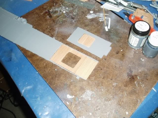

The illustration below will show my progress on the decking. I started from the back, thinking that would be easier than the front, where the catapults "intrude" into the wooden deck. But...putting in the elevator well was quite challenging. You can see that I have chosen to retain a "rim" of steel around the deck, and outside of those will be the plastic gun tubs and catwalks of the kit. The elevator itself was made from a "spare" section of a plank that I used for a deck section. There are two sections pictured (each Enterprise deck plank is 2 1/2 inches "long")
OK, I busted two planks (VERY expensive to create, and precious little to spare) already—they are thin and FRAGILE. The first attempt to put an elevator "well" in the plank had me sawing a rough smaller square, then trying to work my way to the outside to make the elevator-sized hole. WHACK! Busted the piece. Next, I thought of drilling four holes for the rounded "corners" of the elevator well. Good idea. Bad execution. I figured a small "pilot hole" would be good to get started, then ream out the small hole with the larger drill that "fit" the rounded corners. WHACK! Busted the piece. (That's when I decided to work on an SBD for awhile!!) When I came back, I just decided to drill the "large" holes for the corners of the elevator well without pilot holes. Worked FINE!! Now I had to saw out the space between the drill holes and finish off the shape with files. WHACK! Busted the piece, but was able to glue it back and re-inforce it to finally have the elevator well finished. WHEW!! I *THINK* that will be the hardest part until I get to the catapults up front. Plenty of time between now and then to strategize.
The small "round down" at the rear of the deck went all the way across in mid-1942 (the Revell kit is a curious mixture of time frames) and will be replicated by either a quarter of a drinking straw, or metal tube.
#27
If that planking is as thin and fragile as it looks, then I wouldn't attempt to saw it: I'd put it on a flat surface and cut it by applying a sharp chisel, or chisel-shaped craft knife blade, vertically. Going across the grain, I'd do it directly on the line. Going with the grain, I'd first cross-cut the ends of the intended cut (so it doesn't run to the edge) and then cut it a bit short of the line in case it doesn't run straight. Then finish off with a file.
#28
>If that planking is as thin and fragile as it looks, then I wouldn't attempt to saw it:<
The planking is roughly 3-7mm thick, and pretty firm wood. I don't think a chisel would be able to cut it. It will split on the grain lines if too much torque or pressure is put on it. The places it broke were the narrow section between the elevator well and the outside edge. Much of it is just careful technique. My saw is a rotary, about a 1/2 inch diameter, on a Dremel. I have cut several pieces quite successfully.  The planking part is easy--it was trying to make a hole that was difficult. I have passed that hurdle now, so the rest should be relatively smooth sailing until the bow, and I have a new strategy for that, too!
But thanks for the concern and tips.

Actually, there are several raised "panel lines" on the wing that are TOO raised. On my next SBD's I will actually have to sand them down a bit.
>With a bunch of 1/700 aircraft needing modelling for one of my projects I'm awe-struck, hope I can do even half as well.<
The 1/500 planes are about half again the size of the 1/700, but if you're CAREFUL... :rolleyes: But thanks.

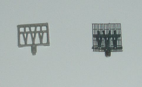

However, the main CXAM radar and the AA fire-control director were my dad's concern aboard the ship, so I wanted to put some effort into those things. Shown is the CXAM atop USS Ranger (now why do you suppose I picked THAT ship? ;D )
The clunky kit radar had a thick frame and "A" supports (photo below left). My research indicates that these "A" supports were there, all right, but decidedly thin and spindly. At 1/4" tall there is not much one can do to thin this plastic. I happened to have a freebie 1/700 PE set for "HMS Sheffield" (have no idea which one) that had multiple railings close together and reasonably approximated the look of the CXAM radar's grid. I found that the railings split apart readily (and altered the "grid" spacing), so I left the PE "frame" around the railings until AFTER I had super-glued the desired piece onto the altered kit radar frame. I had shaved down the kit frame to make it thinner front-to-back, and trimmed three of the four edges, so that only the "A" supports and the bottom were left. This would give good support for the flimsy PE. The radar grid slopped over the bottom frame in my research pictures (above), so I did for the kit radar, too. Though I don't have any front-view diagrams, indications are that the CXAM was NOT longer in the horizontal dimension as depicted by the kit radar, but either perfectly "square", or slightly elongated in the vertical dimension. I think I got close (certainly closer than the kit radar!), and that's what I wanted.
The "bow and arrow" antenna above the CXAM is a "YE" homing device, also used on the Enterprise in the Midway time frame. I am trying to somehow replicate THAT, too, but have come up empty so far.
