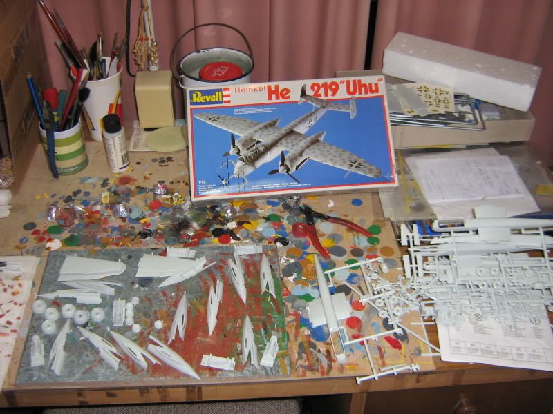

Allan
This is the project I've been thinking about for quite some time now. And things are ready to commence. Lenthening the fuselage--what I might do is cut numerous pieces of plastic card into oval shapes and then glue them together to form a sort of plug to place between the cut sections of the fuselage. Cockpit detail will have to wait until the plastic surgery is complete.

Allan
Thanks for that, Ed. It's useful info. I have three complete UHU kits to cannibalize, so one option is to cut a piece from another fus and insert it into the gap with stringers to made sure everything is firmly in place.
Playing with numbers for a moment, the span of the real UHU is 18.5 meters and the length 15.54 meters, which produces a ratio of 100:84, let's say 85.
So, once the wings have been made all I need do is lengthen the fus to maintain this ratio.

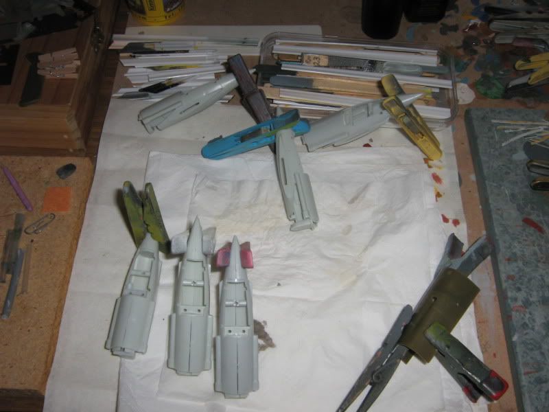

Allan
All engines will be side-by-side, Tophe. Have started work on them already.
