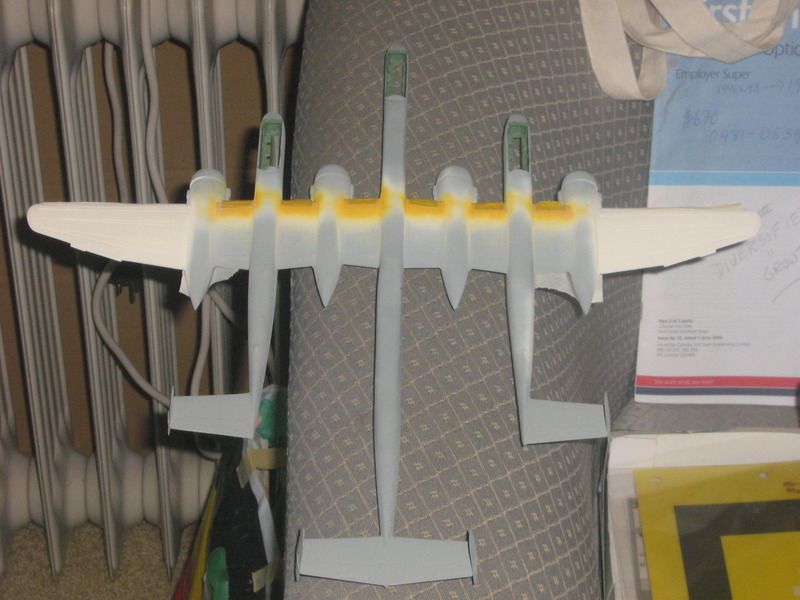

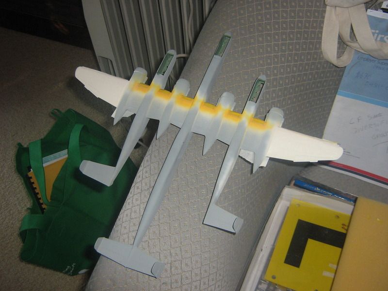

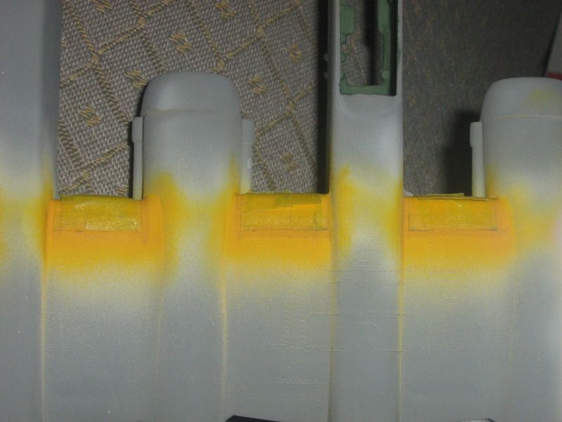

Ray, you've kickstarted me into action and I've being doing some masking of the yellow leading edges...it's a two night job and will be finished tomorrow I think...then perhaps mask the wheel wells and slap on a coat of light grey or something on the undersides before deciding what to do with the upper surfaces and the cockpits
Allan
Allan

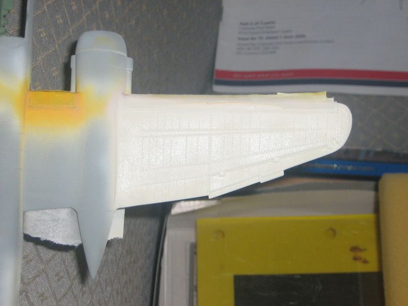

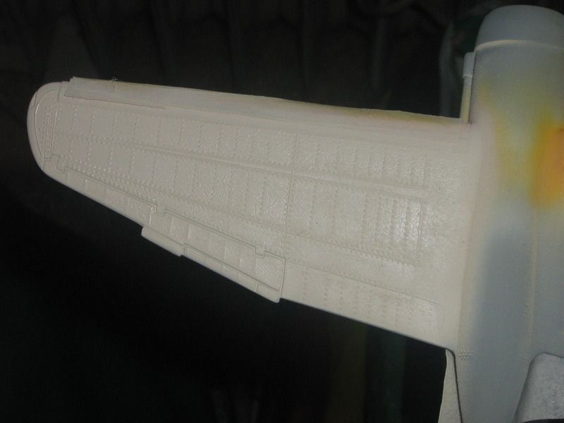

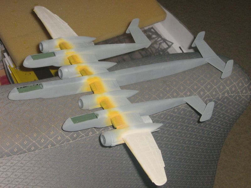

masking of the yellow is now complete, piccies later, and so I can now anoint the plane with some white on the outer reaches of the wings and some palish green--Humbrol matt 120 if you're about to head of the shop--on the lower surfaces, but before doing that I'm going to dry bush some of the yellow onto the edges of the tape to prevent paint bleed
Allan

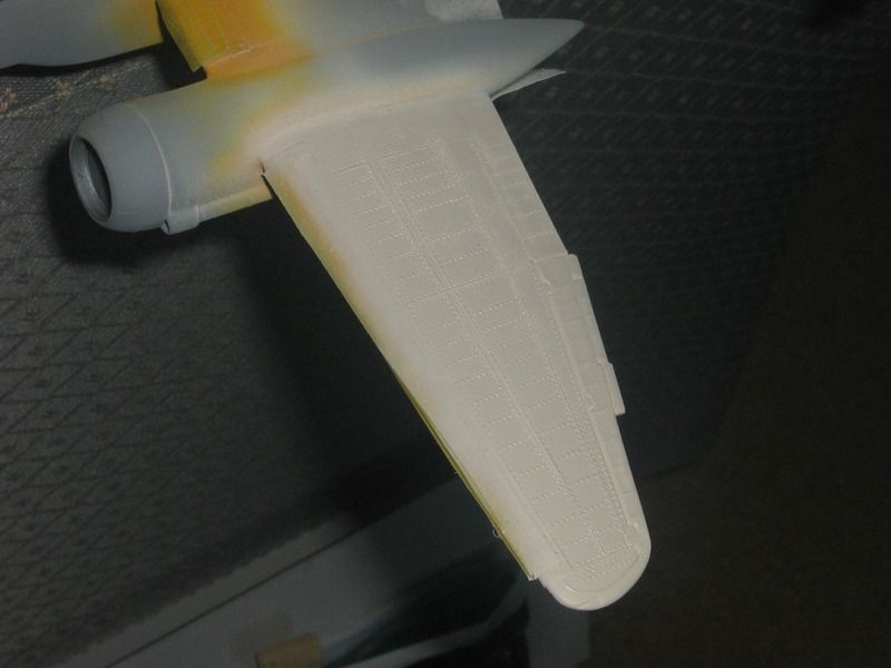

I really should be working on the cockpits and canopies, but decided to do a little spraying of the white on which I will place rising sun decals, wings only....these piccies also show the wing masking....I dabbed on some yellow against the tape to block off the white and greens that will come later

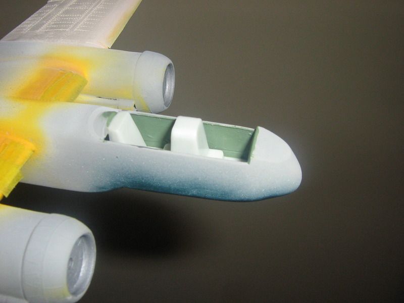

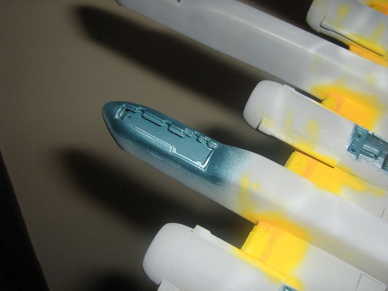

thanks fellows....more progress to report: I cemented in the two outer seats just to give the model floors to cement the undercarriage onto later....I'll whiteglue some small fishing weights to the seats of these cockpits to give the model a little more weight to avoid tailsitting and then cement the canopies....they'll be just painted over.. undercarriage: do you think all three should be attached or can I get by with no undercarriage on the middle fuselage section only?
