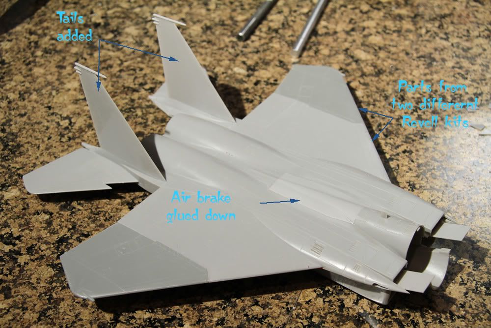

Made some more progress this week. Like her Greek sister, she is build from two of same kits but I got them at two different times. That why the wings are two different shades of gray. I also glued down the air brake and place the tails.

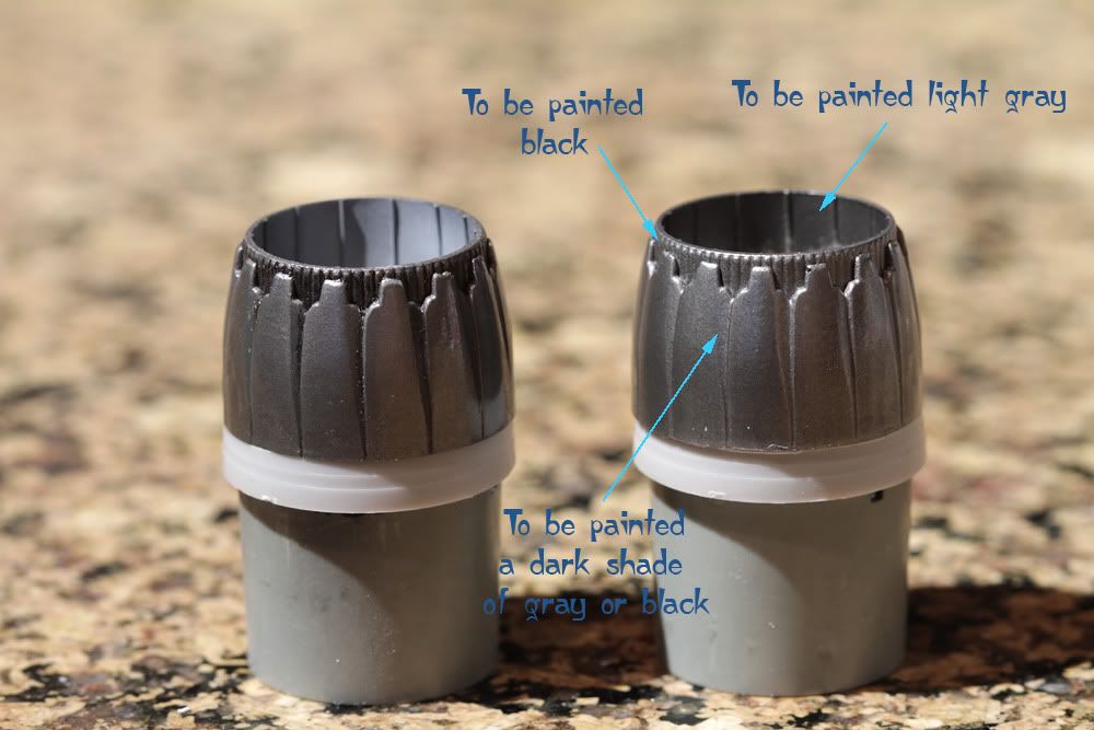

Started painting the nozzles. First I shot them with Model Master Titanium buffing metalizer and sealed it with coat of future. Than I mask off the the pettled and shot them either gunship gray or black. Don't want them too dark. I shot the one on the left gunship gray.  Next up black on the tip of the nozzle. For the ceramic coating on the inside of the nozzle, I used light gray. I hate shooting white paint. >:(

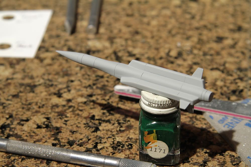

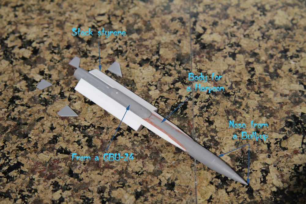

I also started on my idea of the XASM-3, the ASM-4.:wacko:  The body is from a Harpoon with the head of a Bullpup. The sides are just stock styrene. It still has a bit more work to be done to it.

For the ceramic white inside modern jet nozzles, its not a pure white anyway - more of an ivory.  I like to use "bleached bone" from the Citadel range over a white primer base coat.  It all gets weathered & washed anyway.

I think its too cool not to try to build one. But after searching online, I just could not find enough info to make a accurate copy. So I just based mine on it. Area that would be too hard to make or areas where I could not figure out what was going on there, I changed or just made it simpler. I have been working more on it this week than anything else. Thanks for the heads up on the ceramic coloring. :thumbsup:

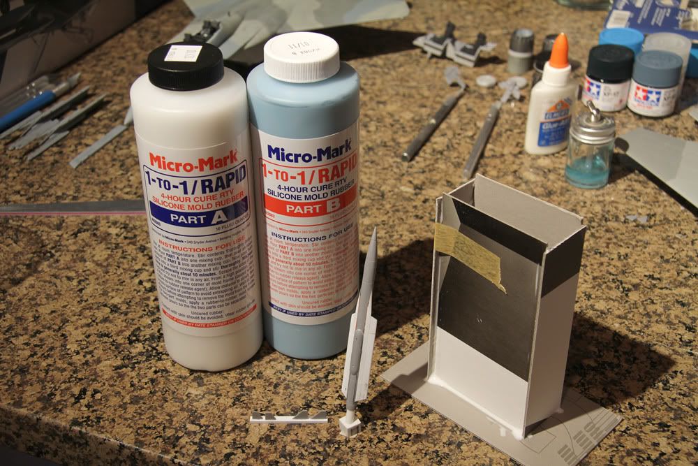

Can you guess what I'll be doing in 4 hours!

Well after four hours I got good news and bad news. First the good news, the mold of my ASM-4 is really good  -_-. The RTV does a good job pick up all the details. Now the bad news.... my resin sucks :angry:. It's too old (over 2 years) and it cures sticky. So, I order a new batch from Mirco-Mark and it should be here late next week. Hopefully this time next weekend I will have some resin ASM-4's.

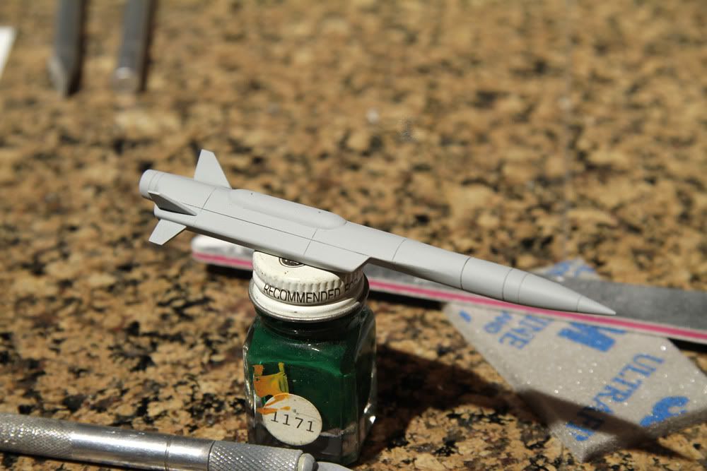

Well she only took about a week to make but here my ASM-4. :wub:  Can't wait for my resin to get here so I can make a few copies.
