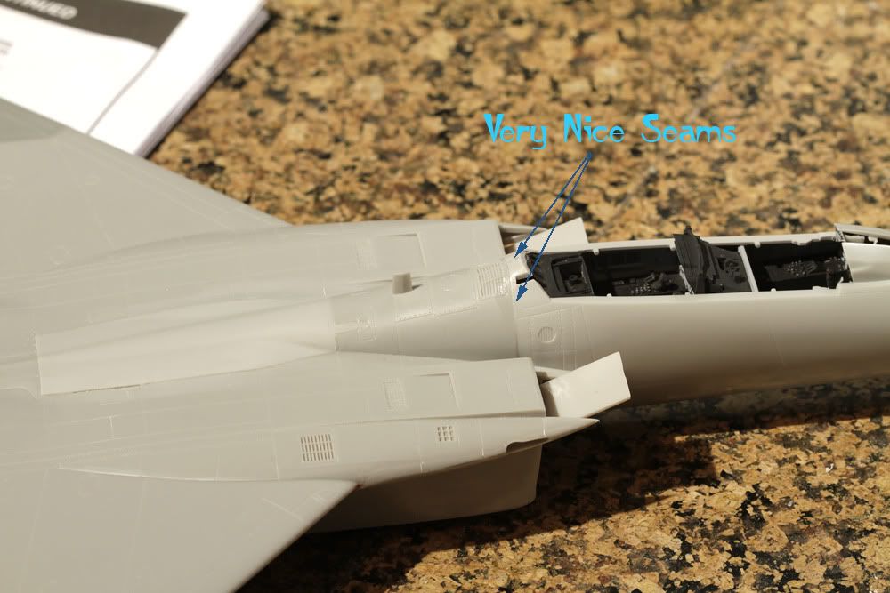

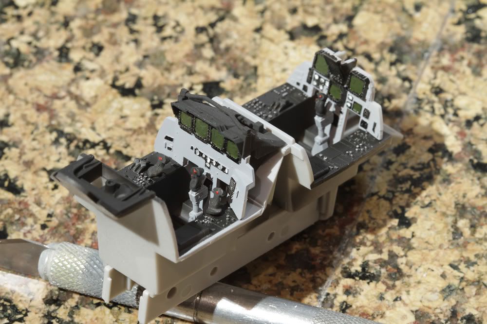

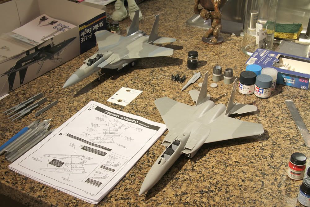

Here's a small progress report. Got her front office done and painted. Seats are put together and got a base coat but still needs alittle more loving before I put them in the tub.

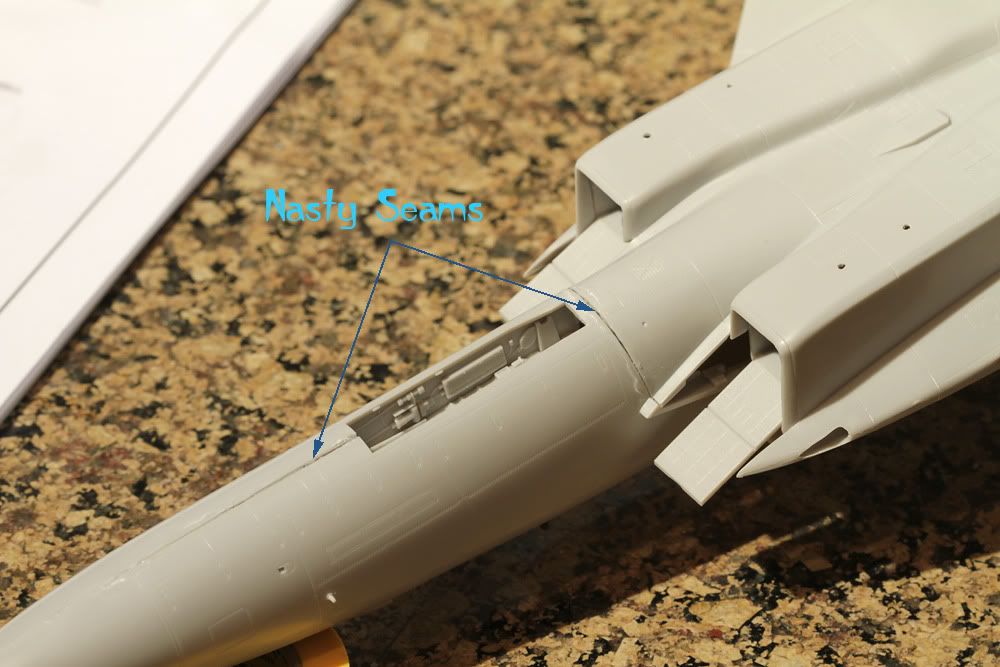

When I glued the two front fuselage halves together, I found I had a seam problem. I could hide the seam on the top or on the bottom of the fuselage. I chose to hide it on the bottom, it's easier to hide there.
Here are those nasty seams. >:( I just filled them with some gel super glue. Later I will sand it smooth and rescribe any lost panel lines.
My Mudhens are coming along nicely. :wub:

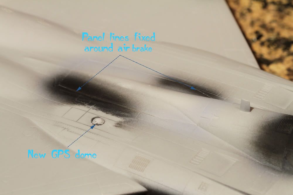

Had to fix up some seam around the air brake. You can see the areas where I have shot spot primer. Here's one of many little different details. The newer Mudhens has a GPS dome beside the air brake. I used a the clear lense cover from an AGM-65 from revell A-10 kit.

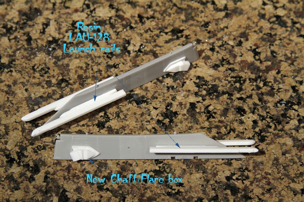

Here you can see I added some home made resin goodies to the underwing stations. The LAU-128 launch rails are resin copies of Academy's F-15K. And the chaff/flare boxes are copies of True Details USAF Pylons for F-4 Phantom II(really great set, you get a whole set of resin hardpoints and chaff/flare boxes for under $4 buck Plus it's an Ex-KMC mold!) :thumbsup:

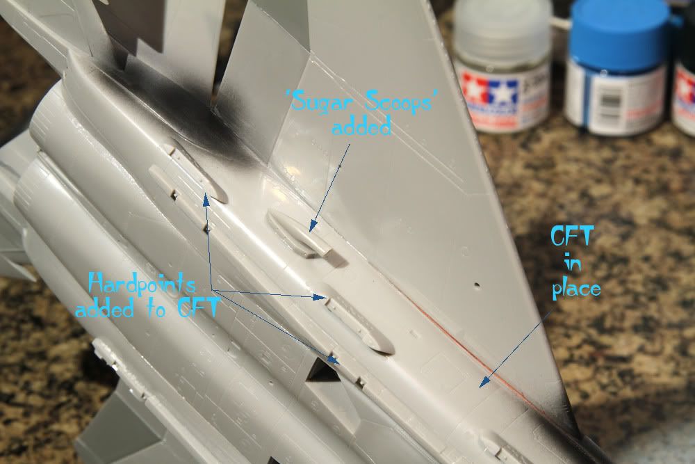

Moving the build forward, I manage to get her CFT's in place along with the hardpoints. Another little different detail, I added the "Sugar scoop" intake. They are cooling scoops for the newer engine.

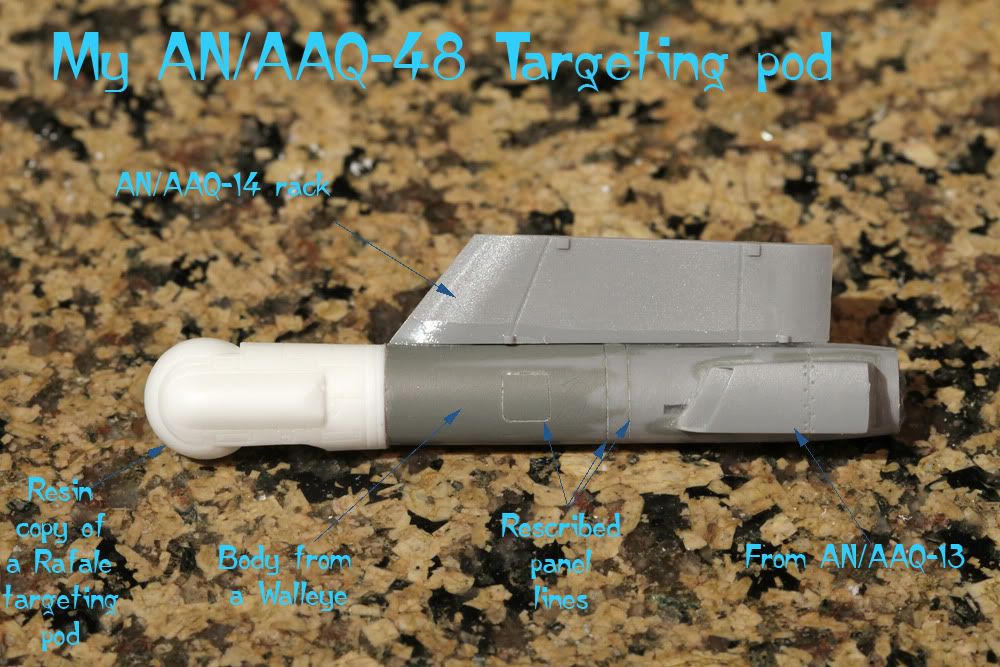

I wanted to put a Sniper pod on my JASDF mudhen but I'm cheap and not going to pay for something I can make. Not trying to make a Sniper pod just something different. Here's my AN/AAQ-48 targeting pod. It started life as a data pod like an AN/AXQ-14 for the AGM-148 on my Hellenic mudhen. The body is a AGM-62 Walleye from Hasagawa weapon set B. The side vent thingy is from a AN/AAQ-13 LANTIRN pod(Hasagawa weapon set D). The rack is also from Hasagawa weapon set D. And to be different it is upside down. ;D The head of the pod was a problem. It is from the targeting pod from Revell Rafale M, which I used on my IAF A-10I. Before I move to SoCal I bought another Rafale. So I went into my stash looking for the targeting pod. If I find it, I will make a mold of it so I can cast some resin copies. But the Rafale kit I have now is the B, the Air Force two seat without the pod. So, I stole the targeting head from my Sandhawg for 4 hours. Made a mold and cast a resin copy. Super glued the new head to the body, rescribe a few lines and TA-DA!
Until next time,
Steven L   :ph34r:

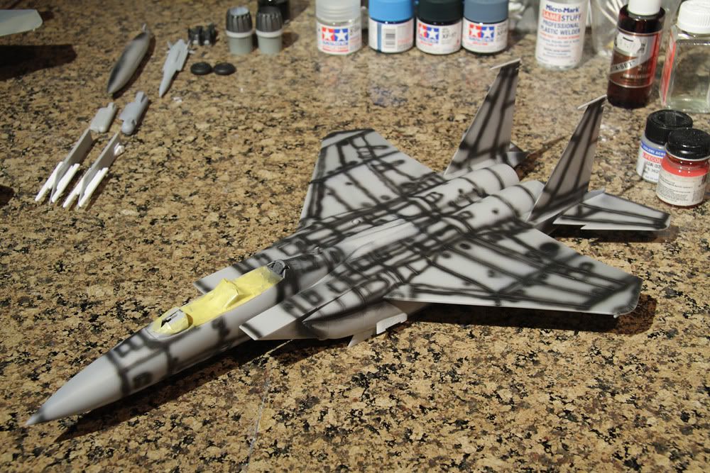

Preshading has started!
Until later,
Steven L  :ph34r:

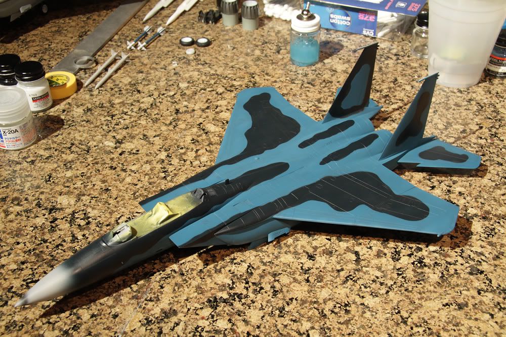

Well... Been up since 7am working on her....now she's BLUE! :wub:
In the photo, the darker blue looks darker than it actually is and close enough for me. Got some touch ups I got to do but now I'm beat.
Stilll....more to come,
Steven L   :cheers:
