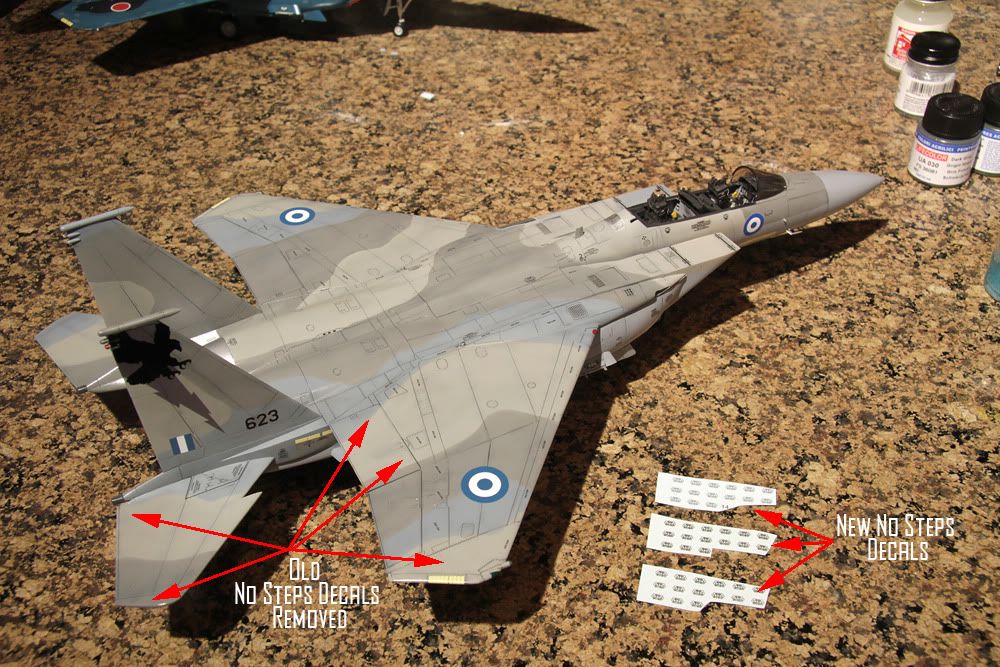

FAR148
Well the No Steps decals on the Greek Mudhen did not dry properly. :angry:  I tried lightly poke around the decal with a sharp no#11 blade then hit them with Microsol and set but it did not work or help. So with a wet Q-tip and a new no#11 blade, I removed the decals. They lifted off easily. I shot a fresh coat of Future where the old decals were and will try again tomorrow.
Until later,
Steven L  :ph34r:

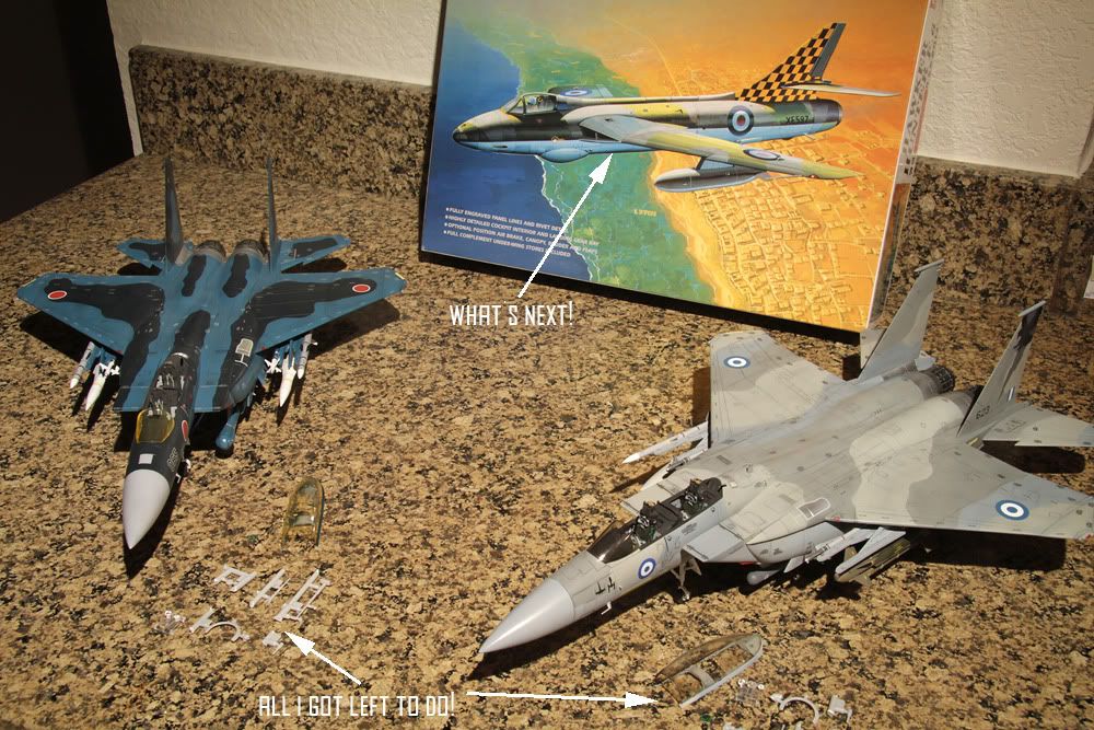

My two Hot Chicks turned into Bad Girls! As of now both Mudhens are armed and got a few more bits to be added. This will be the last of the progress reports, next you see them they should be finished!
Soon! Real Soon!
Steven L   :ph34r:

The carpet monster took it!
Oooh, a Hunter!  :wub: Can't wait to see what magic you'll work on that one! :o
Nearly done, both looking lovely.  Looking forward to that Hunter... :wub:
Both so stunning, I cannot wait for the finished pics 8)
FAR148
Thanks guy! :thumbsup:
As for Hunter plans...
Steven L
