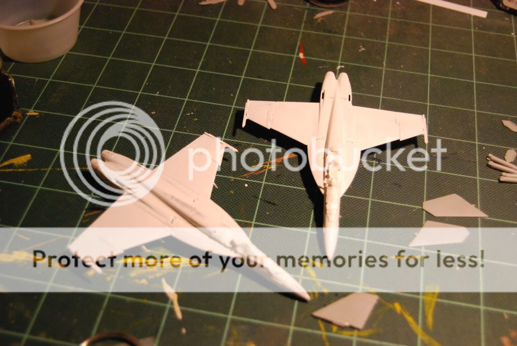

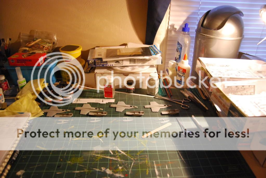

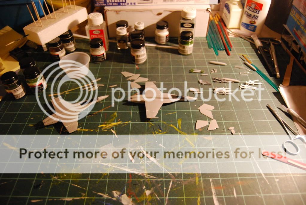

Overall shot of the bench with all 4 main body parts laid out.
Close up on the parts of an Echo.

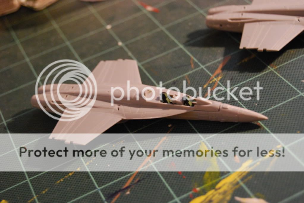

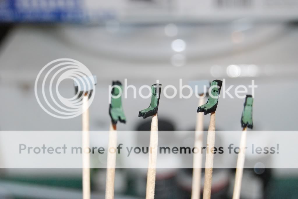

Cockpits painted.  Instrument panels are provided as well but be warned.  If you glue them in place without first dry fitting the cockpit assembly you'll have a mess of problems.  They don't line up worth anything.  DML could have been a little clearer in how to align the parts instead of leaving it up to guess work.  The cockpit is so small in the end though that you won't miss them if you leave them off entirely.
Ejection seats painted; cleaned up later.

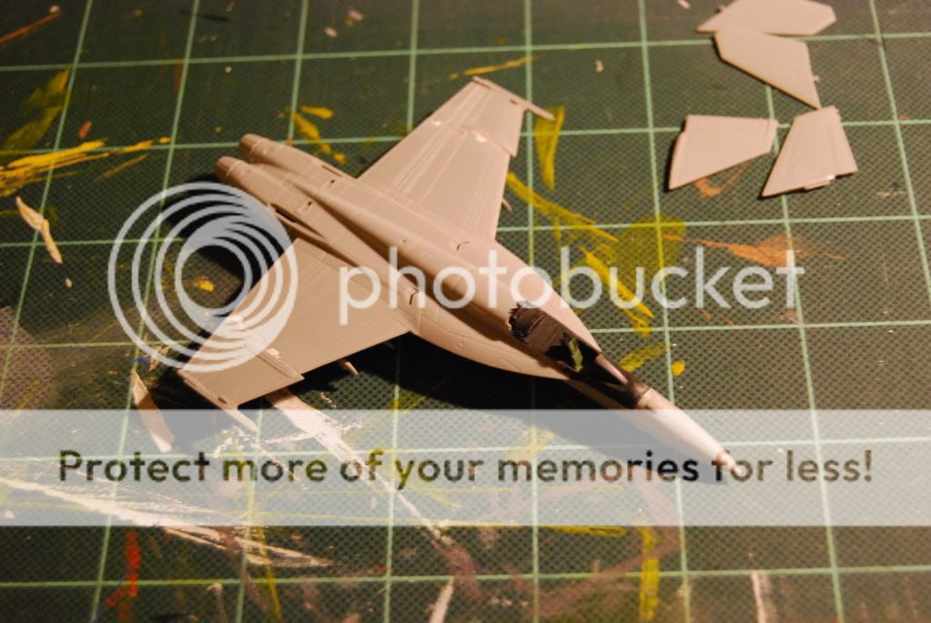

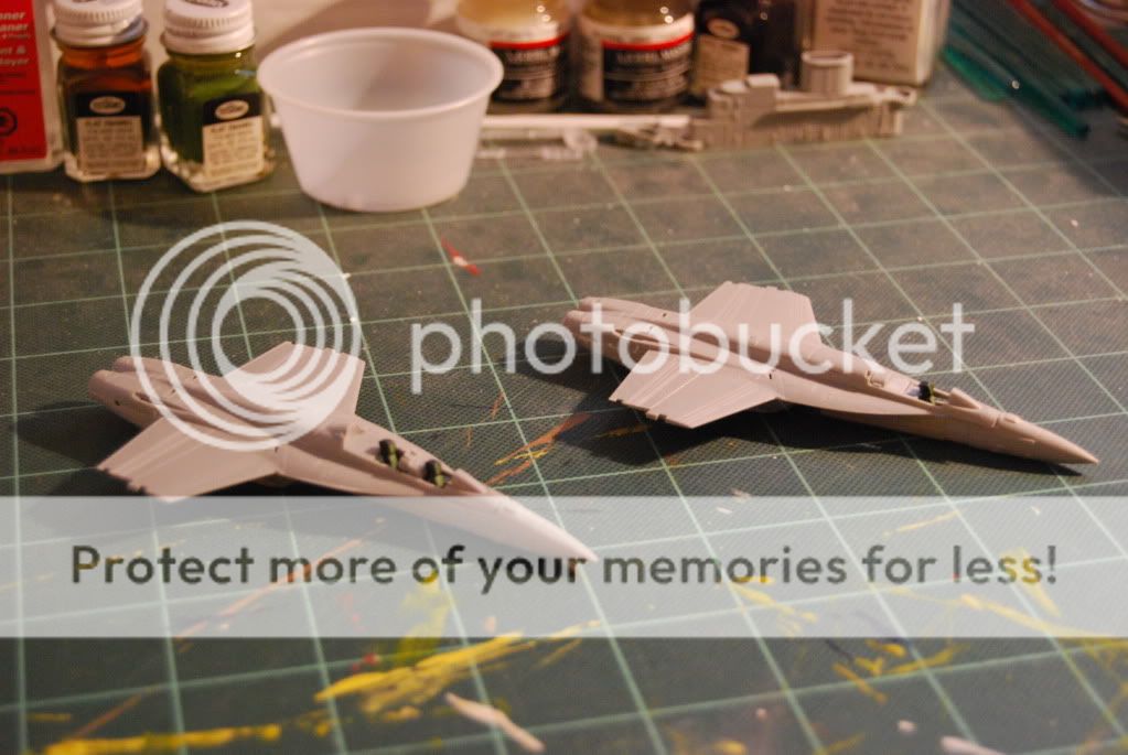

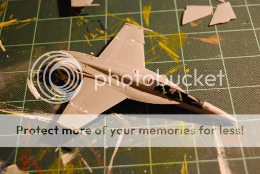

Bodies done with dry fitted nose sections.

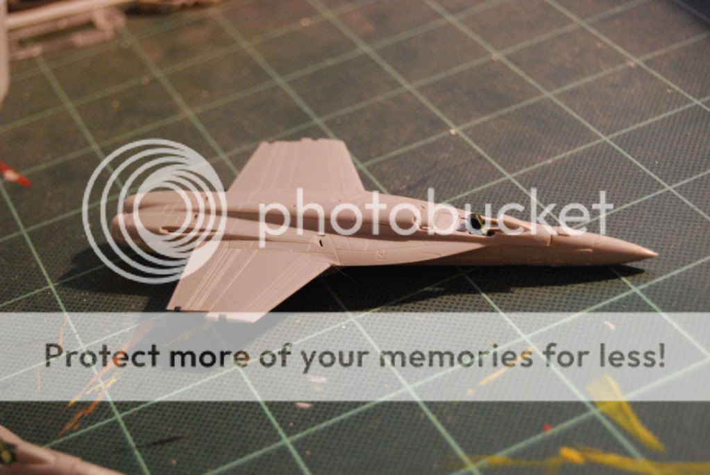

Close up on the Echo
Close up on the Foxtrot

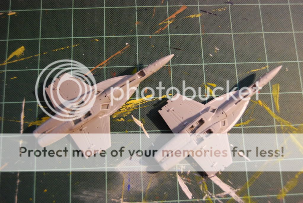

Close up on the bottoms showing the amount of filler needed.
Overall I'd say these are pretty good kits.  You just need to dry fit often!  A lot of parts needed sanding/reshaping just to get them to fit where they were supposed to.  After looking at reviews of the larger scale kits I wouldn't be surprised if DML somehow got their hands on some 1/72 Hasegawa molds and scaled them down.  A lot of parts and assembly methods are almost exactly the same.

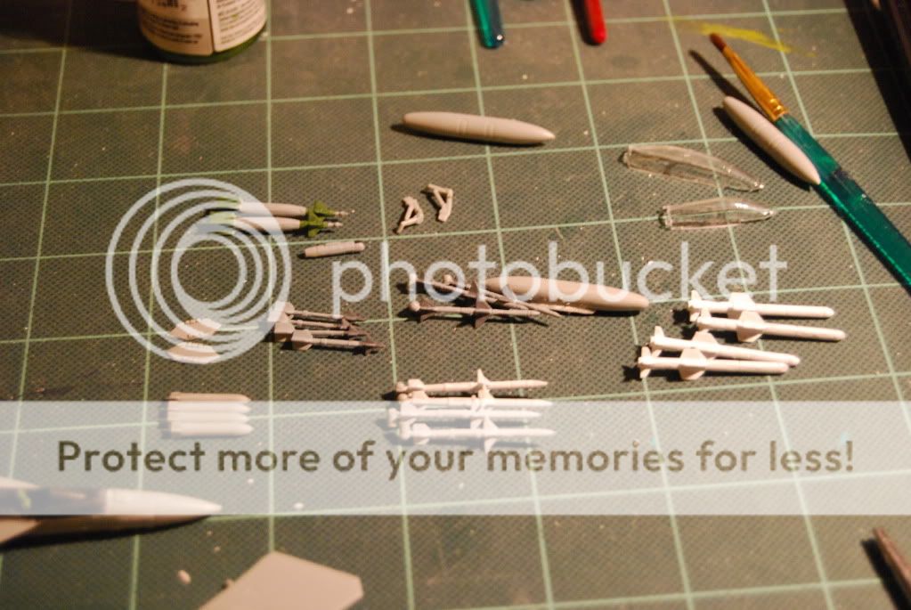

Close up on the ordnance stack.
Currently we have:
4 AIM-9Ms (Swiped from a DML Tomcat kit)
3 AIM-7Ps (Bent the thin arse AMRAAMs all to heck and back so they're in the trash)
4 AGM-88Cs
4 AGM-84Ds
4 GBU-10s (2000 pounders)
4 Mk-20 Rockeyes (Swiped from a DML Intruder kit) for the two twin bomb cradles above them.
1 Lantirn Pod for the GBUs
2 Center line drop tanks
1 Spare drop tank

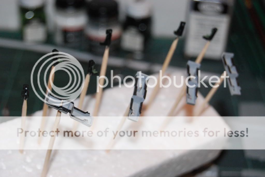

Some main gear parts and the canopies too.  I see some Future baths in their futures (and yes the pun WAS intended  ;D)

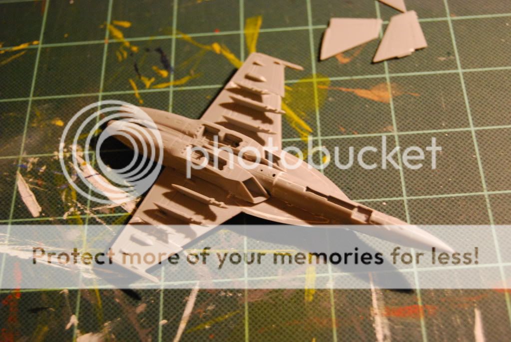

Underside of Echo with hard points installed.
I elected to leave off the horizontal and vertical tails for to make the decals easier.  The fit of the tails is actually very snug so no putty will be needed allowing for a post paint install.  Left off the hard points on the Foxtrot since she'll be getting the wrap around scheme and the Echo won't.  That will make painting much easier.

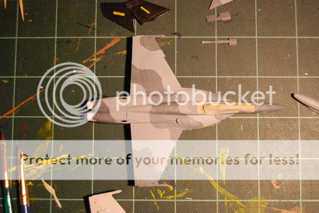

I found that the airbrush was useful in laying down the base colors but the camo patterns are better done by hand by a small brush.  They're just too darn small in the scale to try and do complex wavy masking and get it to look right.  Masking sharp angles is easy enough but trying to cut smooth curves.....my eyes still ache and I'm only 23!
Primer is Testor's rattle can Flat white.  I found after much deliberation that MM Light Ghost Gray and F-15 Dark Gray matches the RAN scheme pretty well.  I know its not 100% correct but its close enough for my liking.  All the RAN bug needs now is its black hood and she'll be ready for final assembly and decaling.  I'm not sure if the SEA scheme is gonna happen in time for the contest seeing how tomorrow is my last day to work on them.  I'll try but the RAN bug is taking priority at the moment.  Will have to wait and see what time I have left.  If not I'll finish it up on Sunday.  Wish me luck!

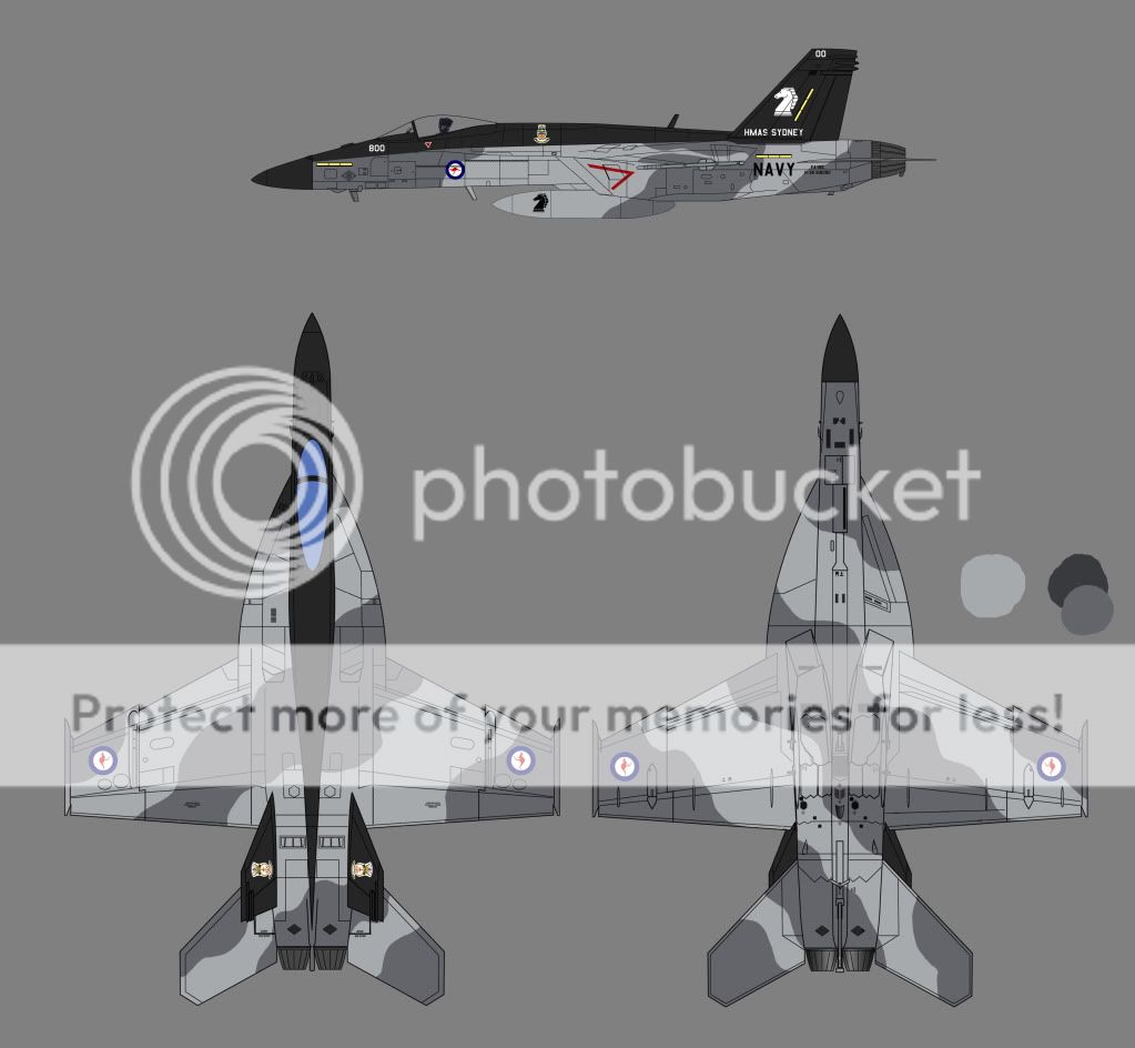

11th Hour contingency plan in effect for the contest!  The SEA camo did not happen, I'll finish up the Kiwi bug later.  The bug going into the show will look like the RAN bug in the profile I drew up but it will be sporting USN markings since that's all I have.  I didn't want to have to do this but its all I can do at the moment.  Don't have anymore decal paper or time to make new ones so stock decals from from another DML kit will have to suffice for the contest.  Yeah I could wait and not enter anything but I want to enter so I am going to!  I'll be remaking the RAN bug so don't worry.  I still have 4 more "micro" bugs waiting for assembly.
It seems that this particular Super Bug will be sporting a temporary/experimental camo scheme and be assigned to the USN.  Which squadron I'm not exactly sure just yet.  Will probably wind up being VF-31 since I have an abundance of their decals in this scale.  It should still look rather neat and will still be a whiff albeit not the one I wanted to make but oh well.  Live and learn.  I definitely won't make the same mistakes on the next ones.  I'll post up some shots later on.  She'll still be loaded down with ordnance though.  Something about a clean combat aircraft that just doesn't look right  ;D

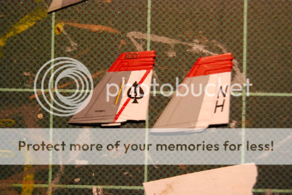

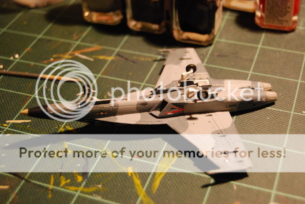

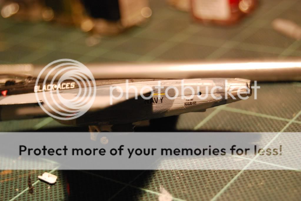

Alright gents, here's some shots of the RAN turned USN Superbug currently around 80% complete.  All it needs is the hard points, ordnance, and tails glued on but it's going to take a backseat for a week or so while I finish up a group build entry.

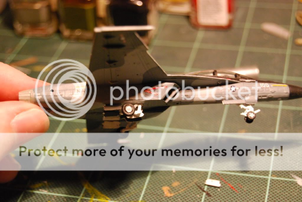

Wound up using the decals for VFA-41 included in the kit and reworked the tail to a more retro design.  All white, gray, and red is masked and painted.  Only decals are the spade, modex number,slime light, and USS Nimitz.  I like it, thoughts?
Here's some overall and closeup shots of the bug.
In retrospect, I think from now on I will build these little 1/144 DML kits as flying dios and leave the gear off.  All the problems started once I tried to cut the gear doors and glue them on.  The gear gave me the most problems with these bugs.  Kudos to DML for making them so detailed but that also made too delicate in areas.  I snapped the Cat attachment bar on 3 of the 4 nose gears before I even got them off the sprues.  It was nice of them to include 2 spares but the sprue attachment points are numerous and poorly placed.  I don't know how many parts I ruined just trying to get them off the sprues thanks to those little tabs being everywhere  :banghead:  They can cast Harpoons with one attachment point at the rocket motor yet the AAMs have 7 points! SEVEN!!!  and they are 1.5mm wide!!!!!!!!   :banghead: :banghead: :banghead: :banghead: :banghead: :banghead: :banghead: :banghead:
