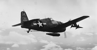

I assume you mean this picture?
Interesting.  However, the rest of the blog is fascinating!
Quote from: rickshaw on April 26, 2010, 01:28:40 AM
I suspect you've posted that on the wrong thread.......
OOps, you're right.  My bad.  :(
