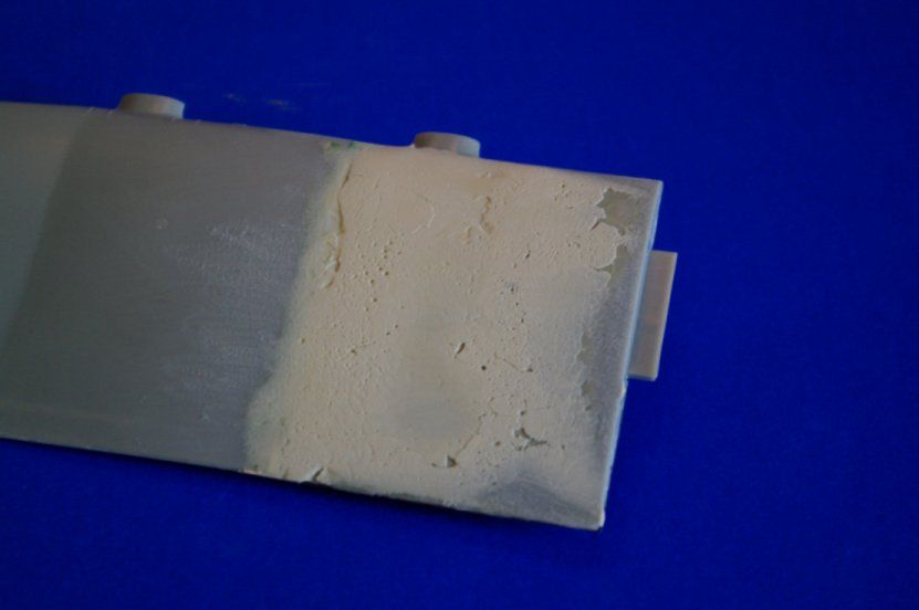

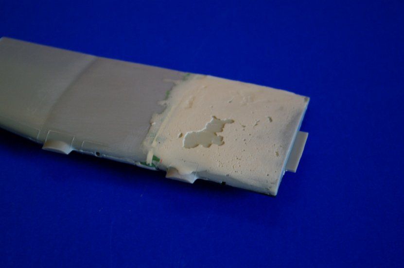

I was getting a little fed up with the length of time it was taking to do the PSR on the wings so I broke out my Draper 230V 100W Tri-Palm Sander! This worked as well as I could have spent days getting to where I am after only a few minutes!
A down side was that some pieces of filler came off!  :banghead: The problem I believe the problem is similar to what can happen to plastering a wall. The areas that have come away or are cracked have probably not been keyed to the underlying plastic thus allowing the filler to lift just like loose plaster on a wall.
At least its progress!
So this is the result of my little sanding session
Rather a mess.  :blink:  The good thing though is that the majority of the filler is now sanded to its final or near final depth.
Liquid Polly, not a Monty Python sketch, will be applied in copious amounts to ensure the plastic is tacky before the filler is applied, thus keying the surface for the filler to adhere to.
I had a similar experience with a tube of that Revell plastic putty, it had been opened and was about half used when I went to use it and the putty looked a bit 'dry' when I applied it but seemed to be ok --- until I sanded it --- then it came off just like that.  A new un-opened tube I used next didn't have any problem when I went to replace what had come off the first time.  Since then though, I tend to use putty sparingly, making up big differences by using styrene card first.
Looks like a bit of a PIA, but as you said it's almost at the correct depth now so the rest should be easy.

I can now say that the method I thought of and mentioned above was successful  :party:  :cheers:
I have sanded flush the filler I had applied in small areas prepared with Liquid Polly and it worked! There are still a few areas that require holes filled and the like but I can see the light at the end of the proverbial tunnel!
