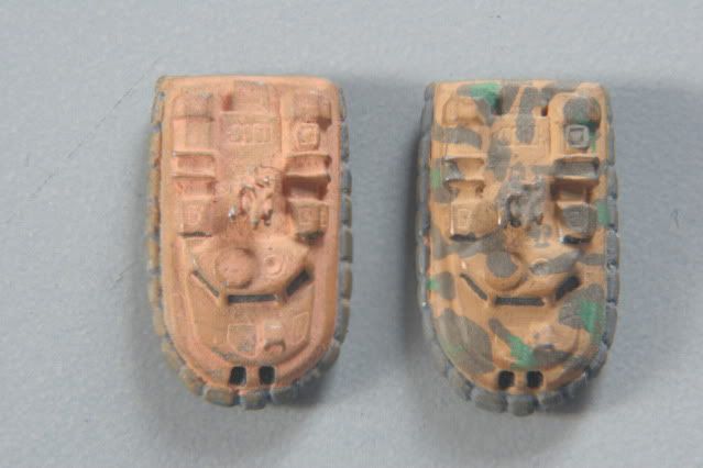

I've got a little 1/300th scale GEV (hover tank) painted in Humbrol Flesh with sand drybrushed over it. I'll photograph it properly tomorrow and post it up.
Thanks Harold!  I know nev mentioned  Humbrol flesh before, I had a try & thought it looked a little 'David Dickinson', but I'd like to see how it looks toned down.
#53
Here you go:
The one on the left is painted with Humbrol Flesh with a drybrush of (I think) Sand. For comparison, the light colour in the one on the right is pure Sand. Sorry to be a bit vague, but it's 20+ years since I painted these things. Bear in mind also that they're VERY small: about an inch long. Photographed in natural daylight (grey overcast) without flash.

Thanks for posting those pics Harold!  Flesh with sand is a very interesting combo, might have to think about that for other builds.

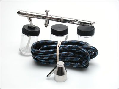

Srdjan, the feed still comes from the bottom of the cup (if it took from the top you'd soon run out of paint! ;))
I pulled this pic of the Badger 155 Anthem off the net.  The paint cup is upside down, but it shows how the feed connects to the bottom.  The airbrush is mounted to a paint jar (I used to use this but cracked the lid  :banghead:) & you can see the feed.
I've read that top feed airbrushes allow you to slow down a bit as you can use lower pressure due to the extra assistance gravity gives you, bottom feeds give you more flexibility, allowing you to add a paint jar for greater volume of paint.

Oh yes, now I see - from this picture it's obvious that airbrush picks up colour from the bottom of the cup, like gravity feed does too..
Anyway, you can definitely try with mixing colour in some jar rather than in airbrush cup ;)
And it's true that gravity feed airbrushes can work with much lower pressure - with Aztek airbrush that had ... uhm.. semigravity feed (?) (cup was connected on right/left side of airbrush) I used to do with pressure of 1-1.5bar, while with Evolution I usually work with 0.5bar or less, very rarely I put the pressure up to the 1 bar!
