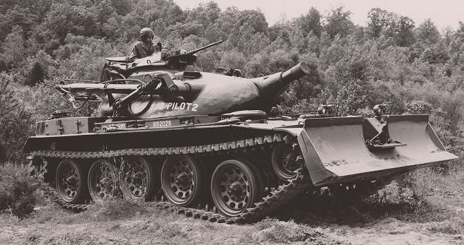

The T54/55 is cramped, particularly for the loader, no doubt about it.  However, that could be remedied if you used an M48 Turret (Personally, I've always preferred the M47 Turret over the M48's because I feel it has a better ballistic shape but that is another story).  Interestingly, the US Army's T95 experimental tank essentially combined (in one of its test variants) a low hull, like a T55's with an M48 Turret.  They were intending to use an oscillating turret (like the AMX13's) originally but realised the sealing problem would prevent its use on a NBC battlefield so they went looking for alternatives.
That might be closer to your ideal.   They tested several turrets on that hull BTW.
They even got as far as building a CEV version - the T118:
You'll note that in order to accommodate the M48 turret, they essentially created a turret ring "riser" on the hull, to bring it up higher to allow the loader to stand.  In the T54/55, the loader kneels/crouches and there is no turret basket, so he is forced to shuffle around when the turret traverses.  The US T95, like the M48, had a turret basket.
The T96 mounted a 105mm gun, instead of the M48's 90mm.

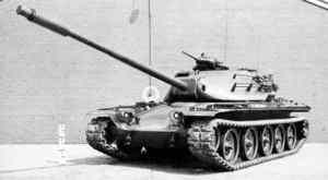

You're right, it is closer to my ideal.  :thumbsup:
This one is even closer, the turret ring riser being made less obvious.  The M48 turret didn't look too bad in this case, and I'd say that a picture can be more reliable than a line drawing......
Thanks for pointing me to the T95.
