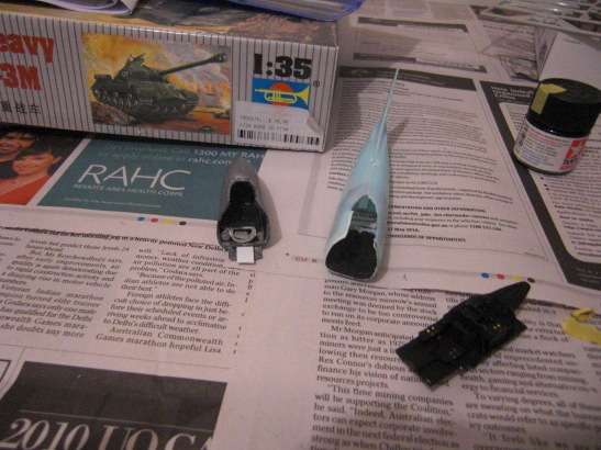

First the front and rear "office".  I apologise for the poor quality of the photo.   Anyway, what I did was take advantage of the fuselage being in two halves and created a cockpit interior which I could slide in, before I joined the two fuselage halves.  I created some side consoles and for the rear cockpit a radar screen.
Here are the two cavities which the cockpits will fill.  You can see the remains of the F-86E intake tube.  Interestingly, if you look at how Airfix did their original intake on the F-86D kit, basically it curves up and into the cockpit, rather than going under it as in every other version of the F-86.   :o

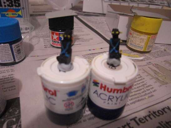

I then painted the seats.  I'll add them towards the end, through the top of the cockpit simply because its easier and it will protect them from any knocks that might happen along the way with sanding, etc.  I added some pull rings to their tops and painted their straps.  They're Aeroclub seats BTW.

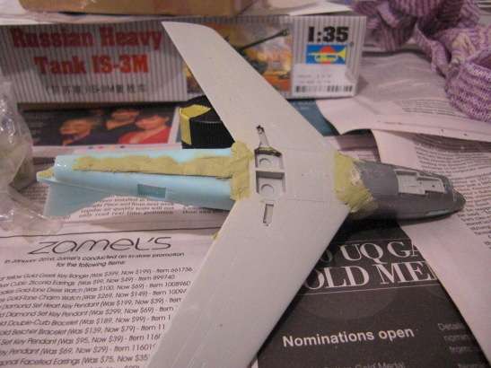

Here is the two fuselage halves assembled with the cockpit fairing and the wings attached and the cockpit, sans seats inside.   I added some pieces of plasticard under the rocket tray to bring the rear fuselage up to the right height and to provide some foundation when I'm sanding it down to fair the front fuselage into the rear one.
You'll note I've cut the gun troughs off the CA27 and stuck them onto the nose of the Sea Dingo.  They aren't in the same position as on Chris's excellent profile.  I thought it would be too hard to put them there without a lot of major surgery.
