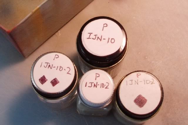

I carefully label the bottles for quick identification. I have some white "Avery" (U.S. manufacturer) stick-on round labels that I put on the top of EACH and EVERY paint bottle. I put a letter at the top of the label indicating the brand. "P" for "Pactra", "F" for "Floquil", "T" for Testors, etc. so I know what thinners to use ("Floquil" being a lacquer, for instance). I use almost exclusively enamel or lacquers, not acrylics, but have acrylics labeled with a parenthetic "A".
I "name" the paint with a unique name for the paint (sometimes even the name on the bottle, especially for elementary colors). F'rinstance, I have both an "RLM Gray", and an "RLMM Gray", which are different.  My "Decimator Blue" blue-gray is slightly different from my "F4F" blue-gray. If I modify a color, I give it a different name. I have "IJN-10" and "IJN-10-2" from a recent project. All that is needed is another Avery label slapped on top of the old one.
Then, the thinned airbrushable paint is given an additional mark. In my case, a black diamond below the name. Extra-thin paint (like washes or mist paints) has TWO black diamonds.
