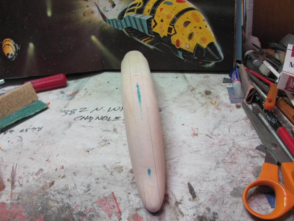

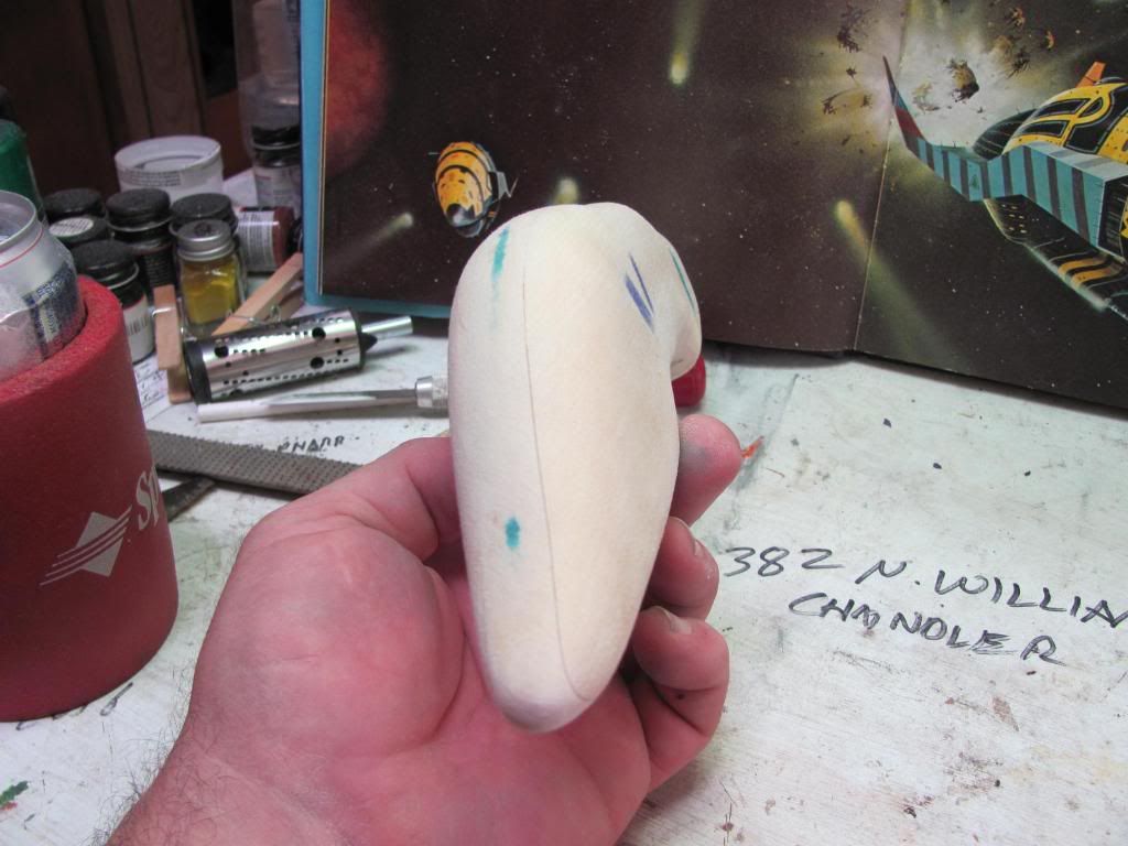

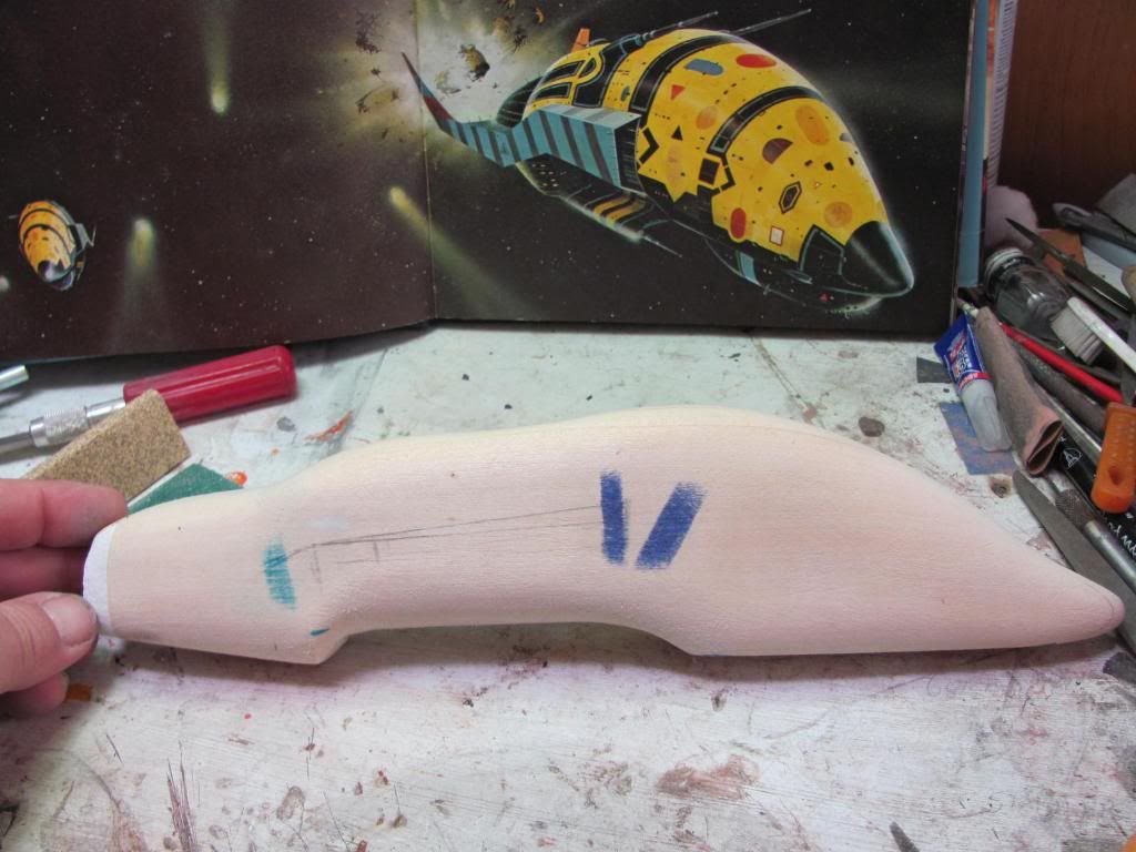

It depends which one of the images you compare it to Ron: it's definately too thin for the main, right hand image, but seems about right for the left hand one. Artists are not engineers! :rolleyes:

Yeah I agree Gondor I was gonna add that later.
Weaver I have noticed that a lot of the illustrations from this book that supposedly show 2 or more of the same craft often don't really look like the exact same models of the same ship . :blink: :unsure:
That's kinda what you get when you try to turn someone elses original artwork into a 3D model.
Off to grind more wood :wacko:

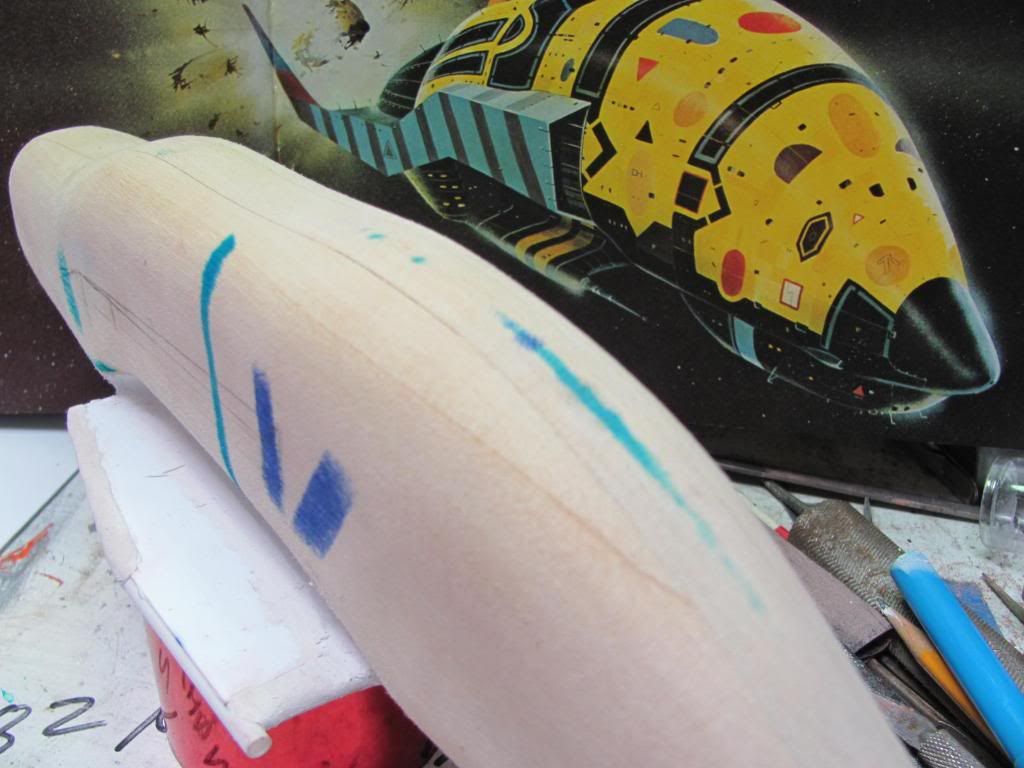

Ron,

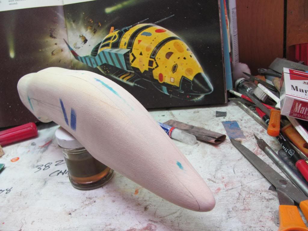

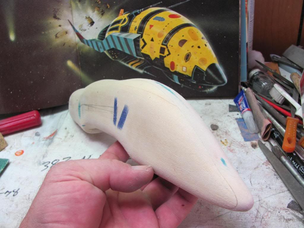

It does look closer to the heads on view, but it looks too thin at the bottom compared to the other views.
Not to deny you your most excellent putty-fu, but you can reduce the amount of putty by making the side intakes (when you carve them) thicker and extended forward a bit, then blend in the extra wood with the existing fuselage. Same with the streamlined gunpod below.
Or just leave it as is - it's a variant from the Texas STS shipyards...
Frank
Good idea Frank  :thumbsup: I definitely have to fatten her up. I have done all the roundification I can on the existing stock and she is too skinny. I need to build the lower gun "wings" first so I can get all the countours to blend correctly.

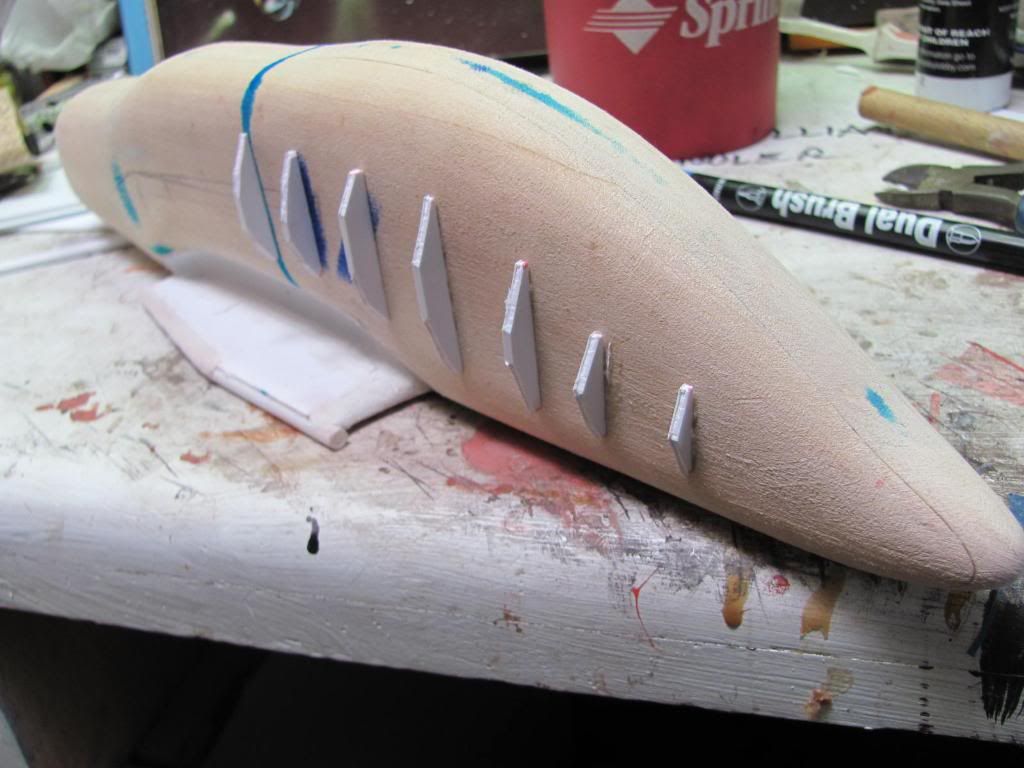

Bobbo,it is nothing awesome I do .I just happen to be able to breakdown complex designs into component shapes. I just look at small individual details and break them down into little bits then figure out what parts I need to put together to make that shape.

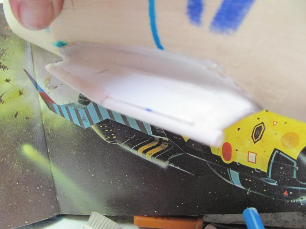

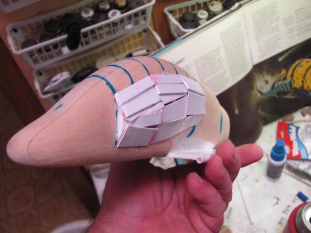

Here is an example look at how I built up the wing guns.
It basically comes down to make the flat parts out of sheet plastic , make the tubular parts out of plastic tube and do the complex curves out of putty. :blink: Oh yeah and build models for about 35 years first ;D :o :lol: :rolleyes:

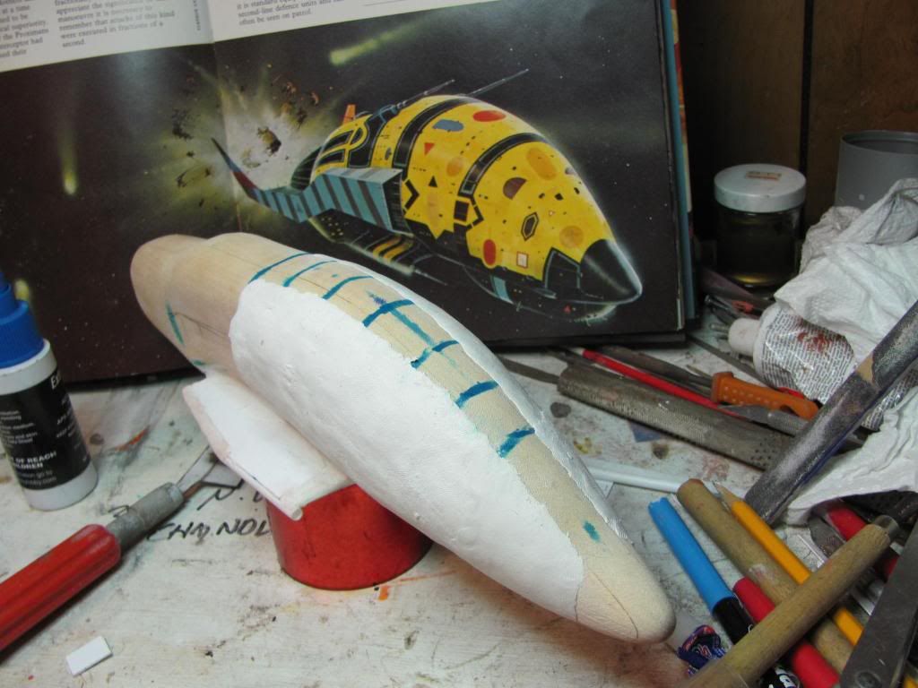

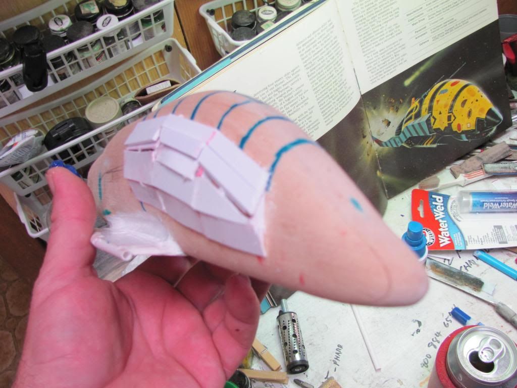

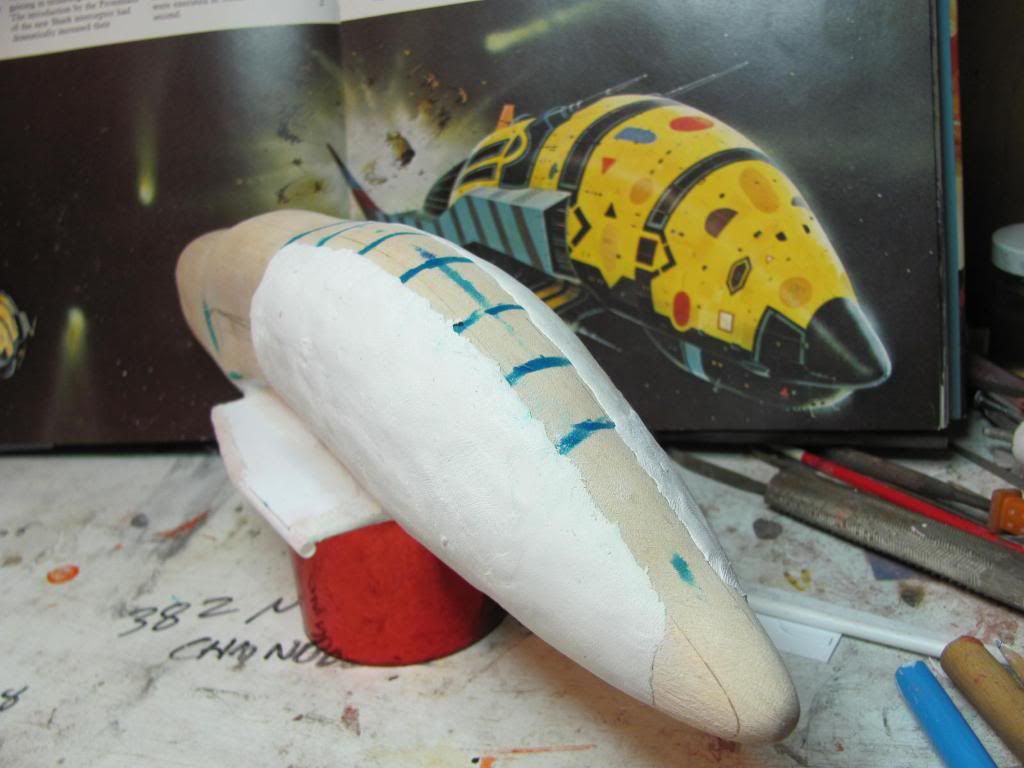

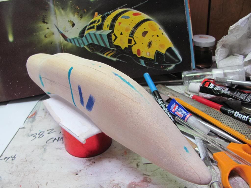

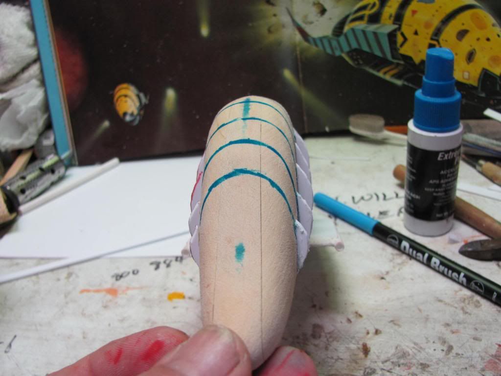

She was too skinny like Paris Hilton  ;) ;D so I did this
Contour

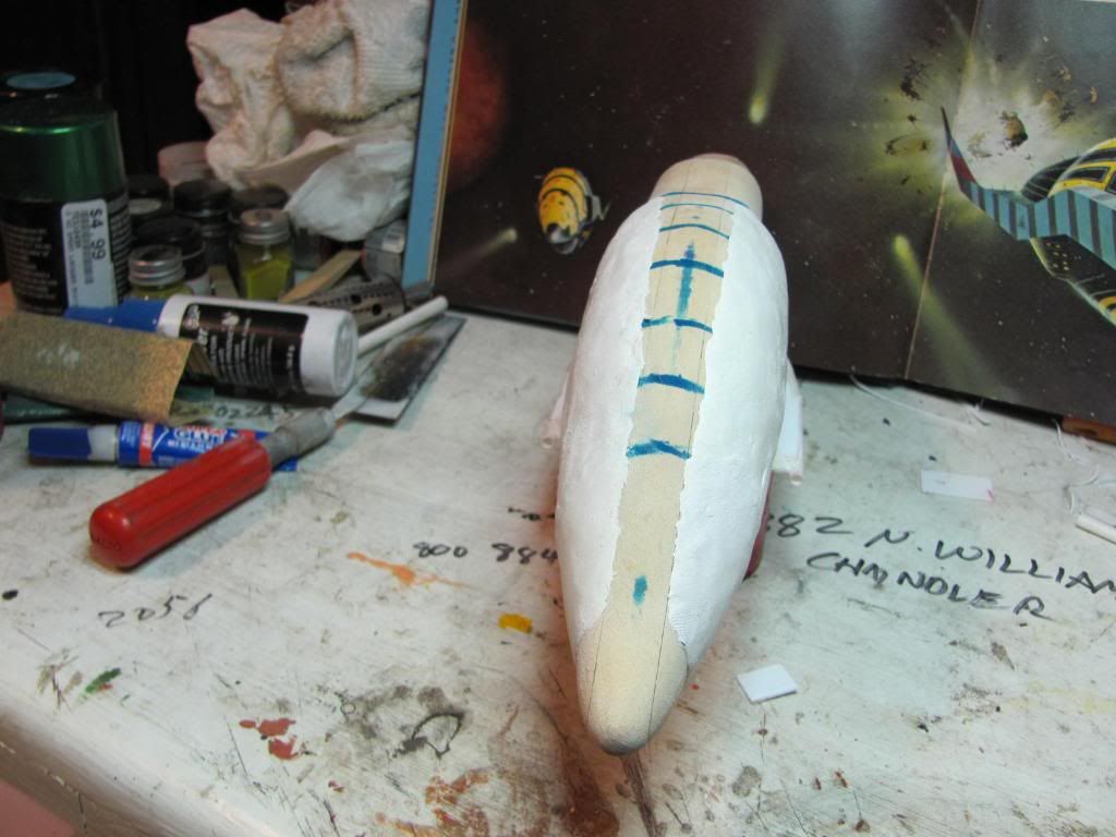

Then to save putty fill in with all my scrap plastic
Then putty
Now she is voluptuous like Kim Kardashian ;) ;D :wub:
Of course I still need to sand :thumbsup:
Yeah that's better: it's more of a rounded cross-section. :thumbsup:
