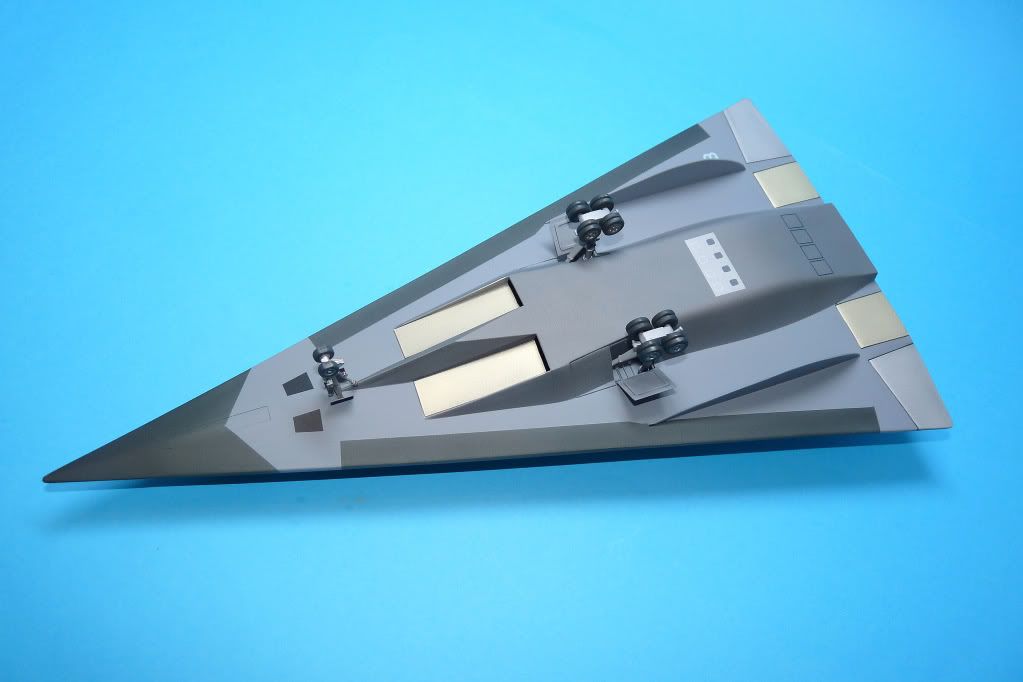

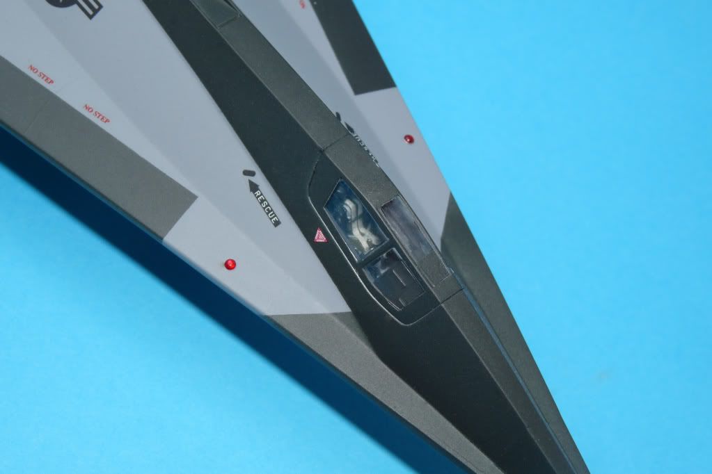

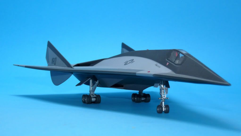

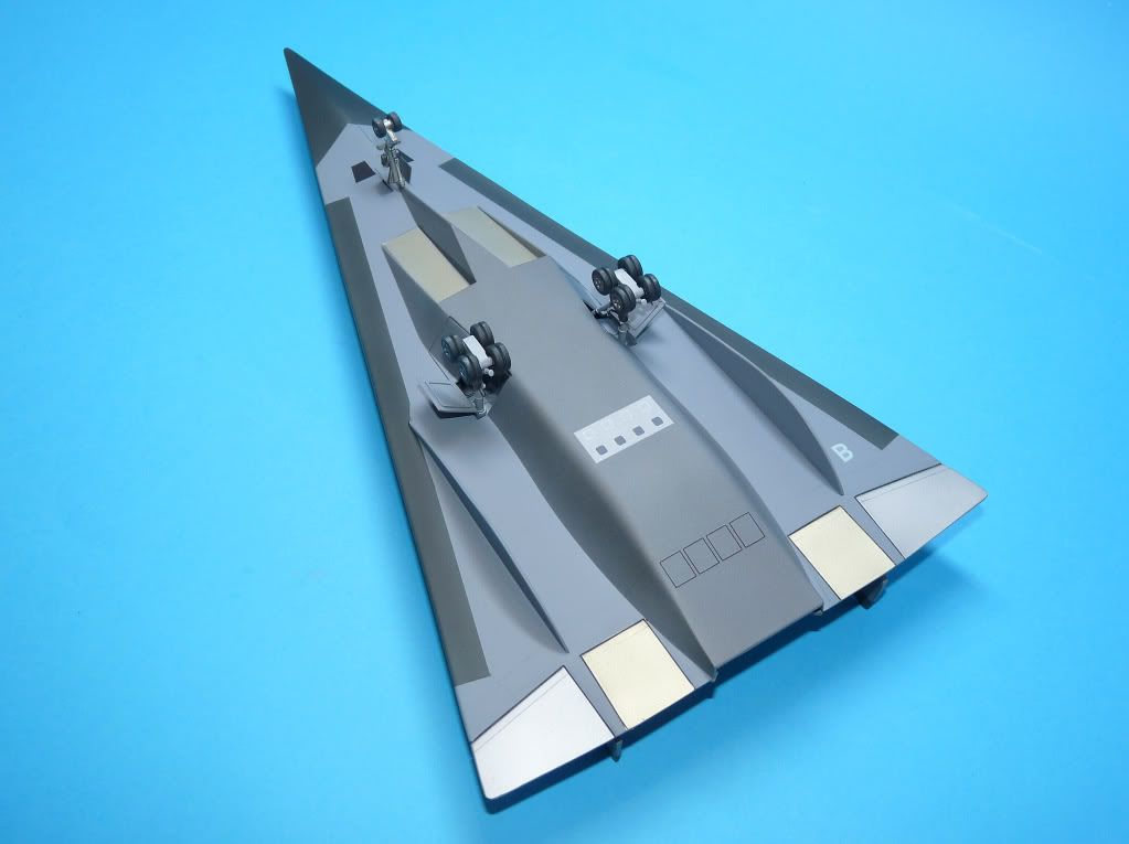

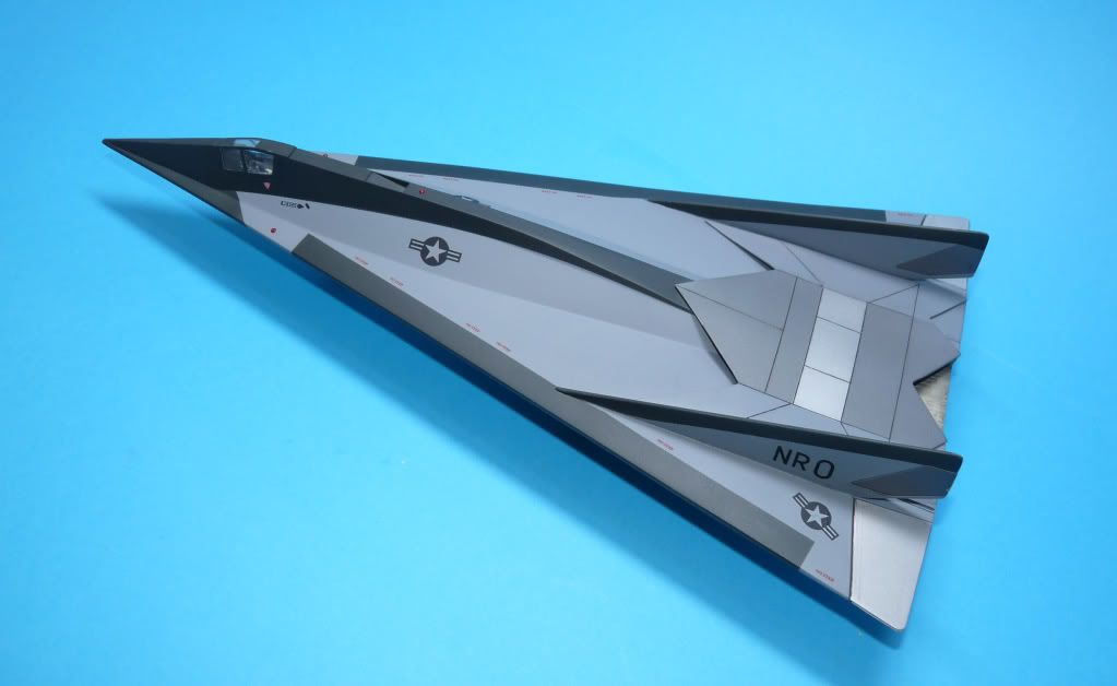

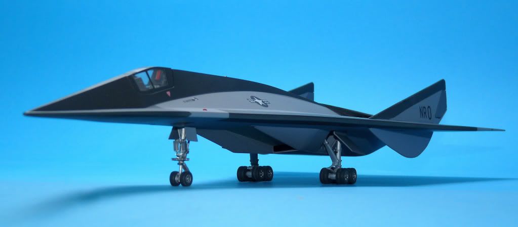

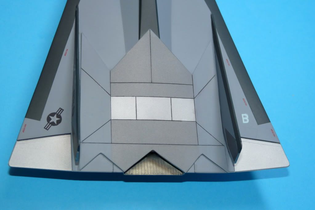

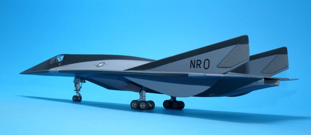

Hi all, I finished this one recently in time for SMW Telford and our Project Cancelled table. It follows on from the Aurora I did earlier and is basically another study of the hypersonic Thunderdart strategic recon element of the concept. I have acquired some drawings showing a very different engine and tail arrangement on this particular version and have modified the model accordingly. I wasn't happy with the podded engines plonked on top of the rear fuselage and thought that the idea of blended intakes,buried  air breathing engines, more highly raked tail fins, underwing fins and a revised undercarriage would be more suitable to the design. Rather than one large single wheeled main and nose gear I've fitted smaller eight wheel units, (courtesy of a spare Victor) and twin nose wheel, (courtesy of a 1/48th Mirage 2000) allowing for the engines to be set deep into the fuselage to minimise the heat signature, (somewhat at odds with the idea of large podded engines sat high on the fuselage as per the kit!!). The pulse detonation engines are set low at the rear end of the undersides venting through the four exhaust pack outlets. The engine covers are all scratch built from Evergreen 4mm card as are the tail and under wing fins all being rescribed to add a bit of detail in these areas and the exhaust area suitably burnt using Alclad hot metal paints and Pro Modeller washes. The overall paint scheme was chosen to match the SR75 mothership and based on the YF-12's projected in service finish and the markings are all from the spares box representing the National Reconnaissance Office which was cited to use the aircraft back in in the ninties and beyond?. Cockpit is detailed using an Eduard F117 set and Aeroclub seat as the kits offerings are very sparse and basic to be honest.

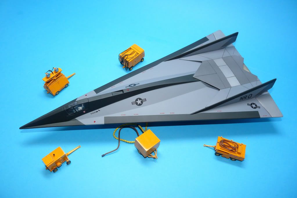

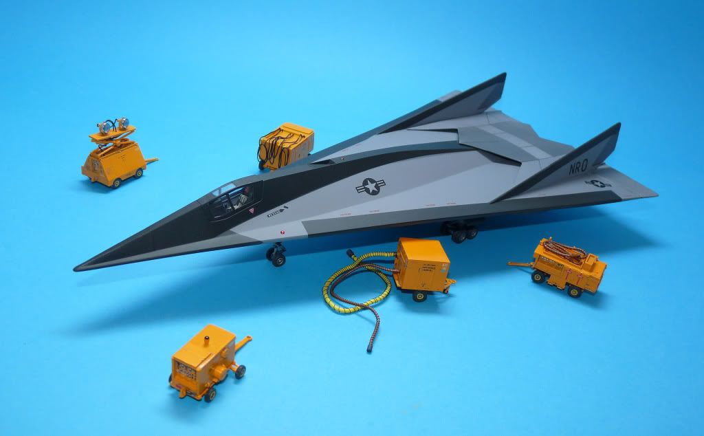

The ground support equipment has been modified from a couple of Hasegawa sets and finished in the high viz scheme of the period.

chrisonord , do you mean the PWDE's or blended air breathing turbofans? because the PWDE's shown on the few images that I've seen show the exhausts to be set low in the area that I've gone for in decal form whereas the top mounted engine 'plate' was cut from card then dogtoothed, (similar to the B-2 ) and fitted between the tail fins and curved over the rear fuselage then a modified exhaust built. Hope that helps a bit....
