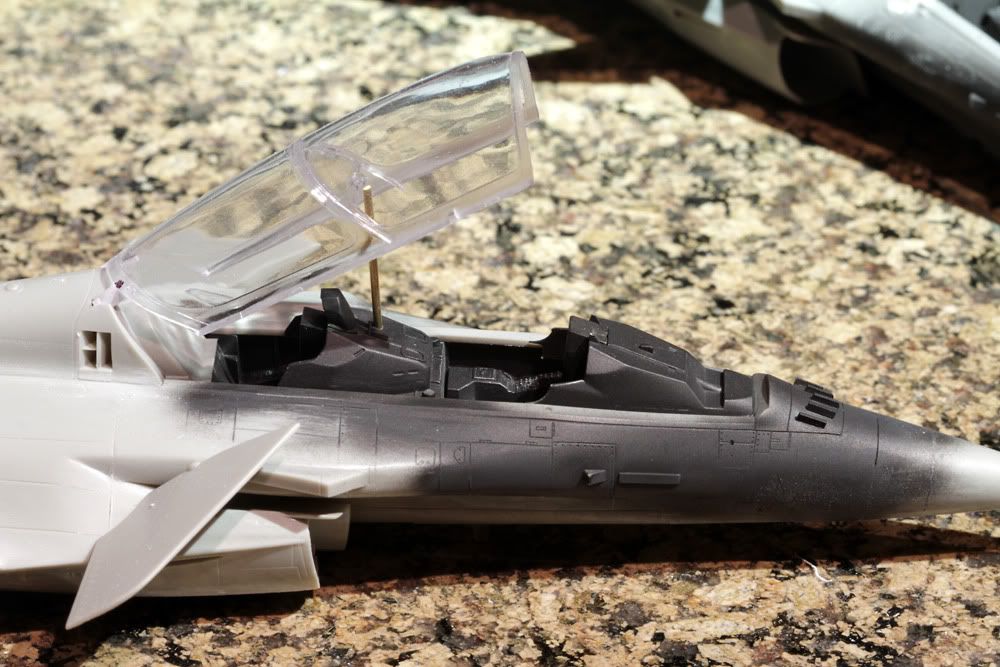

Love the new canopy opening mechanism!  :wub: The IFF bird slicers are also new, I think.

Love the new canopy opening mechanism! The IFF bird slicers are also new, I think.
Ah, shucks.  Thanks Moritz  :thumbsup:
Yeah, I feel the Rafale is one of the most beautiful aircraft until it opens it's canopy. So I put a proper opening on them. The nose sensors on the Rafale makes that area look "too busy". So I added the bird slicer to get a faster look as well as make it look more like the F-2.

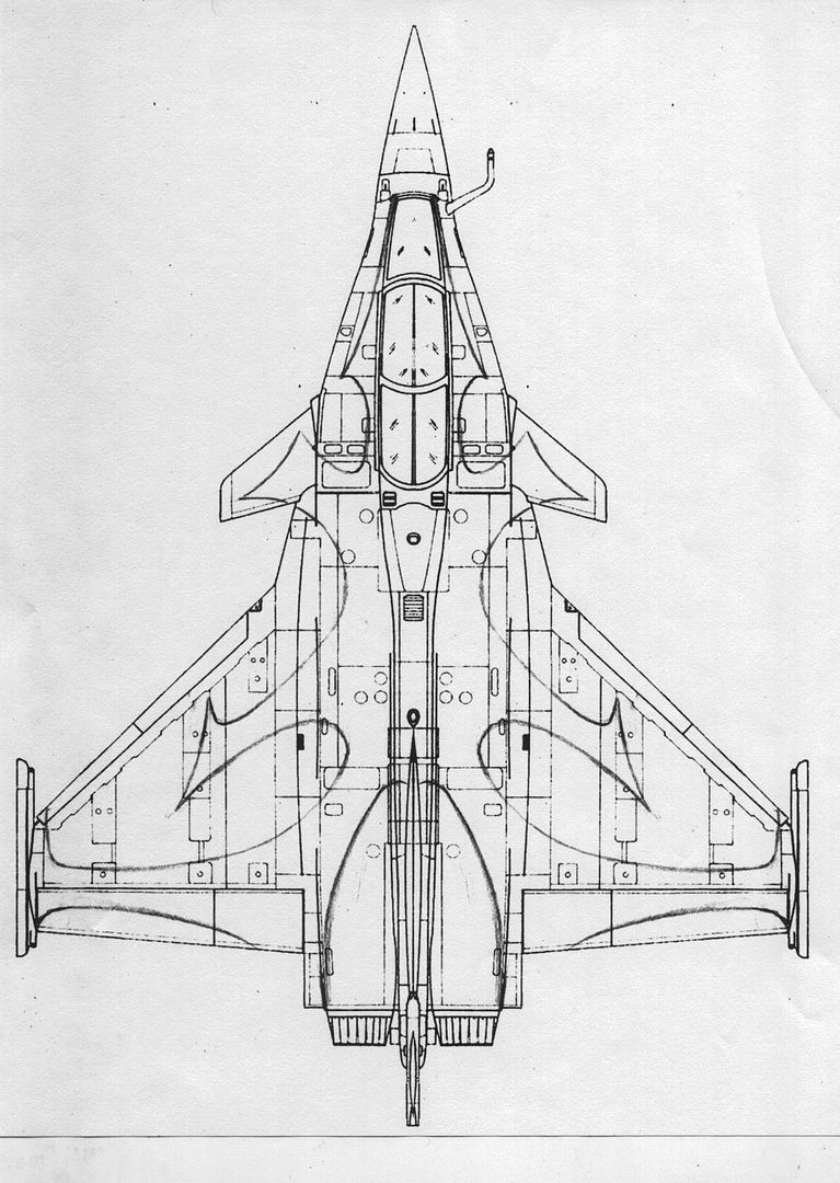

Here's a top view showing where I mapped out the yellow part of the scheme. Masking and painting it should be a blast!  :blink:

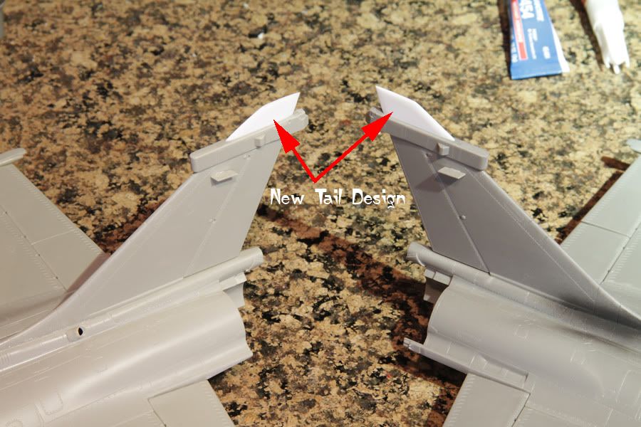

With the holidays and all here's a small update. I cut off the tops of both tails and added my own design. The tops are just pieces of stock styrene cut and sanded to shape.

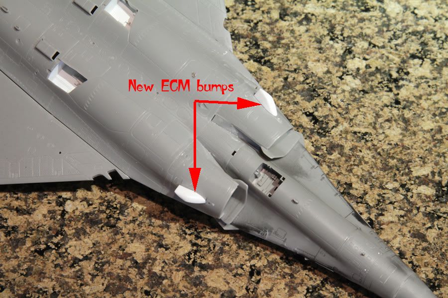

I also added some new ECM bumps to the intakes.The ones that came was the look great but I wanted them to look more like the intake bumps on the F-2. So I use the ECM bumps from my Kinetic F-16I. I mixed up some RTV, molded them and poured two resin copies.

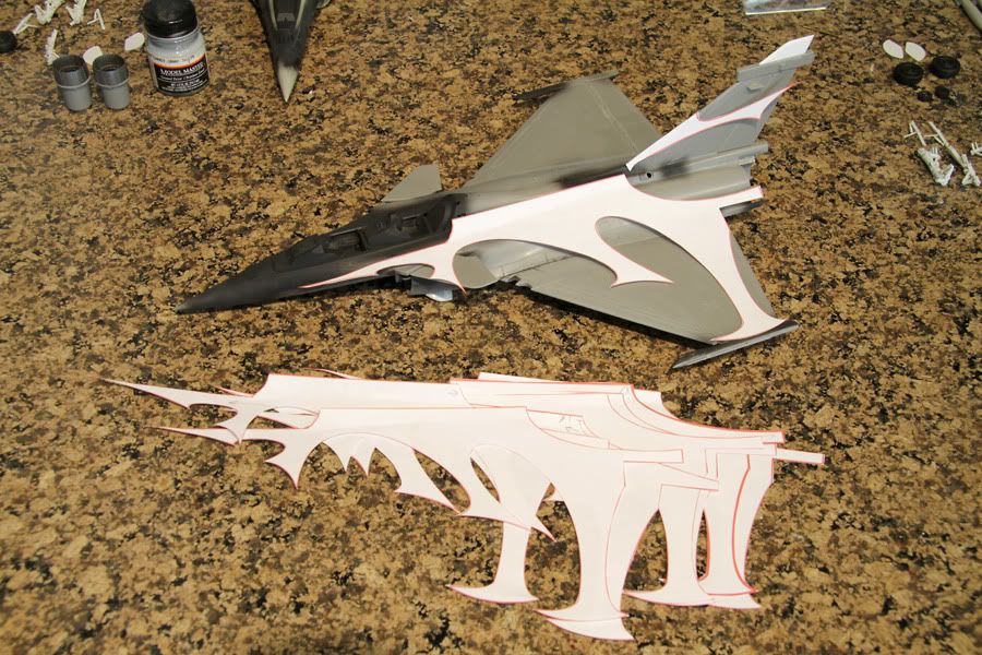

FAR148

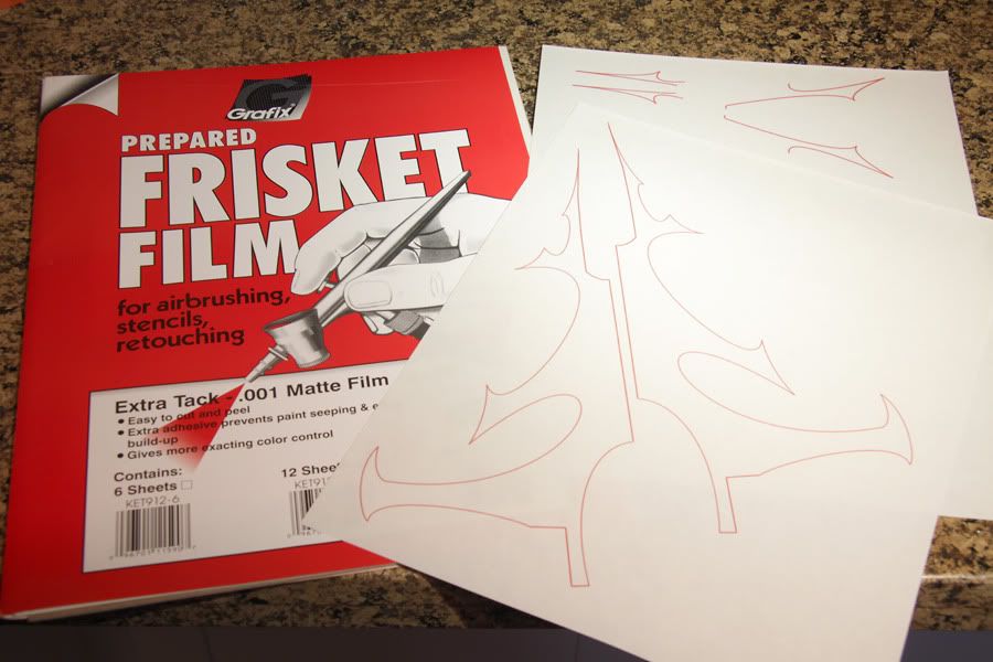

Here's another small update. Yesterday I worked on fitting my masking templates for my blues & yellow JASDF Rafale. I started by scaling my scheme layout image to 1/48 scale. Than using paths in Photoshop, I redrew the design. It took about 7 or 8 tries to get them fit right.
Once all the masking template fit properly, I printed them on some extra tack frisket film. The extra tack is nice n thin and lays down well. Hopefully it will not pull and or lift up the paint below it.
Next I'm going to shoot yellow all over the place, lay down the frisket masking and spray the main scheme. Cross your finger guys!
Steven L   :cheers:
Your masks show more precision than my models  ;D
