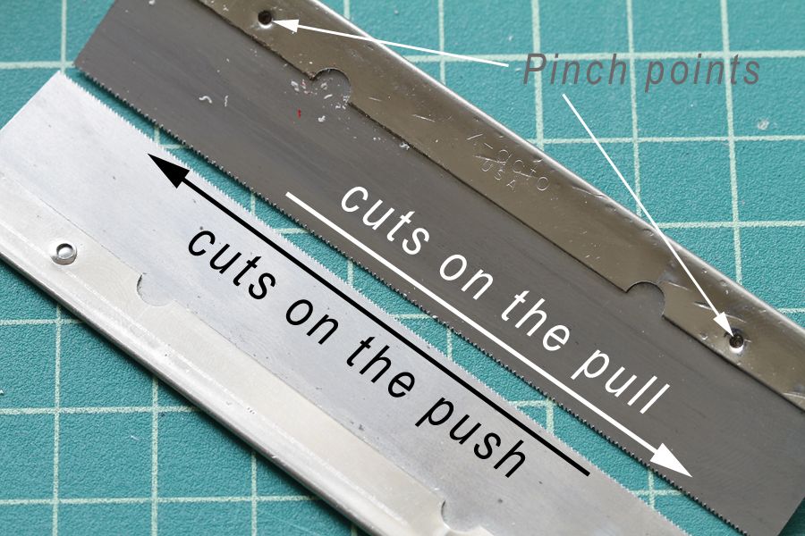

Here's something that I have found invaluable. I've always hated the fact that my razor saw cuts as I push it and not as I pull it. One day, I got tired of it and flipped the blade around. It's very easy to do. All you need is a nail and a hammer to flatten out the two pinch points. Once flatten, just slide the blade out and flip it then repinch the blade. Again, this works well for me and may not work well for you.
