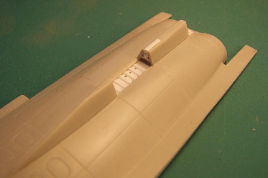

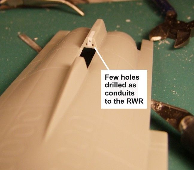

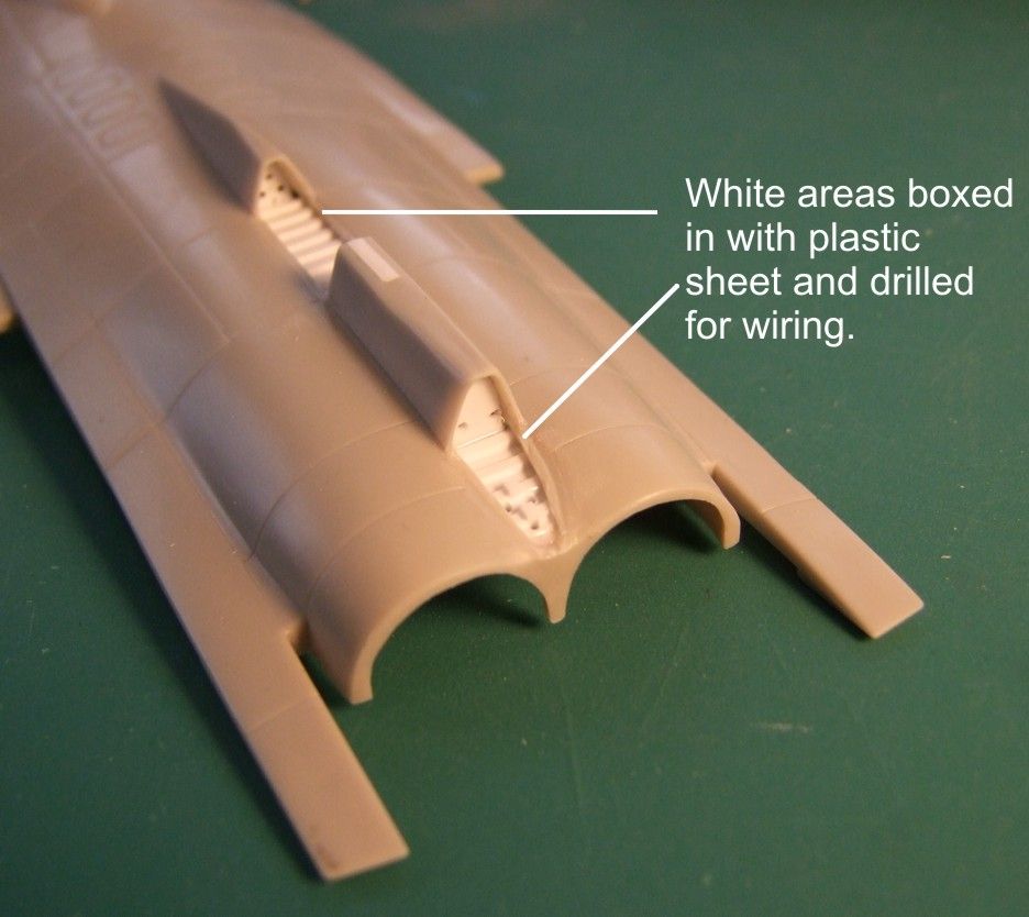

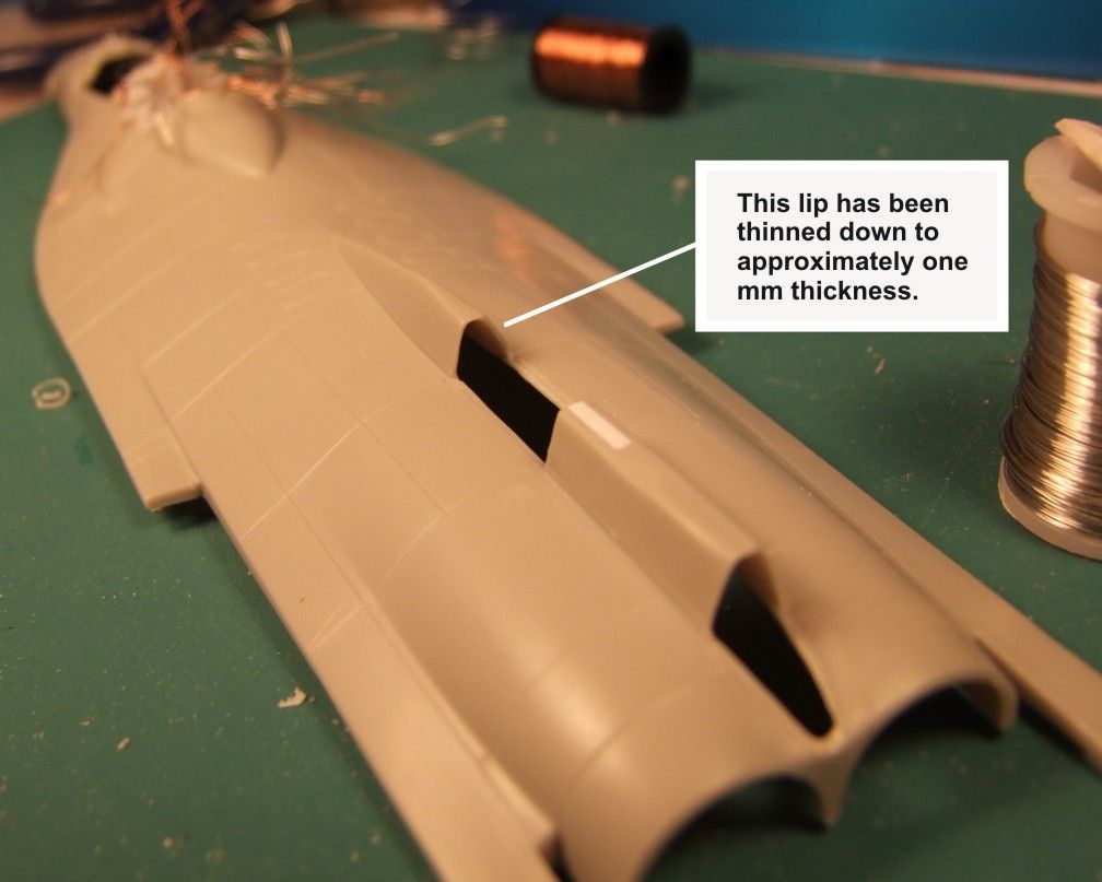

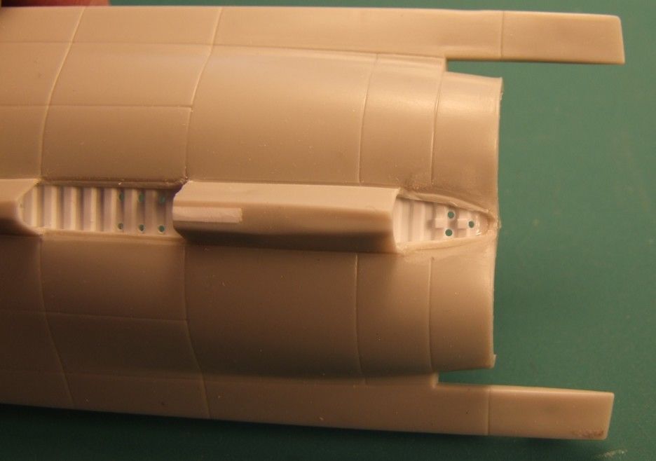

Decided to keep the original tailfin mount as a Rear Warning Radar housing.  Figured I might as well open two parts of that up as well.
I'll be thinning out the plastic walls, etc.
Have thinned down the walls for the RWR access.  Now, just have to remember to also rework the cut-off (hinged) parts, too.
View aft.
Added some rivet holes on the IP coaming, too:
And, guess what?  IDF number two (which will be a fully-armed, camo, 2-seat version) has begun:
Thinning out an access port for a more realistic scale thickness:

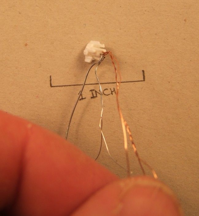

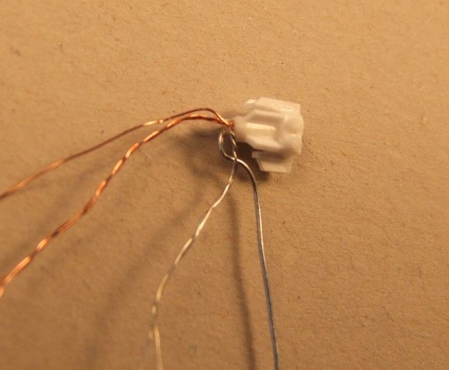

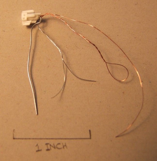

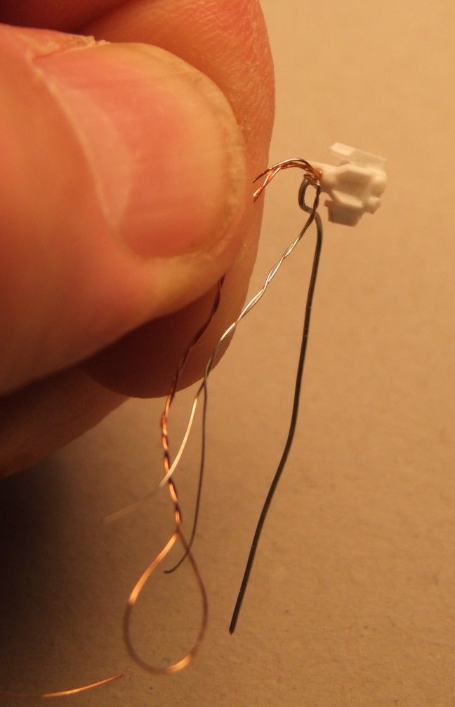

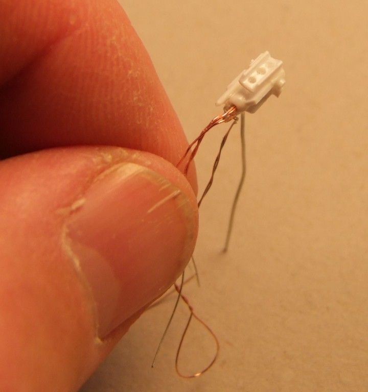

Here are some pics of the RWR (Rear Whatchamacallit Radar) sensor package, complete with ridiculous-looking copper and steel wiring.  Sorry for all the pics but
it is completely asymmetrical so I wanted to show various views.  Wanna hear something funny?  Well, sort of funny.  I was using Loc-Tite's very thin "penetrating" CA glue to bond the wiring to the styrene.  I used a thin piece of wire to let the CA glue travel down to the target area.  You know, like the pro's do.  Only the transport wire was the only thin that stuck to the frakkin' tiny part so I tried again.  Sure enough, I encased the entire part in a pool of CA glue!  I had to chisel most of it off with knife and Dremel so it doesn't look as good as it did before I attempted to install the wiring.  I could have used CA de-bonder but, at this point, thought I better stick to things I can control----my own hands and the tools in them.   :banghead:

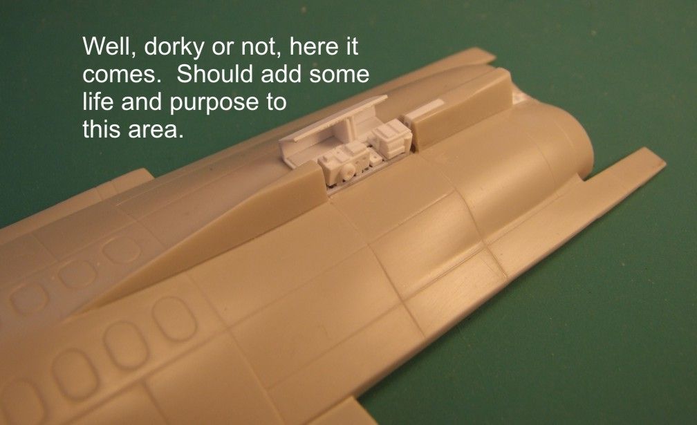

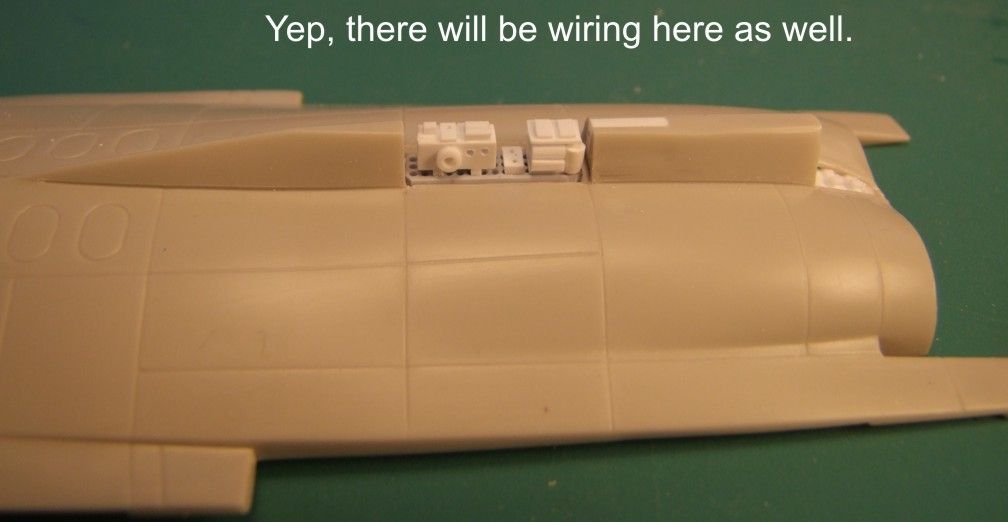

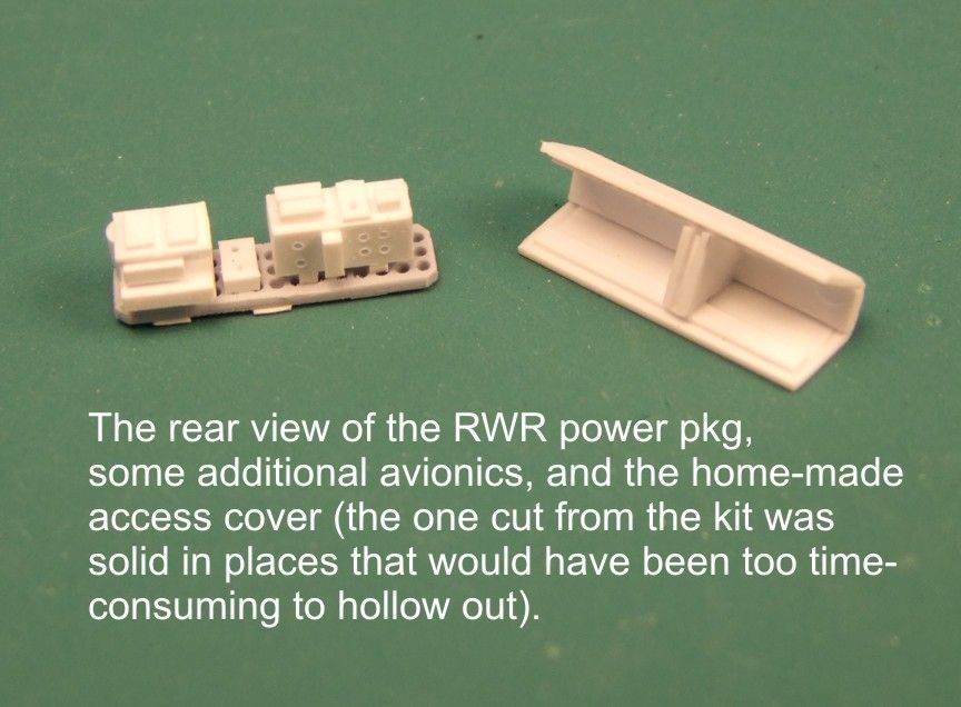

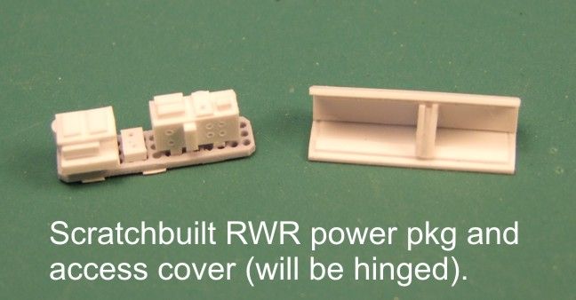

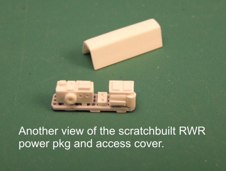

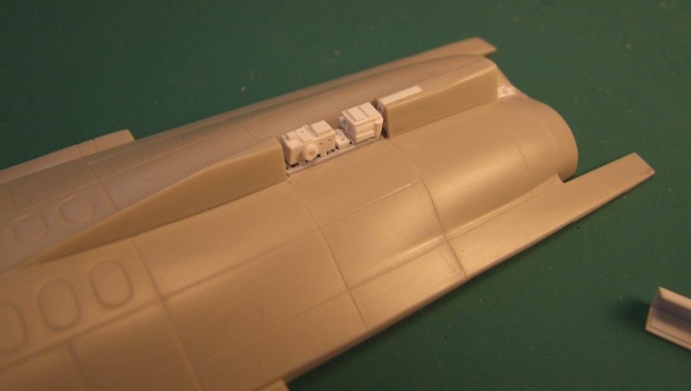

Moving forward a bit to the RWR's power and sensor control package.  As the chunk of the kit's original tailfin chord/mount was virtually solid, I decided to scratchbuild my own.  It's not "Swanny" quality but it will do (it's going to be hinged sideways, anyhow).  And here are some pics of the scratchbuilt black boxes before any wiring gets attached.
I proudly boxed in the two areas only to realize later that you're not really going to be able to see the boxed-in areas well, at least not the fwd bay (Me = silly dork):
The greeblies themselves:
The greeblies in place.

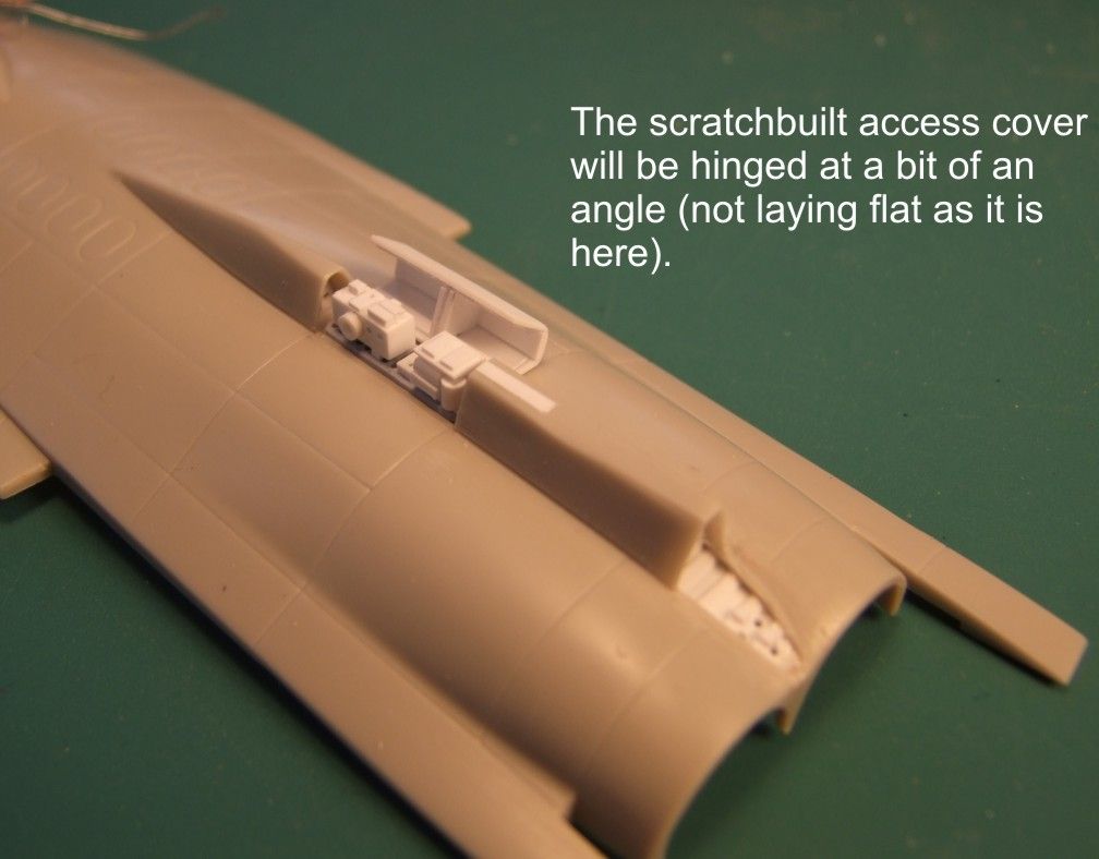

Without the access cover:
And with the access cover:
Probably a silly question....... but surely the tail-fin goes over the power area for your RWR? If that is as I suspect then you will need to have separate covers for each side as you will not be able to have a single cover move through the tail-fin!
Great work though and I sympathise about the glue going everywhere except where you want it to go. Perhaps if you used the eye of a needle with its tip cut off to make a Y shape, with the leg being the shaft of the needle, then use the prongs to hold your CA glue you should have a lot more control over the amount and where it goes. I got the tip from a biplane rigging demonstration at last years Scottish Nationals.
PSR-1 is twin-tailed Gondor (at least in its cardboard mockup phase).
On the tailfins, yep, apophenia has it right.  In fact, I'm putting in all this RWR nonsense to sort of lend purpose and believability to this vestigial area now that the central fin has been replaced by twin fins.  But, don't put it past me to do something like build up an area which cannot be reached later.   :lol:
As for the cut sewing needle CA-glue applicator, I've heard of that from FSM before but I always wondered how you'd keep the CA glue from becoming a solid clump of hardened mass at the forked end...?
Opps..... maybe I should dye my hair blond for missing the twin tails.
Superglue is easily removed from steel with a sharp knife especially if the surface is smooth which it should be using a needle as a source.
