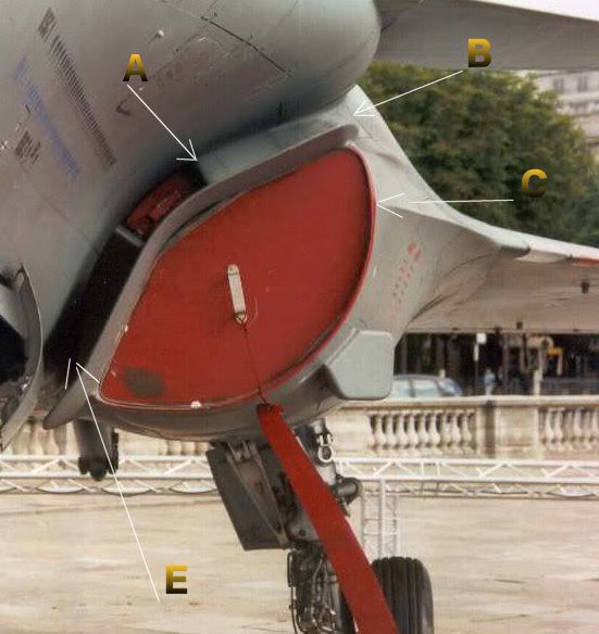

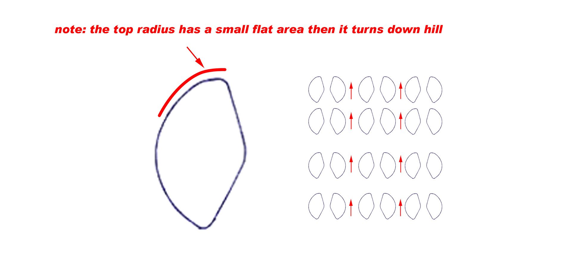

Quote from: Ian the Hunter-Gatherer on January 13, 2011, 03:40:35 AM
Alternatively we could simply put FOD guards on them !
Right click, save as..
No need to scale, just print full size and glue to some sytrene. Then cut and sand to shape. Here's reference pics.(ingore the A,B,C,E aarows)

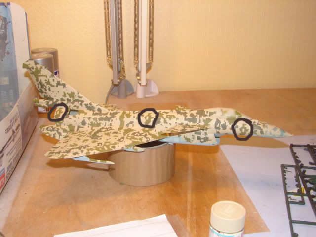

Where did you get the airbrush that you can program to spray on a "digital camo" pattern like that??  ;D
HOW THE 'ELL DID YOU DO THAT??? I scanned the pattern and found ONE that repeated (circled). So did you do all those by individual stencil, by hand, or decal??? Either way, what a triumph of paintwork!!
Fabulous!! :thumbsup:

ton answer your question, the entire pattern is repeating itself (more or less) and this was done with paint and a lot of tape ^^
the technique I used is quitte simple but very very very time consuming, it took me 3 weeks to get the airplane ready for the spraying. I just searched the internet for a digital pattern, found one that repeated itself so I could collate them to obtain a bigger pattern, the I printed it on some sticker paper, put some masking tape on my cutting mat, took my best knife, and a few headaches later, voila !
I'm using the same technique on my f-32 and their's still is one shade of brawn comming, i'll post picture on the how to later :) just in case my explanation wasn't clear ^^
