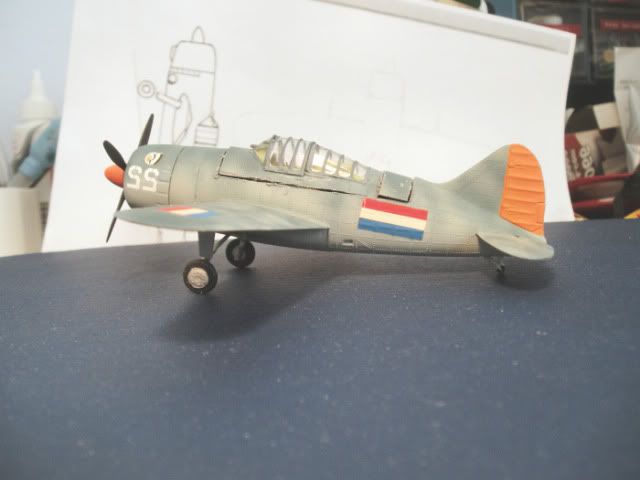

apophenia: >Always interesting to see what can be done with a Buffalo. As it sits (literally), it looks like that big prop might be the world's largest Weed Whacker. Since you're embarking on major surgury anyway, what about moving the wings (and u/c) down abit?<
The prop really is a SMALL four-blader---I think I got it off a Ki-84 Hayate. It is much smaller than, say, a P-47 prop or Skyraider. This view might show you how small the 4-blader actually is:

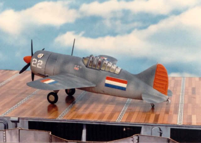

>BTW, fill us in on the carrier deck.<
It's about forty years old, part of a Revell (I think) F4F that had a printed 3D simulated "carrier deck" that was included in the kit box. I have used it many times for pics, back in the '80's, but it is kinda beat-up these days. I also made my own "carrier deck" out of HO train planking that I have for displaying some carrier planes, but it is large and more or less "built in" to my display cabinet.

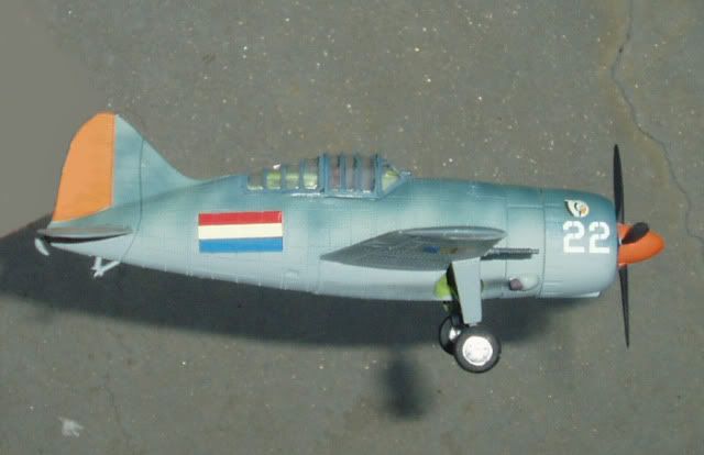

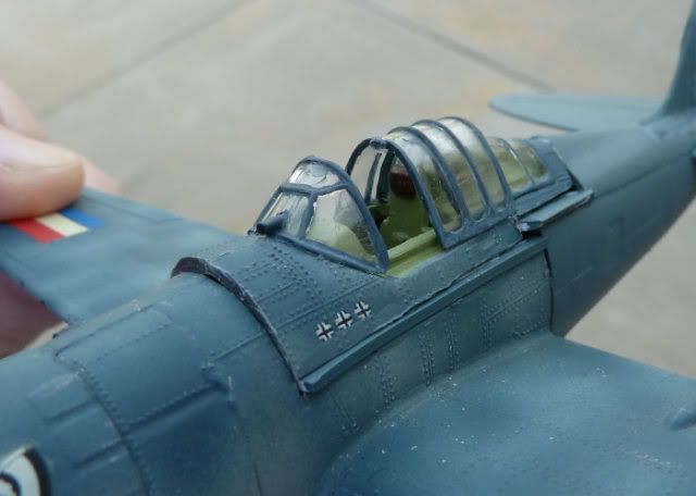

Just got back from Indonesia and Asia. Now my wanting to re-do the "Bison" makes more sense, as it is an "Indonesian" aircraft. Here, once again, is the "original" Brewster Bison that I wanted to "Phoenix":
First was to take a hunk out in front of the canopy (the piece is tucked in back for effect) and move it forward. I liked it instantly, as the nose seemed "too long" in its original form. Now it seems more "balanced" (a Balinese attribute to attain enlightenment).

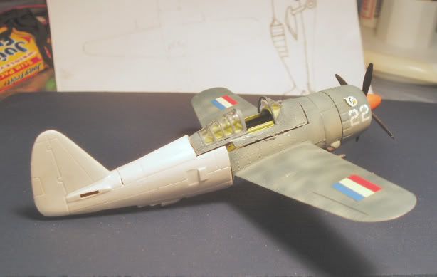

Then the P-47 was hacked up (did you know that the Buffalo's midsection is LARGER than the P-47, supposedly the largest and heaviest single-engined aircraft of the war?) and the whole "mess" slapped together. Lookin' good, methinks. *LOTS* of work left to blend it all in, and add the wing extensions, vert stab fillet, and tailplanes, but we now have the "look" of the beast. BTW, that is the Jo-Han P-47 kit.

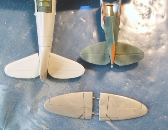

Though I could ACCEPT the P-47 horizontal tailplanes for my Bison, I really didn't like them---made the Bison rear fuselage look TOO MUCH like a P-47 (I'll re-work the rear fuselage anyway, ridding it of the vents and other P-47 characteristics). I looked through my bin of spare "tailplanes" and found some (I think) DeHavilland Mosquito tailplanes that are the EXACT shape (but larger) of the former Buffalo ones! The joy of parts stashes!!
In the illustration below, there is the white P-47 tail (I even tried to "point" the right one a little to more closely match the Buffalo, but... :-\  ), the painted Buffalo tail that I sawed off, and the gray Mossie tailplanes below that I will cut off a bit for the Bison. It'll be a good match, methinks.

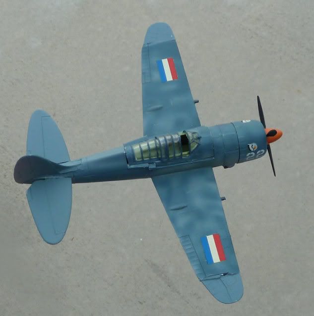

The "hacked" pieces of the fuselage came together, and I filled most of the empty spaces with cardstock. The old Buffalo curvy fillet for the leading edge of the vertical stabilizer was substituted on the P-47 tail. I slapped on some blue-gray paint similar to what the old Bison was wearing, just to see how looks with color fairly uniform. I now have the proportions and positions, but need to file, trim, fill, and sand to create the Bison look I want. I raised the cockpit just a tad, and of course moved it forward. Will ya look at those "lumpy" rivets?? That's old Revell for ya.
Here is a "flying" view of the shape of the Phoenixed Bison. Not so P-47-ish now, IMHO, and more like the extrapolated Buffalo it was meant to be. Wing tips have been added, but need to be PSR'd. If I K.I.S.S. this, I can get it done in a short while, then maybe work on a Heinkel jet project for the '46 GB. Lots more to do, but the end product is in sight.

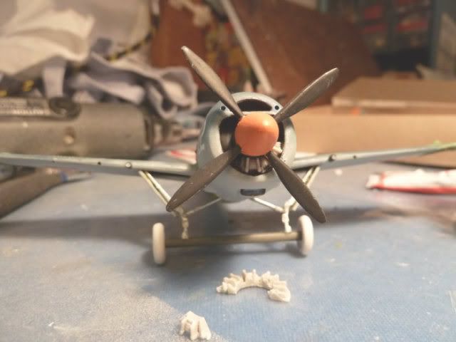

The cheap MRC kit of the Helldiver (from which I got the nacelle and 4-blade prop for the original Bison) didn't have any indication of an engine in the nacelle (look on the left of the picture for the "cavern" where the engine should have been). There isn't much room there, either. My idea was to use an engine "disc" that had half-round pistons and cut it up and insert it. *MUCH* easier said than done. The current iteration is the fourth attempt, after ruining three vac-formed engine discs trying to drill out the hole for the prop hub. My success was due to a hefty injection-molded engine disc (souce unknown) and 1/32" incremental drills that would gouge out just a little more each time (see lower part of picture). Still a hassle putting them in one cylinder at a time (only two in so far--see right side of cowling) and trying to shape the TINY pieces, but I like the way it looks--FAR better than just a black gap. I also put in the two gunports in the nacelle, and will carefully align the cylinder "halves" so that the heads aren't blown off by the guns.
Don't be alarmed at the weird landing gear configuration. A W.I.P. for future individual wheel axles on the individual struts--right now the axle going all the way across is just a "structural support".

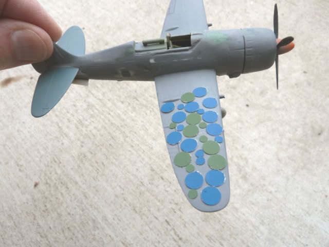

I'm at it again, trying to experiment with inventive camo schemes. Here I am after a "mottled" look, but will use two different diameter circles to achieve the effect. I am not sure that the soft edges of "typical" mottle camouflage really make that much difference, especially from a distance. I didn't want "polka dot" rigid patterns with regular spacings, uniform-sized dots, etc, but will seek a "random" pattern much like you see here.
I think that the human eye is especially good at discerning shapes, and maybe giving "distinct" forms is a bad thing, but I also think that any "breakup" of the silhouette of an aircraft makes it hard to discern. I want a three-color camouflage, with a muted blue-green the end result of the effect, so I am going with this "bubblebath" style of hard-edged mottle for my Bison, just for kicks!
