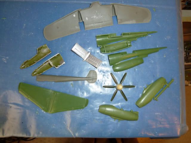

At the prompting of Frank2056, I am combining his and my Lindberg He-162's to make the concoction I proposed in another thread. That is, a pusher, twin-boomed turboprop resembling the He-162, like so:
Herewith are posted the major parts. I will probably substitute the Lindberg Ar-234 jet pod (same green plastic and appearance, but slightly larger and longer), but otherwise it will be a Heinkel-ized Saab J-21. I need to finish my current "Bison" project, but neither it nor the He-1062 will be very complicated, methinks, and will proceed fairly rapidly. Aiding the anticipated rapidity of building is the fact that the Heinkel wing is a dead match in chord for the outer wings of the Saab J-21, and the tailplane between the booms is an exact match for the vee-tail of the Heinkel. I think the "vee" may be inverted for the whif. I'm not looking for a magnificant "winner" here, but I like to participate, and the time crunch means that simple is good and worthy.

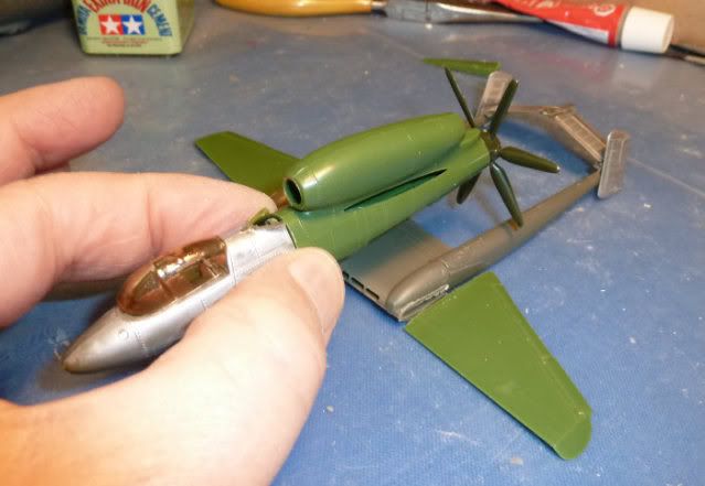

OK--since the Bison had much "PSR" and I am waiting for putty to dry, I fiddled with the "Newt" and came up with this preliminary mock-up:
I will have a larger jet engine pod (courtesy of the Lindberg Ar-234). The wing-roots and boom end will hold the armament instead of the forward fuselage (partly because the Lindberg He-162 doesn't have them anyway!), the tailplanes will be an inverted-V, with perhaps the endplates bent out in an actual "V". I *JUST* noticed that the space between the booms is LESS than the radius of the prop blades (!!), so they may be cut down and squared off a bit. The prop hub will actually be up above the place I just tacked it, but the radius may still be a problem. Otherwise, the "Newt" is getting hatched!!

Craig, it's looking great! Are you mounting the wings in the original location (as in the drawing?) It's amazing how well the Heller bits fit.
Frank
>Craig, it's looking great!<
Thanks. You can see I have added length to the forward fuselage section, needing only to patch up the hole near the joint.
>Are you mounting the wings in the original location (as in the drawing?) It's amazing how well the Heller bits fit.<
Yes, the He-1062 will have the same high wing location as the He-162. That's why I will *NEED* to use the He-162 landing gear, as the Saab wing will otherwise be too high and spindly to take landing gear. I will remove the He-162 engine nacelle, and substitute the longer Arado one that, coincidentally, is EXACTLY the same length as the Heinkel nacelle plus the "fin" at the exhaust outlet (too many coincidences here!--I think this is telling me it was MEANT to be built!). The He-162 wing is much thinner than the Saab outer wing, so I may have to...don't know what yet. A W.I.P. fersure.

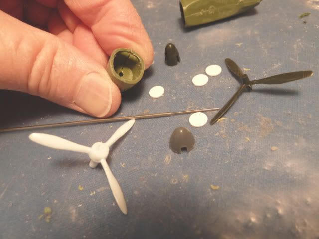

I have looked at the possibilities and engineering of spinning contraprops and have hit on an idea. Us old folks may remember that the original Revell 1/72 Zero had a beautifully-shaped, but OPPOSITELY-spinning prop (who FUBAR-ed THAT one?). Since Hasegawa has the correct one, I have a "matched pair" that will contra-prop. I had great success with stainless-steel tubing axles within each other on another model, so will try that here. Luckily, again (luck favors the bold, I am convinced), the Lindberg jet nacelles have perfect holes through bulkheads in the perfect center of the openings, so I will use them to prop up my props. A few discs of plasticard to be endplates should do it, but I have to pre-measure everything carefully. BTW, I had to cut off and turn over the nacelle forepart of the Ar-234 engine, as it was an "underslung" nacelle rather than the "overslung" one needed for the He-1062.
