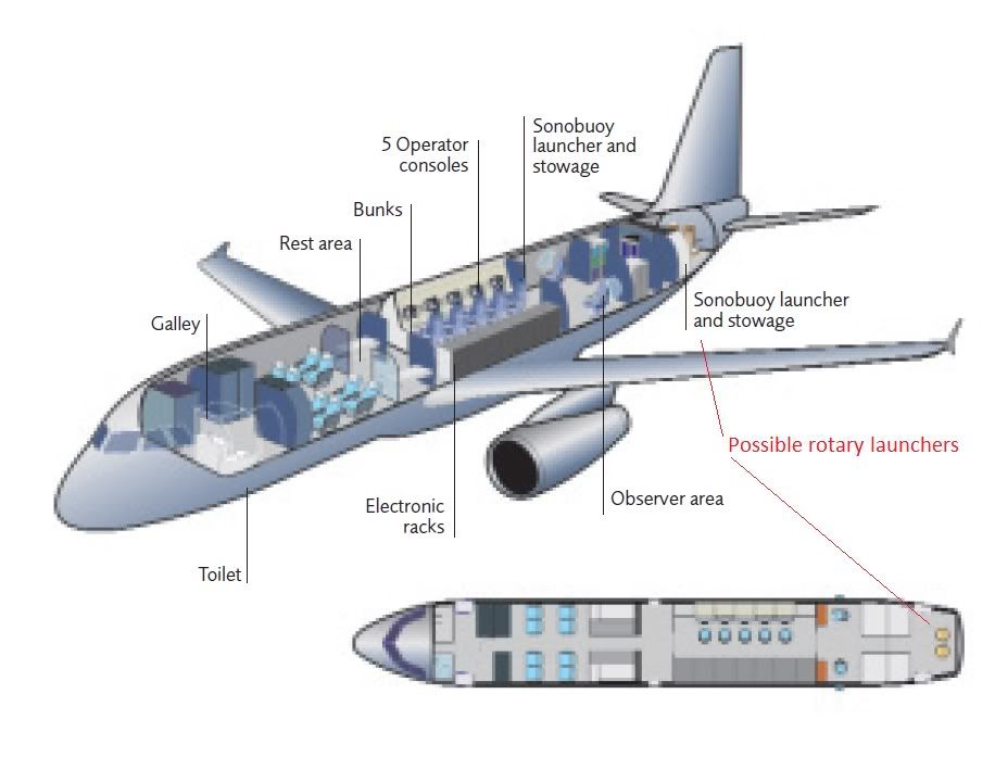

Just one question:  Have you confirmed the sonobuoy launcher arrangement?  I ask since I suspect it is actually proposed to have twin rotary launchers somewhat similar to those for the P-8.  Although I have been unable to confirm this to be the case, the following picture from EADS seems to confirm this (the 2 yellow circles at the extreme end being the actual launchers):
It is also backed up by this image which although not showing any launch ports, certainly doesn't show a whole bank as you have done.
I hope you appreciate this is only raised to aid in your work.

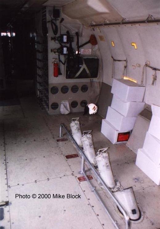

Quote from: Hobbes on June 25, 2011, 02:01:48 PM
some manual tubes for launching the special items.
In that case, you could probably get by with some simple tubes (not pre-loaded kind) - here's what a P-3C has:
I think you could probably get by with 2 at most really.  IIRC the P-3C had more because it was a backup if the pre-loaded system totally failed (i.e. you would have guys 'shovelling' the sonobouys out the manual tubes).
