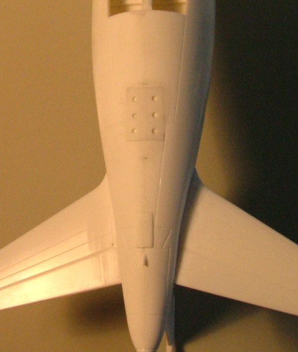

I've redone the sonobuoy ports. My initial effort didn't result in straight lines between the ports, drilling on a curved surface isn't easy. So I drilled holes into a piece of plasticard, and faired that into the fuselage instead.

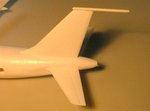

I've also added a MAD boom. Unusually, this sits on top of the tailfin (as per the brochure that Greg linked to).

I believe the manual tubes in the P-3/CP140 are freefall, but triggered.
As to the location of the MAD boom, the "normal" low tail position for the MAD is, in an A32X, occupied by the APU. It was probably easier to engineer the MAD boom into the fin-top than to relocate the APU and its associated systems.

There is an added advantage to your portrayal of the sonabuoy launch tubes. The added plastic looks as if it could be a strengthening plate around the area of the tubes which would be a logical thing to do.
Putting a boom on top of the fin would work.  As the objective is to put the magnetic sensors as far as possible from the electro-magnetic sources in the aircraft (engines/computers/etc.), in the tail or on top of the tail would be just  as good.  Doesn't the Tu142 Bear have one there?

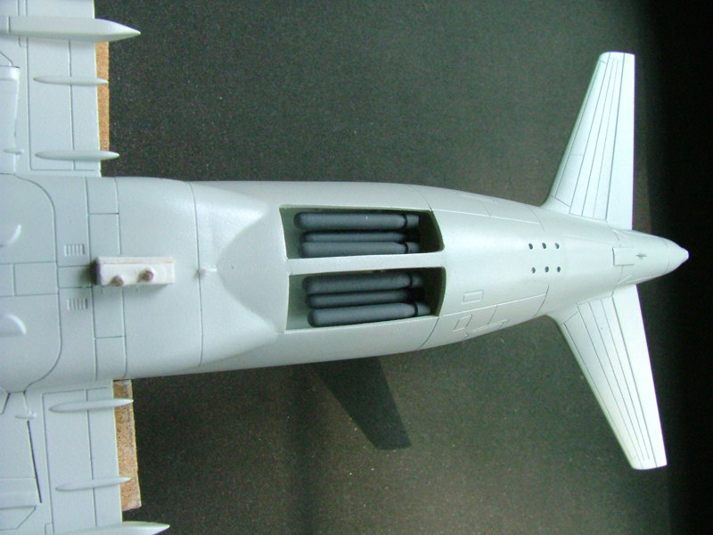

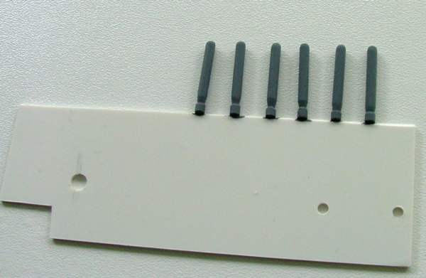

I've painted the aircraft (mostly, there's still some details to do), and I've been working on the torpedos.
Once I managed to produce 6 torpedos that were close to identical, I stuck them to some plastic for painting:
Here they are, installed in the weapons bay:
