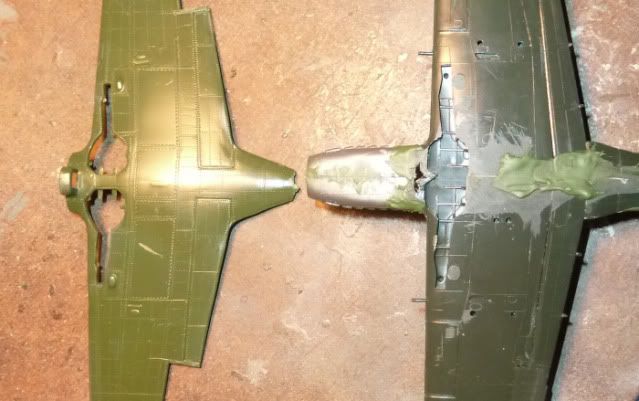

Now for the "wing working". Using the Revell Hayate (top in photo), you can see I have had to eliminate the space between the wheel-wells to bring the fuselage/wing interface into proper placement. This means I will "fill" the Hasegawa wheel-well with CA and putty, and the new "wheel well" will be slightly farther out and slightly tilted back, as I need space for the coolant radiator (even on the radial Hayate, the wheel wells are too close together to fit any part of the coolant radiator between). The "wheel wells" will also be "paint" (decal, really, in the shape of the wheel well) rather than proper indentations--"artistic license". I sawed off the wingtips of both the Ki.84 and the Fiat G.55, and will trade them to bring the Ki.62 wing up to its "specs" of 39 1/2 feet a proper shape. Regrettably, as much as I had hoped that carefull measuring and cutting would produce a "clean" break line between disparate parts, the fuselage pieces need PSR to mask the separations, with the resultant loss of surounding surface detail. I  *HATE* trying to scribe/re-scribe panel lines only slightly more than I hate smooth, featureless plastic. We'll see.

I have the wingtips on, the wing/fuselage interface puttied, and the "throat" coolant radiator attached (had to reverse and re-form the Nichimo Ki.61 ventral radiator). I cut the immediate canopy section of the top fuselage off (so I can make an interior and insert it), and glued the rear fuselage to the front fuselage/wings, so the "shape" is all there, now. It looks REMARKABLY like a Bf-109F (or Yak-9) with that pointy nose and throat radiator.
I will probably put the small Hayate oil cooler on the underside of the port wing, with the fuel cooler under the starboard wing (the original Hayate had this), just outboard of the coolant radiator "wake". I am thinking to use the Revell front and main canopy with the Hasegawa rear section, as the Hasegawa canopy looks a little "wimpy". I may put Fw-190 under-wing twin 20mm pack guns on. I have bored out the nose gun troughs and they await visible 20mm barrels. No pics, just W.I.P. update.

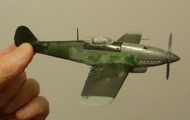

Found that I had joined the Hayate tail and Hein fuselage just a smidgeon off laterally, so MUCHO filing and PSR to get the countours continuously tapering instead of an (faint, admittedly) "S" curve. Coming along S-L-O-W-L-Y.  I do have the radiator on, the wingtips on, fuselage gun troughs gouged, and am working with the cockpit/canopy module, but here is a recent mock-up:

Looks great! Tail seems a little diminutive, though.
#27
>Looks great! Tail seems a little diminutive, though.<
It's the standard Hayate tail, and the fuselage dimensions are the same. The angle of the photo may seem to make the aircraft look "thicker" and beefier than other photos. Look at the profile picture on "reply # 14". The Bf-109 had a pretty "small" tail, too. Also, my thumb is obscuring much of the tail! Possibly the "ko" or "otsu" versions of this Ki.62 might have had a larger tail!

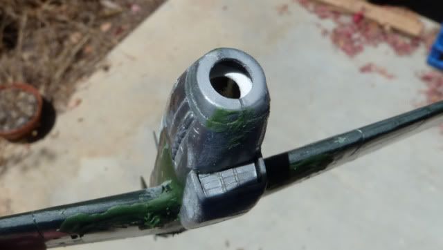

I was dis-satisfied with the Nichimo Hein prop set-up. I would have to glue the prop and its retaining ring in BEFORE completing PSR in the nose area. Really don't like that. Luckily I had a spare Nichimo Ki.61 nose (from another Kawasaki project) because I broke my present one trying to drill out the opening. A Matchbox Halifax had a good, fat, 3-bladed prop I could use, with a pointy, Kawasaki-like spinner, and had a module that could, if the nose was engineered correctly, take the prop/spinner assembly POST painting (and post-PSR). I had to carefully make a hole JUST big enough for the end of the prop module, and since it tapered toward the retaining ring, had to make an interior bulkhead (installed through the cockpit opening) with a slightly-smaller-diameter hole in it for support.
As the plane and backstory is evolving, I think it will be a "B-29 destroyer" with twin pack 20mm guns under the wings, a pair of 30mm cannon in the nose (with attendant bulges), and the fat-bladed Halifax prop will be an add-on to the improved Ha-340 inline engine.
