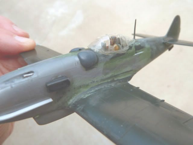

I THOUGHT I was ready for painting, but...! I needed to move the underwing gondolas forward on the wing, resulting in a glue FUBAR (is a "glue goof" a "gluef"?) that needs rectifying (AFTER it dries--wait, wait, waiting impatiently). The fuselage is done with the PSR, and came out as well as I had wanted!! I ended up making a Vac-form canopy from the Revell canopy (WAAAY too thick--if it were "armor glass" it would probably stop a tank round!).
I did indeed put on the Me-109G-type fuselage bumps for the gun breeches of my 30mm nose armament. It looks nasty from the front end, but not "clean" for speed (probably dives like a meteorite, though). Presumably my "Mozu-II" has the high-altitude capability to get to the B-29's with the "DB-605" cloned engine, and hordes of American fighters have not yet appeared, so, like their encumbered German counterparts, it's not terribly speedy and manuverable, but there is still merit to be found in the heavy armament.

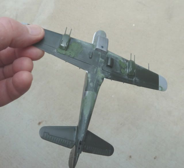

WHEW! Way more PSR than I first imagined. But why does that surprise ANYONE? Here is the "completed" aircraft just before the primer goes on, with the "bumps", the exhaust deflectors, and the mega-cannon in the nose:

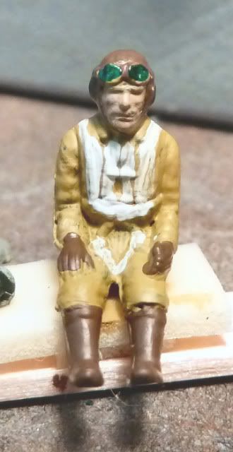

and here is the pilot (moments later installed in cockpit):
And here is the underside (still a bit of PSR to be done, but irrelevant to the look):

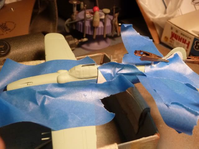

I may have some pics of the painted (kind of a "Sky type S" color) plane later, but right now I am futzing with the canopy/fuselage interface (from a too-stiff Vac-formed canopy), and making a mask for the vertical stabilizer so I can "blue" the tail "wave" with spray (I am going to make the "arrow" part a painted clear-decal piece the same color). Trickier than it may seem.
I masked off the anti-glare panel and the tail "blue wave" with tape and cardstock. As Murphy's Luck would have it, there was "overspray" and "leakage" under the mask in places that I will have to correct, but it came out pretty well. I will probably  NOT post another "in progress" shot until it's all done, as I am virtually to the decal stage, now (needing only to correct the spray goofs, clear-gloss the plane, then add decals).

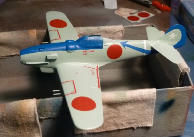

#43

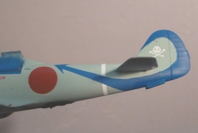

Here is a "preview" of the Ki.62, decalled on top. I really like how the "no step" striping for the Hayate stands out on an otherwise somewhat-bland, single, light color. The striping would have gotten kind of "lost" on the more typical dark-green Hayate finish.
The "blue wave" is actually part spray-paint and part decal. Both the same color, of course. I used the same color as I used on the tail (Floquil "Conrail Blue") to spray on a sheet of clear decal. The "wave" was masked and sprayed on normally; the "arrow" was carefully cut out of the blue-sprayed, clear decal paper. You can BARELY see the differential line under the middle of the tailplane.
Under the Hinomaru on the very bottom of the plane, you can see some extra putty that I reluctantly applied to a "flaw" that somehow I didn't see after applying the light green paint. Gotta fix THAT before doing the underside decals. But...you can see inklings of the final product!
