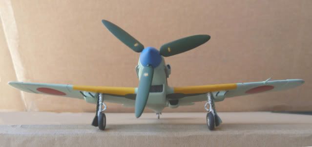

My Nakajima Ki.62-II "Mozu" came out looking remarkably like the original drawing, methinks. I suspect that the original drawing was some artist's extrapolation of a Hein with Nakajima design appearances. The Ki.62 drawing had the fuselage length quizzically shorter than the Hein, Tojo, Hayabusa, or Hayate, so I did lengthen it a little to match the Ki.84 Hayate look (I *COULD* have super-sectioned the rear fuselage and taken a couple of feet out of its length, but....!!). Kinda resembles a Yak 9. I had many last-minute glitches about which I am VERY angry, but I feel I made an excellently-engineered kit-bash of the subject and captured the look of the Ki.62 project with some design "upgrades".
Here is the underside showing the hefty propeller, decalled "wheel-wells", pack guns, and oil cooler. The fuel-cooler is blocked by the prop blade.

GTX, AXU, SideshowBob9--thanks. I AM satisfied, actually, though I just noticed (lower photo in post below) that the left landing gear somehow got "splay-footed" out while drying, so I will correct that.
Now, if I display this Ki.62 in some contest, I will somehow have to explain that it is NOT the Unicraft kit, but kit-bashed from six different aircraft (two more if you count the armament changes).
Compared to the "official" drawing, my Ki.62 has a slightly wider nose radiator. The official Ki.62's was only as wide as the spinner---too little cooling area for the engine, methinks, and would have given the "Mozu" overheating trouble. My coolant radiator was taken from the Ki.61 with the same engine, so should be about right. Also the fuselage is slightly longer (in the tail), there is an additional small oil cooler under the wing (Bf-109's had TWO coolant radiators as well as its oil cooler) and the armament is changed. All within a designer's "discretion", and why I named it the Ki.62-II. I also feel that if Japan had license-built the inline engines exactly as the Germans had built theirs, many of the reliability problems associated with their "cheap" copies would have disappeared and made the "inline-engined Hayate" a real contender*.
