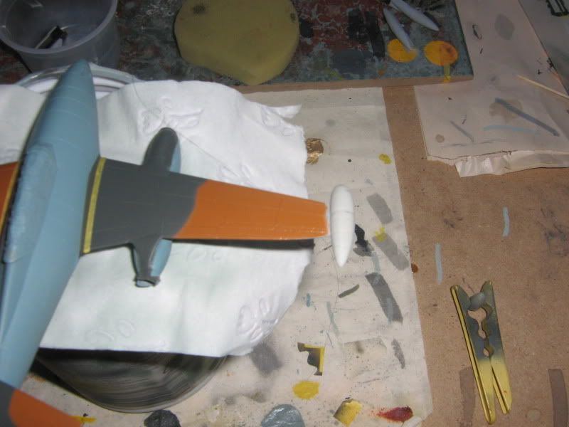

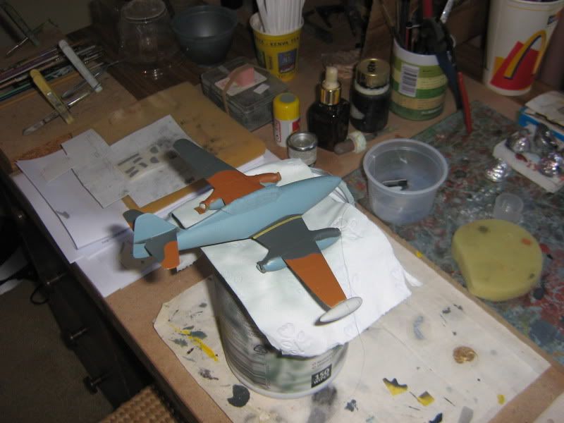

lots of ideas and I've got some underwing fuel tanks to add later, but first the color scheme

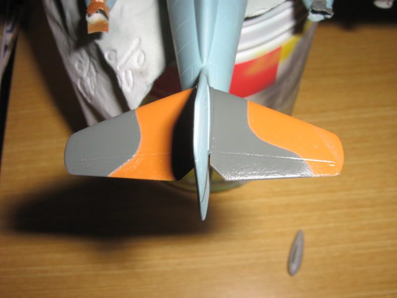

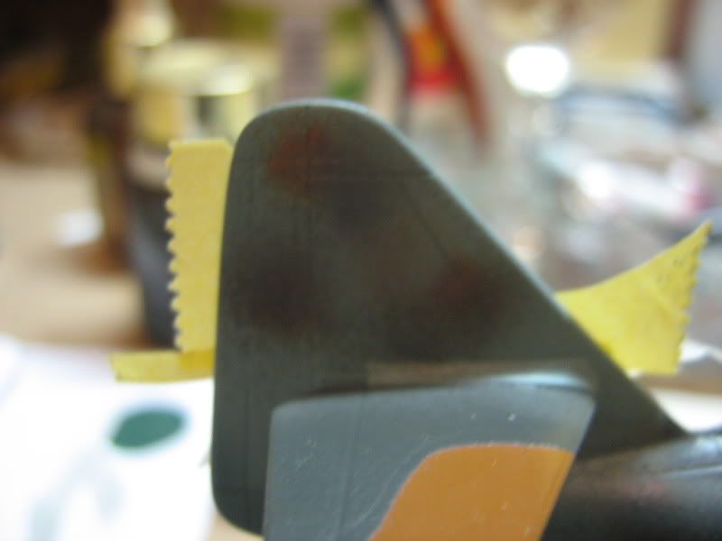

here we can see the sand brown on the tailplane...it's gloss paint and so will take some time to dry...I'll leave it alone for a few days and then do the grey
Allan in Canberra

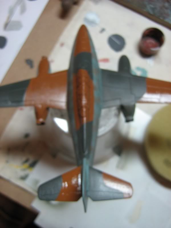

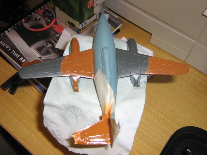

Allan

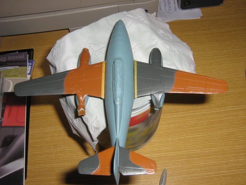

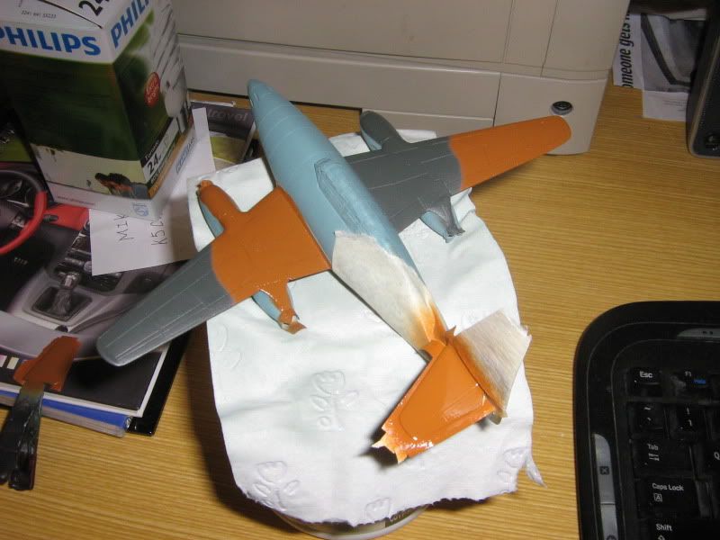

here she is with the tailplanes painted, but unfortunately with not much of a feathered edge between the two colors--not sure what happened here--maybe the nozzle of the airbrush was too close to the edge of the tape, but I'll live with it

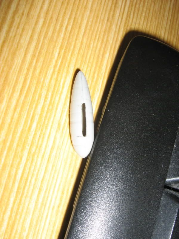

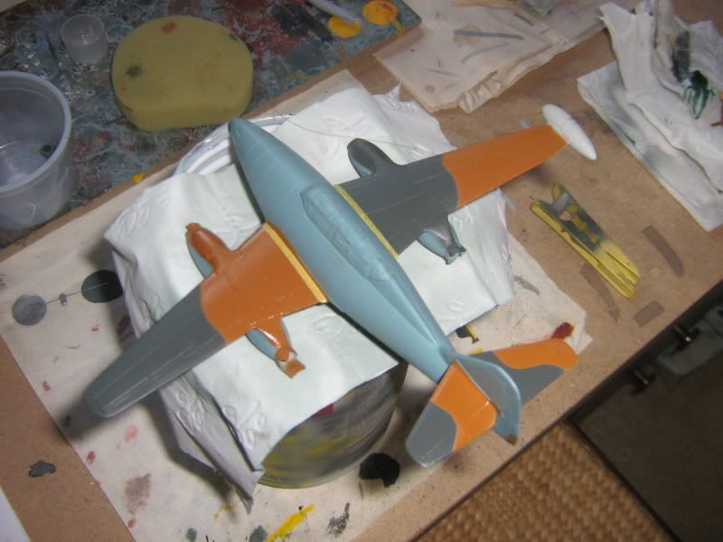

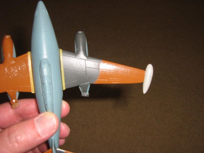

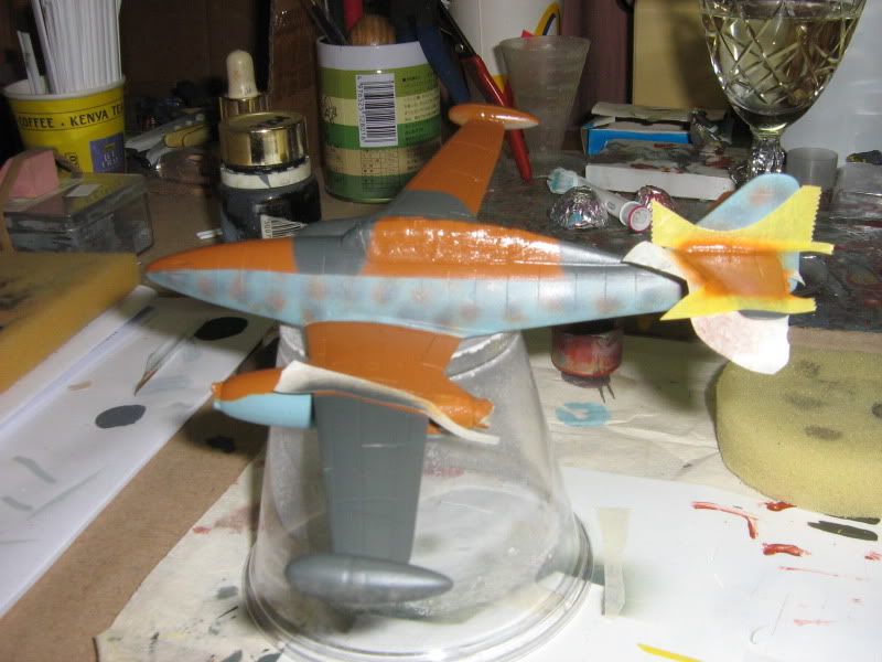

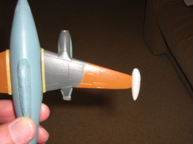

now turning to the wingtip fuel tanks, I've got two to attach and they come from a 1/72 Me 109--as you can see I've dug a slot in the tank to slip over the wingtip and will fill in any gaps with putty and repaint, but I'm undecided as to cement them in position so that there is outward splay or parallel to the fuselage--what do you think?
Allan in Canberra
matrixone
Parallel to the fuselage.
If you want a feathered edge between the camouflage colors just spray one of the colors along the demarcation lines.
Matrixone

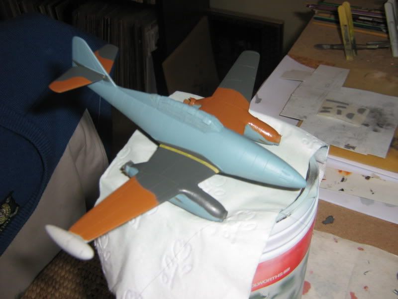

here's one of the wingtanks in position and sanded--the other is waiting for the glue to dry

Allan,
Its not hard to soften up the edges between colors , for example if you choose the gray color keep your spray pattern aimed more towards the gray areas already painted and only a hint of the gray will be seen on the tan areas and will make the demarcation line look softer. Another thing that will help you is to thin your paint slightly more than usual, remember you are not trying to get good coverage like if you were painting a base coat and in this case you would want your paint to not cover that well. Also thin paint will atomize better and not leave those grainy looking paint spatters.
For most German stuff (and even a few Allied planes) they were not always as neatly painted as most modelers paint their models and a little mistake in painting can actually make the model look more like the full size machines.

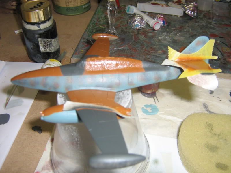

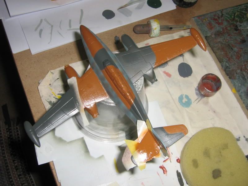

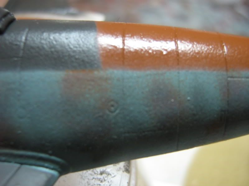

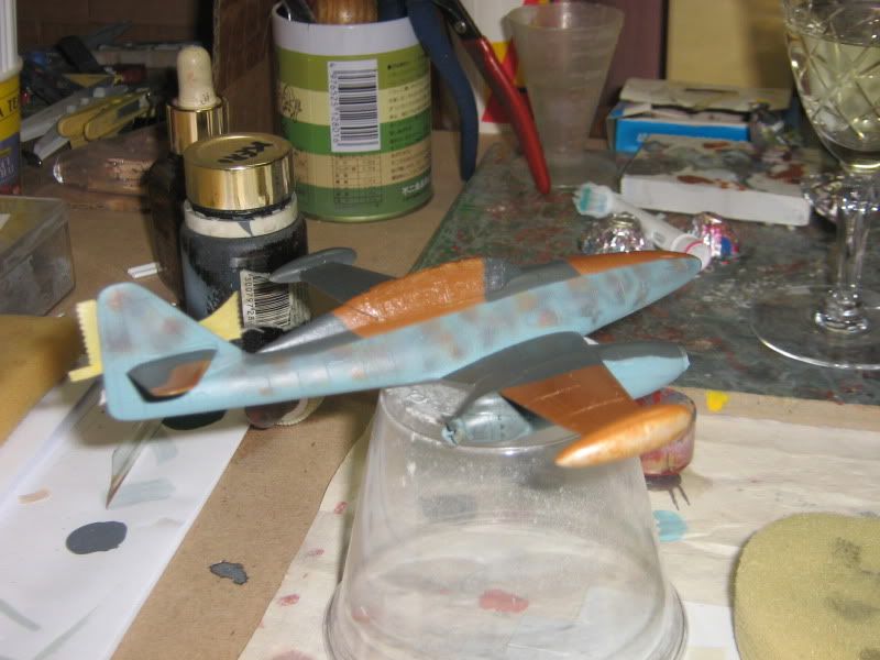

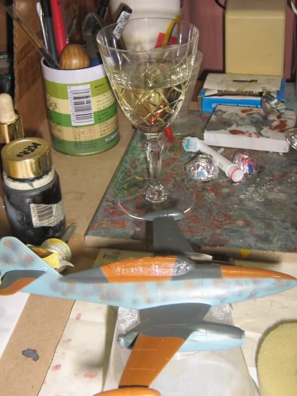

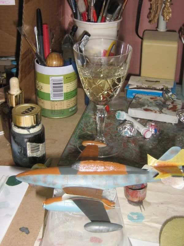

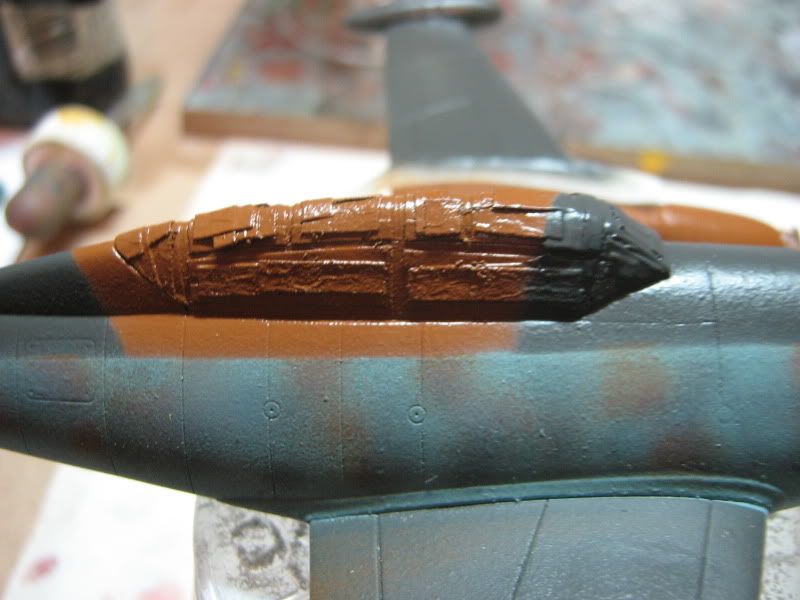

Here're some more photos--not much to say at the moment except that overspray is my bugbear
I oversprayed the mottle with some very thinned light blue to tone them down somewhat

Allan,
After looking at your mottling it looks slightly grainy, what that means is your paint was slightly to thick or your air pressure was way too low. Next time thin your paint a little more to get rid of the grainy spattered effect, trust me, it works! ;) You should not have to go back over the mottling with the light blue, your Iwata can easily spray mottling in 1/72 scale if the paint is thinned enough.
One thing I should mention is to not mix up your paint and thinner in the color cup of the airbrush, mix it in a small container and then pour the paint in the color cup. I don't know why but every time I mix my paint and thinner in the airbrush color cup I can't get the airbrush to spray fine details cleanly no matter how thin the paint is or if I added the thinner first and then the paint. :unsure:   I always have the best success mixing my paints outside the airbrush and then pouring the mix into the color cup, I bought a package of tiny plastic cups for mixing my paint and thinner in.
