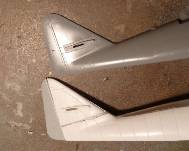

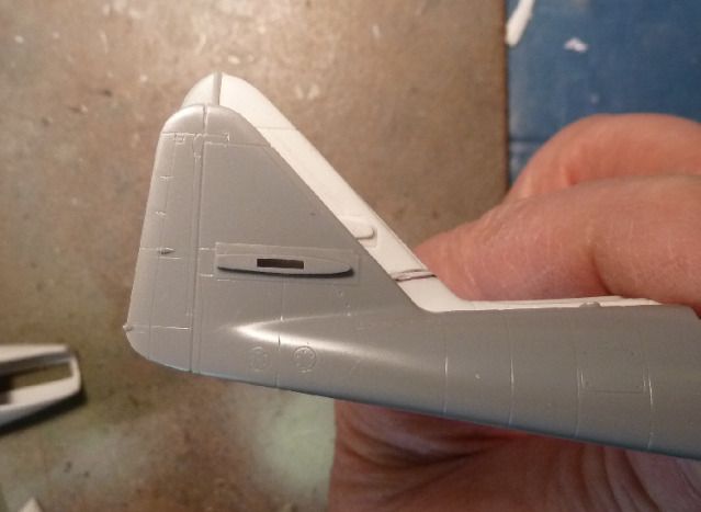

I felt I needed a SLIGHTLY larger tail for the 2262, so combined my two Jo-Han Me-262 tails by cutting them (diagonal cut-line visible, gray Hasegawa 262 tail for comparison) and adding them together vertically. Then I chopped off the rear (rudder) and put a tall Ar-234 rudder there---PERFECT!
Next, you can see in this "overlay" that the 2262 (white) tail is slightly taller and broader, while keeping the 262 shape, and the horizontal tailplanes will be just a scosh higher as well. I will be using the Frogfoot horizontal tailplanes with Jo-Han 262 tip additions.

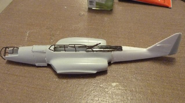

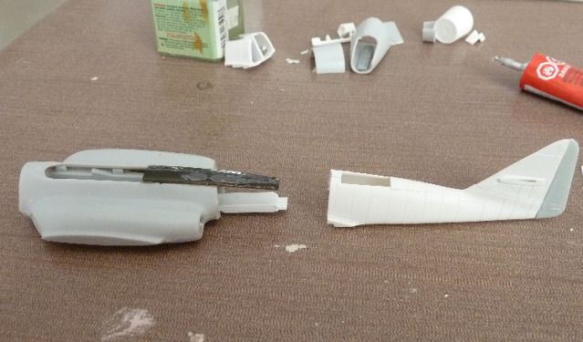

I  knew my fuselage would be a "witches brew" of chunks of various Me-262s and other parts, but little did I know that a 1/48 trashed P-51 would also come into the mix. I also knew that I would have to "butt-joint" sections, so here is illustrated the "tab" supports to help connect the parts for strength (an old vac-form trick that works here, as well). The dark brown curved strip from the cockpit rearward is the top-rear fuselage of the P-51.
I experimented with various non-tapering forward "extensions" (actually, you might see them in the pic above) and settled on the cockpit-forward portion of the glass-nosed MPM 262, with some modifications. In the pic below you can see how they all came together (and a crude canopy and rear-defence gun is drawn in). NOW I gotta LOT of grinding-down, and "PSR" building-up to do to unify them, but the shape/length is THERE!!

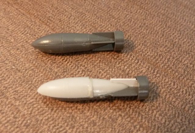

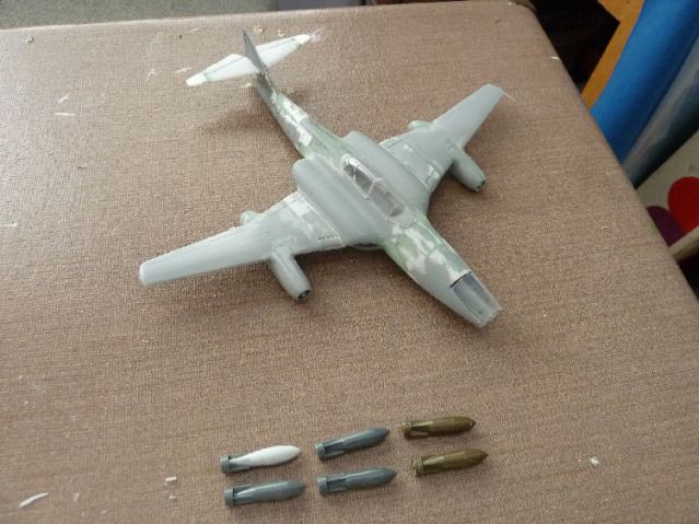

To complete my "lactating Daschund" look, I needed six pylons and six similar bombs (three sets of two bombs, Sturmvogel-style). I had found five identical SC 500's from some Italeri He-111 kits, and was looking for the sixth that I *KNEW* had to be around somewhere. All I found, however, was ONE HALF of the correct bomb and the tail ring. The other half of the bomb was missing. GRRR!
So, I had to CREATE the other half. I found a fuel-tank half that was similar shape, had to section it down a bit for length (still not identical shape, but oh-well!), then carefully cut some .010 stock for the fin, and voila (the two bombs are identical in size; only the photo angle makes my "fake" one appear larger)!
I will clean up the contours a bit, then mount the "imposter" bomb on the rear pylons (hardest to see, under the rear fuselage) and "point" the fake side to the middle where it will be hard to notice with the other bomb in the visual way. One of my "successful failures".
Part of successful whiffery is to mask or de-emphasize your flaws!!  ;D
>Looks promising indeed!<
Thanks. I have "assembled" most of the components for an interim "portrait". The clear nose cone is not there, but you can see what this "Schnellerbomber" is going to look like--kind of like an Northrop F-89 "Scorpion" with extra wing jets.
