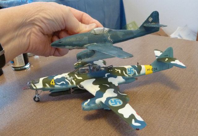

Here's an old "beater" Me-262 for size comparison. The 2262 is very "lean", almost "scrawny", but then so was Bruce Lee!!  The additional fuselage length comes from using the center sections of other models as extensions. That is, the front section is the "glass-nosed" MPM version from the nose to the rear of the cockpit area ADDED ON in front of the cockpit of the HG III model. The rear fuselage is the cockpit-to-tail of a Jo-Han Me-262 added on AFTER the HG III cockpit ended. Of course I had to "fill in" the open cockpit areas of those kits. Note the "Kick-A$$" emblem of TLeV 12.

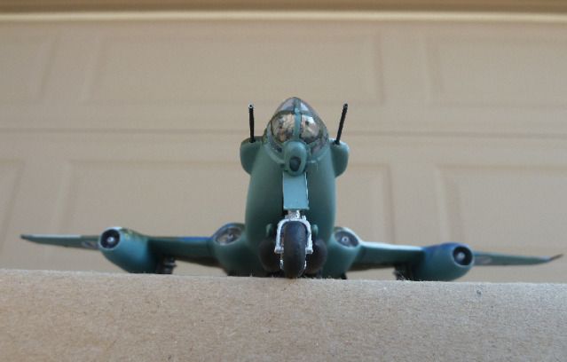

Here is the front end. The "mystery probes" (the purpose of the real probes on the real glass-nosed version never explained) on either side of the glass nose become 12.7mm guns. Had a heluva time getting the glass nose to fit (it doesn't--a bit too small a diameter for the solid part of the nose, though NO alteration to the original kit was done there!), and acquiring and shaping the "gondola" underneath so it has a clear center for the bombsight.

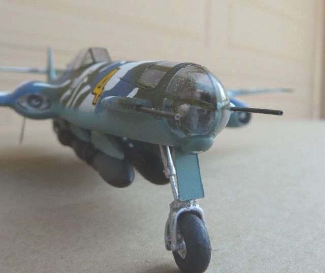

Here is a closer look at the glass nose. The brown helmet of the bombardier and his right hand are all that can be seen of him in this photo. The bombsight has a forward view and a downward view. Note the true, cylindrical MG's made of stainless steel tubing.

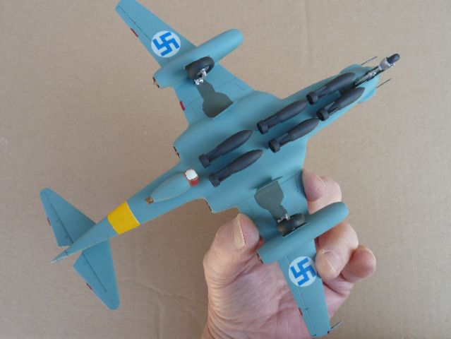

Then here is the whole underside, showing the rows of bombs, and the RATO unit with its colorful parachute! And my "faked" wheel wells of decals in the right color and shape (but of course--no depth!).
