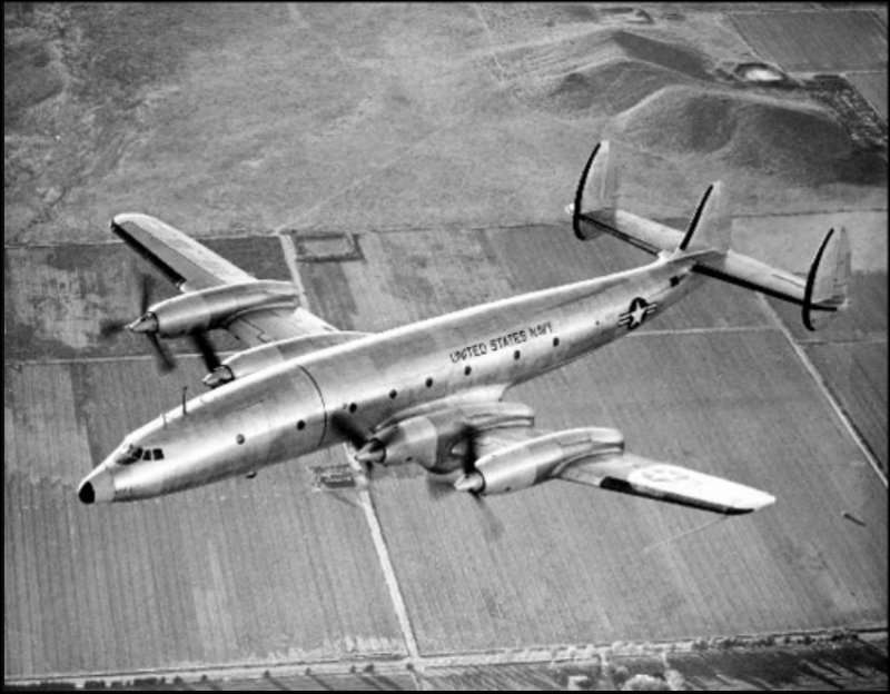

Lockheed made a turbo-prop Connie in the 50s.
It was based on the L-1049 Super Connie and was called the L-1249. They built at least 2 of them IIRC and they were powered by the big T-34 engine that was also used on the C-133. Apart from the Starliner  :wub: I think the L-1249 was the best looking Connie variant ever.
(Quoting the source file 'This photo has no known copyright restrictions........)
