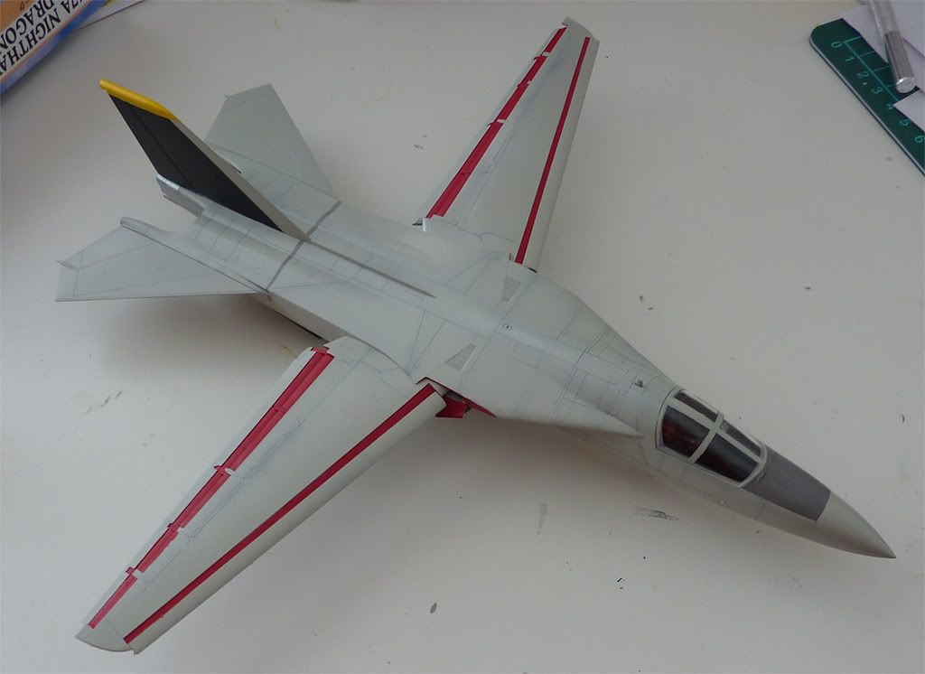

My latest progress. It's also my first time use of air brush. Not as easy as I thought... I followed the Hasegawa F-14 colour scheme, only to realize that the scheme was for pre-90's and the grey is gloss  :(. I think the later Tomcat has a darker shade of grey.

FIRST TIME  :o :o :o Amazing job mate! that is one beauty of a model!  :cheers: :cheers:

Scheme looks great to me. For a `first time` job, that is excellent work. :thumbsup:

Great first airbrush job Firefox  :thumbsup:
But worry about the gloss grey, you could always shoot a coat of future for decals and another to seal them. If you do, let the future cure for at least 24 hours before decaling and at least 12 hours for the decals to dry before sealing them.

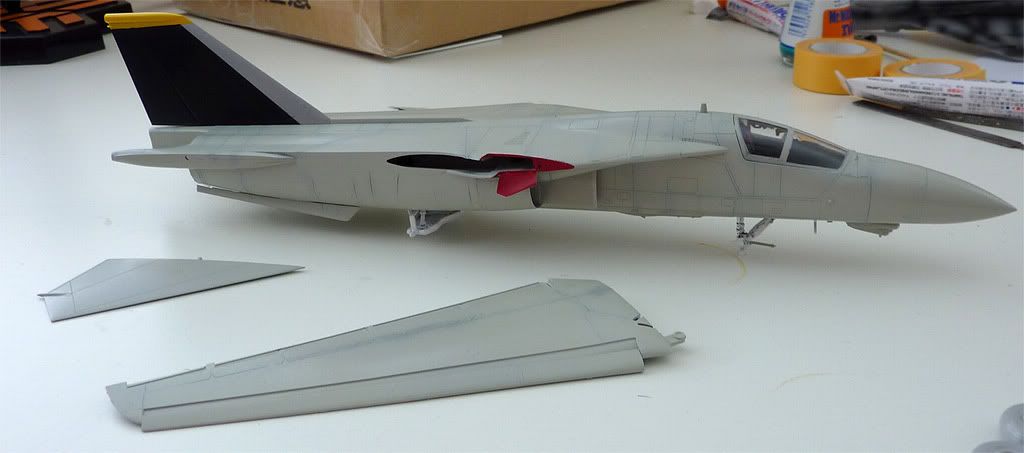

Almost there... Thanks Steven. Would clear coat harm the decals? Don't think I could find future here.

 :o WONDERFUL! WHIFFGASM  ;) Maybe the first "Whiffies" entry for 2012?  :drink: Unless you can pull it off in 8 hours (or 32 depending if you live in some far off place  ;D)

QuoteWould clear coat harm the decals?
If your decals are dry, no. The clear coat should not harm the decals. No future, most model paint companies makes a clear gloss of some sort. I like to lay down a gloss coat before I start decaling. (Decals like smooth glossy surfaces ;) ) Next I apply all my decals and let dry for at least 12 hours. Then I seal them with another gloss coat to protect them from a panel line wash. Then a final flat or gloss coat. Hope that helps.
She is looking pretty cool!

Firefox, knowing where you are would help ; however, if you're in Australia, we have "Pledge One-Go" which seems to be pretty much the same thing as "Future". :thumbsup:
