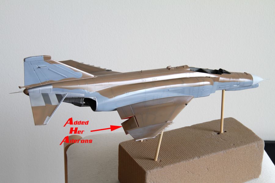

FAR148

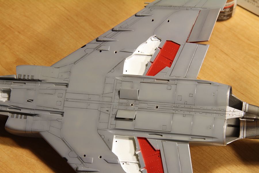

Well now that summertime/airshow season is over, It's time to get back into the hobby room. Here's a small update. I finally painted her wheel tubs, added her ailerons and gave her a few coats of Future.
Going to let her gloss coat dry for a few days before giving her panel lines a wash.

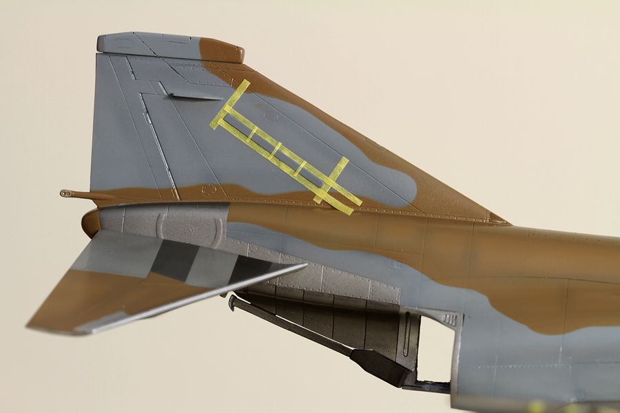

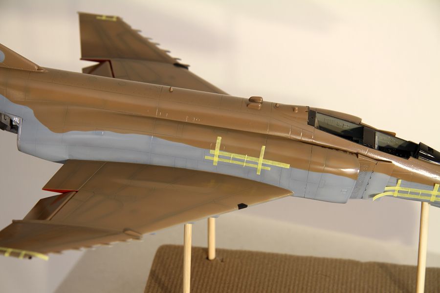

Here a little update, Got bored the other night and decided to paint on the formation lights. I masked off the formation lights on the nose, fuselage, wing and tail. Next I added a few drops of yellow to some flat white. When I was happy with the color, I shot a light coat on each light. They turned out nice.
Until later,
Steven L  :party:

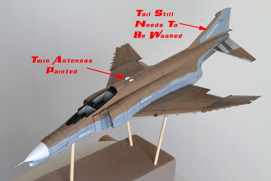

Here's another small update. Everyday this week I have been slowly washing her panel lines. I have not made it back to her tail yet but her belly in done. I also managed to paint the twin antenna behind the rear canopy.
More to come,
Steven L  :cheers:

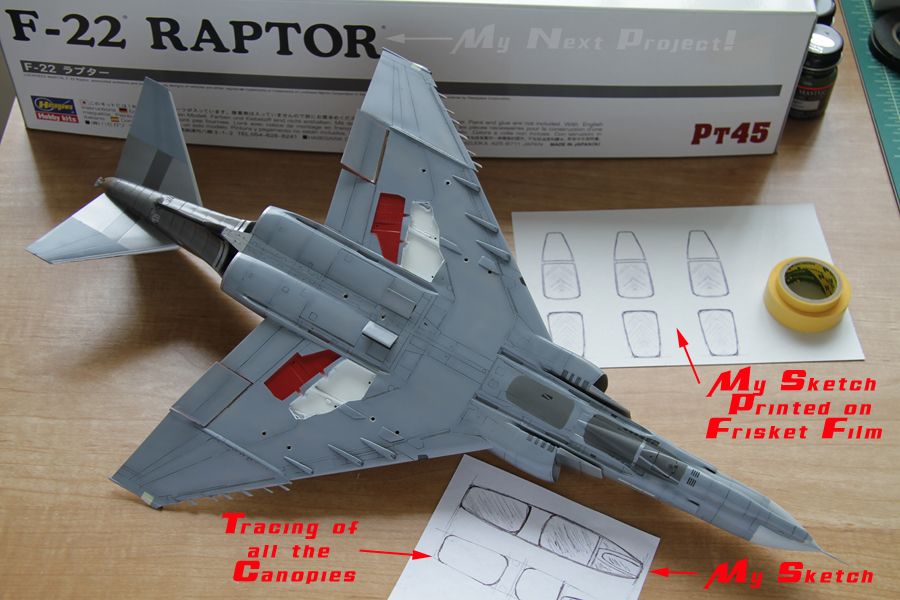

So I decided the other day to put a false cockpit on my Canadian girl. I started by tracing the canopies on a piece of paper to get the overall size and shape, which I was not to happy with. So I sketched an online that looked alittle better. Scanned into photoshop and mirrored it so that side to side it's the same. Then I printed it on some Frisket film and cut it out, tried placing it on the model .... :banghead: After fighting it trying to fit the mask in one whole piece, I cut the mask right down the middle and  :thumbsup: . The only thing is the rear false cockpit is not as tapper as the sketch but I can live with it. Was the mask in place, I thinned up some MM Euro I Gray and gave her a light coat. Turned out pretty nice.
