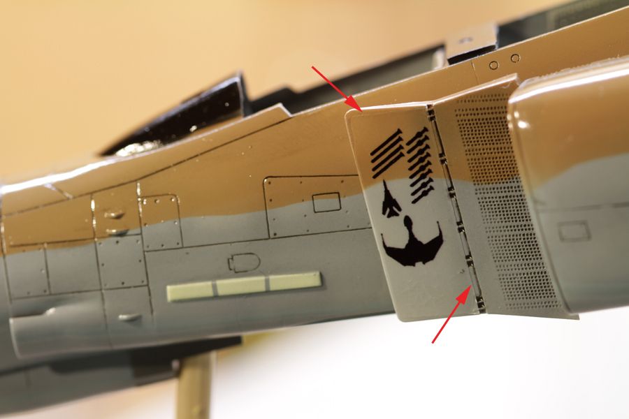

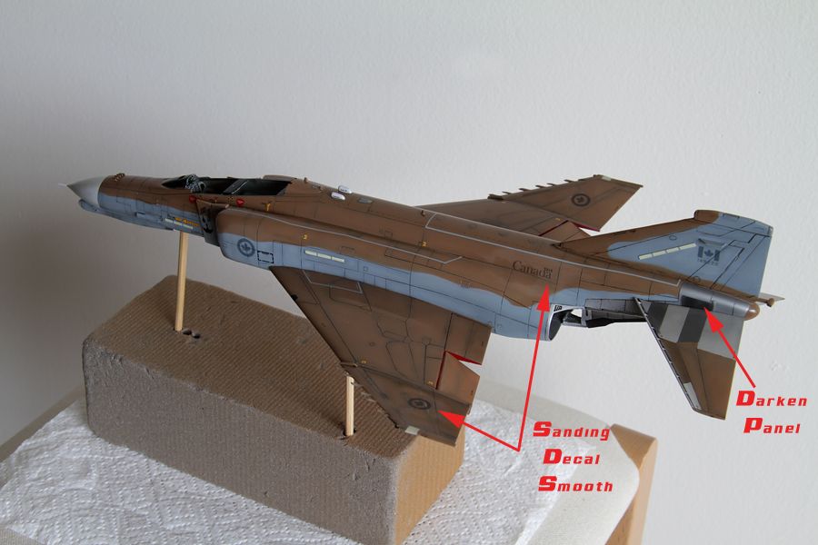

Decaling is done but....since all the Canadian marking are homemade decals, they are much much thicker than aftermarket decals. (Had better luck than with my RAAF RF-104 decals) The edges are not feathered out like aftermarket decals. There is a sharp and noticeable step at the edge of the decals. In the pic below, you can see the sharp edges.
I cut the decal so that the rear edge is kind of hidden at the panel line but the top edge has to be fixed. So, here's how I fixed it. Decaling was done last weekend and all week long I have been slowly building up multiples coat of future (just brushed on) around the sharp edges. Once I had enough around the edges and was fully cured, I sanded the edges smooth using 3M Softback sanding sponges. First I used Ultra Fine(blue) then came back over it with Mirco Fine(Green). If you have enough coats of future on the edges, when your done sanding the edge should totally disappear. The areas where I sanded looks frosted but will be glossy again after I reshoot them with Future. Also I darken the panel where the elevator is conneted to the fuselage to help break up that all one metal color.
