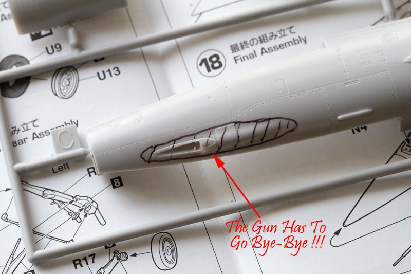

Since this is a photo recon bird, that means the gun got to go.
With my Dremel I remove just the gun and the bulge behind it.
