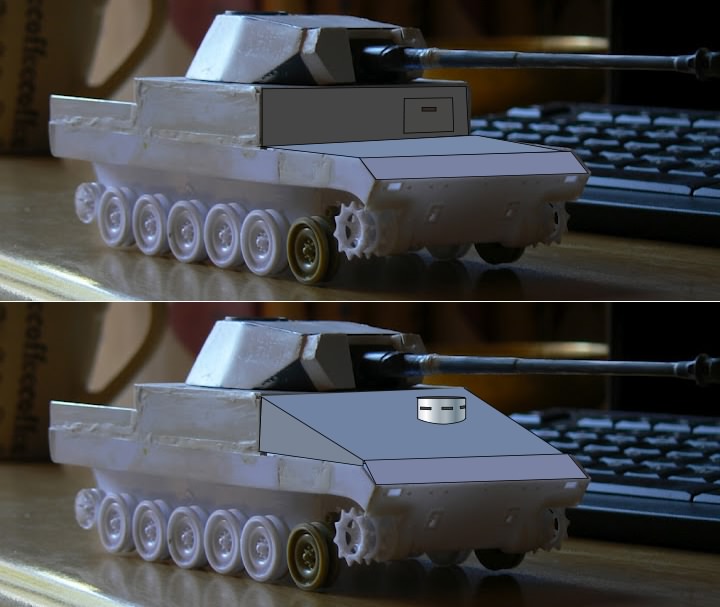

For the driver's hatch, two ideas:
- flat, forward opening hatch, as seen on some early war tanks, like this: http://www.flickr.com/photos/barryslemmings/4792449995/
- Add a sloped glasis plate, then add a cylindrical driver's tunnel with a hatch on top; similar to the "pulpit" on an M7 Priest.
Sort of like this quick and dirty edit I did of your model pic:
Or a combination of the two - sloped glacis with a flat, upwards opening hatch.
The angular version works best as it is in keeping with the rest of the tank.

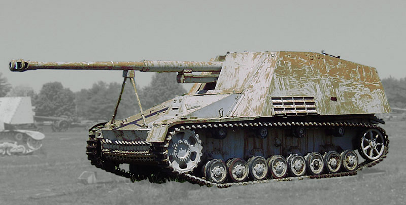

Can I suggest a third alternative?  late Marder IIIs and early Nashorns/Hummels on some versions had a "penthouse" style driver's compartment on a sloping glacis plate.   While in the Nashorns/Hummels this was eliminated as the war progressed in favour of a driver/co-driver compartment which stretch across the glacis, it continued in the late Marder IIIs.  It would be easier to manufacturer than your curved driver's compartment and theoretically stronger (curved plates are weaker than flat ones). This is what I mean:
Such a penthouse allows for a sloping glacis - inherently stronger and thicker (in real terms) although it is more difficult to manufacturer because a hole has to be cut in the sloping glacis and the penthouse fabricated but it is stronger than a curved plate.  However, both the penthouse and the curved plate you've proposed introduces a weak point in the glacis itself by needing a hole to be cut into it.
Another alternative, which removes the disadvantages and confers advantages is the Panther/Tiger II approach.  A sloping glacis which may be slightly steeper but allows a separate drivers compartment.  The driver is provided with periscopes, rather than a direct vision slit.  This removes the weakness of the penthouse/curved plate and still makes a greater effective thickness of glacis plate by sloping it.   So, perhaps instead of having a stepped upper glacis, as you have in the second photo, continue the lower of the two upper glacis plates to its natural height as a single angle (if that makes sense) and then place a horizontal flat plate extending forward from the superstructure to form the driver's comparment.   This would also allow either a co-driver or the additional space to be used for ammunition stowage.

mkhulu
Ta all for the ideas :bow:  :thumbsup:
Going the Marder route .
