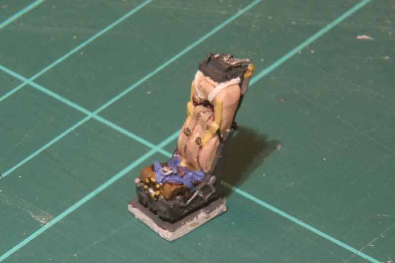

2. Ejection Seat. Painting's all done, just needs overhead handles making from wire now. I don't see why Pavla couldn't supply these, given that they've moulded the one on the front of the seat pan just fine... :unsure: I only cut half the moulding plug off, the intention being to mount it direct on the nosewheel bay, but I then realised it could go a bit higher, hence the built up cockpit floor.
