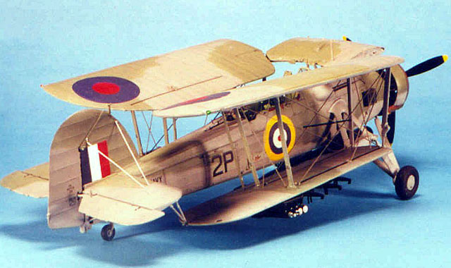

"with a small team holding the wing from it's natural tendency to swing rapidly inboard, it was slowly folded back until the tip was level with the tailplane leading edge. A V-strut locked beneath the tailplane was released and the spring loaded hook at the end of the strut was attached to a shakle on the wingtip handgrip bracket, thus securing and locking the wing in the folded position"
#3
Here's a pic of the Tamiya kit built folded, showing the V-strut hook:
From here: http://www.hyperscale.com/galleries/2001/swordfishtc_1.htm
Also, you can just see the strut in the stowed position under the tailplane in this photo here: http://www.airliners.net/photo/UK---Navy/Fairey-Swordfish-Mk2/1990505/L/
Not sure, but I suspect that the new Airfix kit will have the same bits as there's a wing folded option in that.
