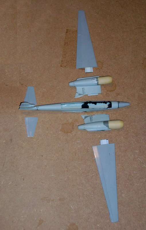

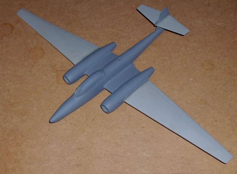

While re-starting on the PR19b for Operation Cosford I figured I may as well do the first version at the same time, it couldn't be that difficult a task. Well, not much anyway....

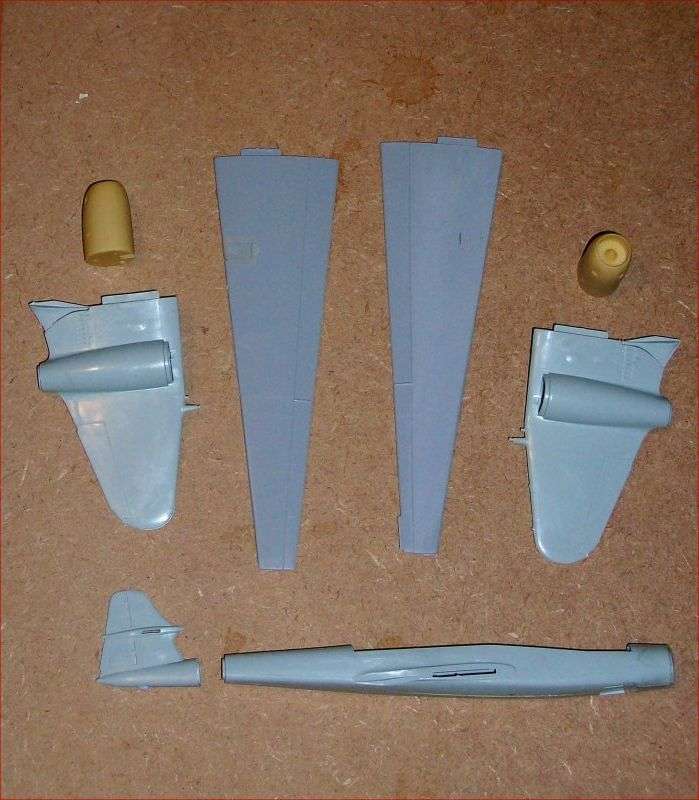

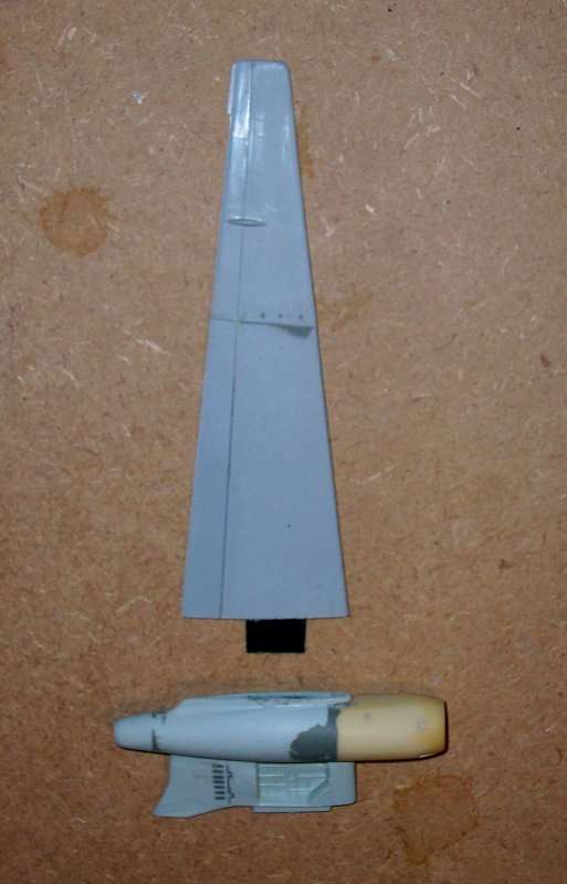

As usual with the previous PR19 variants the fuselage is a Matchbox Meteor NF14 with the inner wings and engine nacelles fitted as normal. The resin intakes of the engines come from the DB conversion kit of the RB-57D Canberra, and are the same J-57s as powered the original U-2s. They're almost the same diameter as the Meteor's Derwent nacelles but not quite, and this meant I had to build up the surface of the Derwents to match with some styrene strip and the usual PSR work.

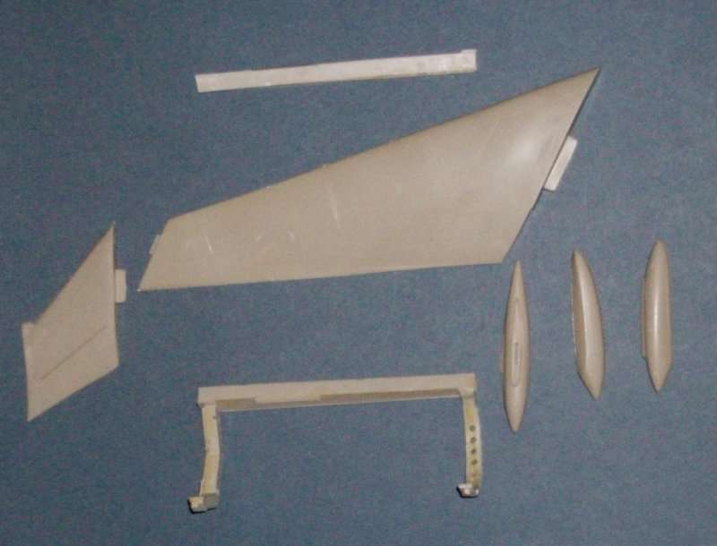

The outer wings were obviously from the Airfix U-2 kit shortened to suit and with stub spars glued into the roots to slot into the Meteor wing sections. The tailplanes also came from the U-2 and were just butt jointed to the fin fairing after trimming to suit the curved joint profile.
The backstory says the nose of the PR19 was the same as the PR19a that I'd already built and after sawing off the front end of the M'box kit I added the nose of the U-2 but inverted so its windscreen notch fitted around the nosehweel bay of the Meteor. Neat, eh? The problem came when I remembered how I'd done the recce camera bulge under the nose, as it came from a Hasegawa (IIRC...) RF-4C kit that I had many years ago, and I didn't want to fork out for another, especially at their current prices! Luckily Gondor came to the rescue with an offer of not one, but quite a lot of these parts, thanks again Gondor. It seems that every Hasegawa F-4 of all variants comes with the same clear bits so now I have enough to build a squadron of PR19s!
The aircraft looked a bit plain after all the bits and bumps on the other two variants so I added the standard belly tank and drilled a small intake either side of the front of the tank to replicate the nuclear test sampling pods that I'd mentioned in the backstory. I added some early mark MB bang seats and some other bits and pieces before I did the business on that ruddy awful fuselage top part before the usual PSR session.

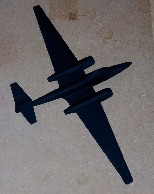

Final assembly needed some jigging, as with the PR19b, to get the anhedral correct and equal each side and then I primed the whole thing after masking the canopy. When that was dry I sprayed the whole thing black and gave it numerous coats of Klear before adding the decals. The wing 'no step' areas took some doing as my Airfix U-2 decals had yellowed badly so I formed them from miles of Xtradecal white stripes, and the roundels came from the excellent Modeldecal sheets. Just the codes, home printed serials and squadron badges and ejection seat triangles completed the job before some more Klear and a coat of satin varnish.
The less said about the landing gear the better.......

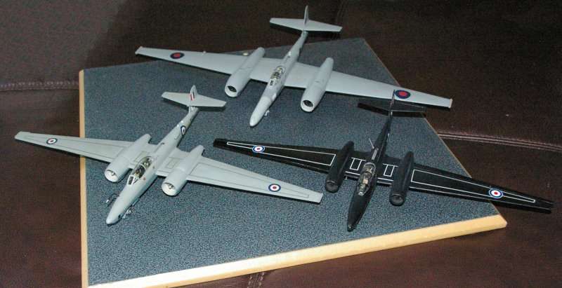

Anyway, here it is, the last model of my three PR19s to complete the set.

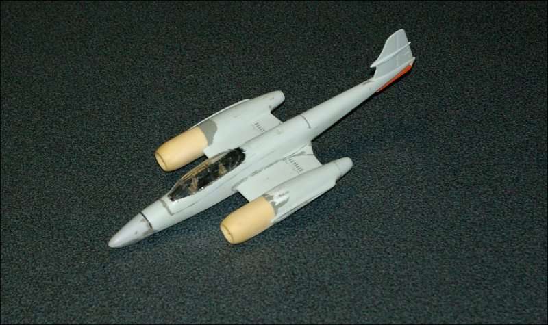

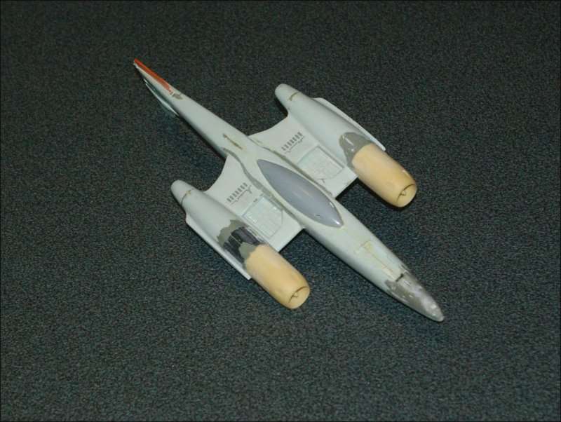

Oooooo NICE!!!!  :wub:  That would have certainly given the U-2 a run for its money.

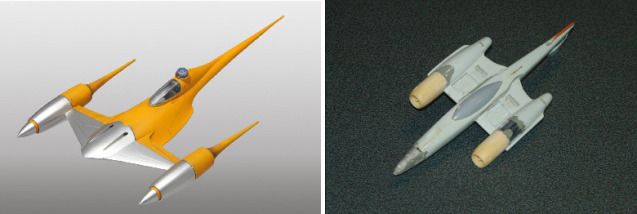

Does anyone else look at this shot and immediately think Star Wars/Pod Racer/Sci-Fi craft?!

It certainly does have that look to it, alright! ;)
RussC
It could even make a cool submarine in that form, something out of SeaQuest DSV.
There are 3 of them now, troika coolness!

Hm yes, now that you mention it there is that sort of look to it. Add wheels and it would make a half-way decent LSR car too!  ;D
And I have LOADS of M'box Meteors in The Loft, and even another set of J-57s too. Vacform a clear copy of the belly tank and we could be onto something here......  :lol:
Lovely stuff Kit - that's quite a collection!  :thumbsup:  So what learned journals and "authoratitive" websites are we going to find the new ones on eh?  ;) :wacko:
Cliffy - guilty as charged - I saw the "spacefighter" immediately too! How about using two sets of wing lowers glued together, so that the undercarriage bays go right through the "wing" with the edges greeblified?

Very nice....love the onr in the middle. I was thinking sci-fi in the upside down/ wingless pic myself. Or a drone !

>Does anyone else look at this shot and immediately think Star Wars/Pod Racer/Sci-Fi craft?<
No resemblance AT ALL! Nose too long, etc...... :wacko:
Quote from: sequoiaranger on April 06, 2012, 08:54:11 AM
Give me time, just give me time.........   ;D ;)
