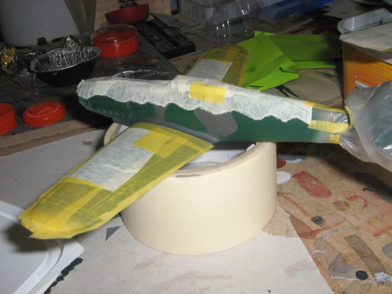

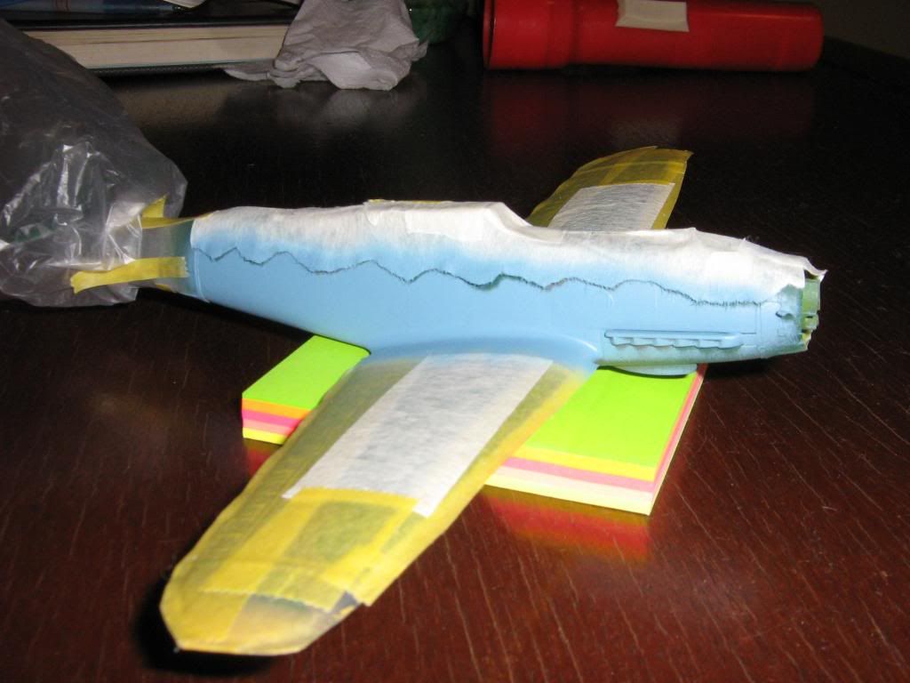

here're some more piccies ....the new 109 masked and ready for that matt Humbrol paint

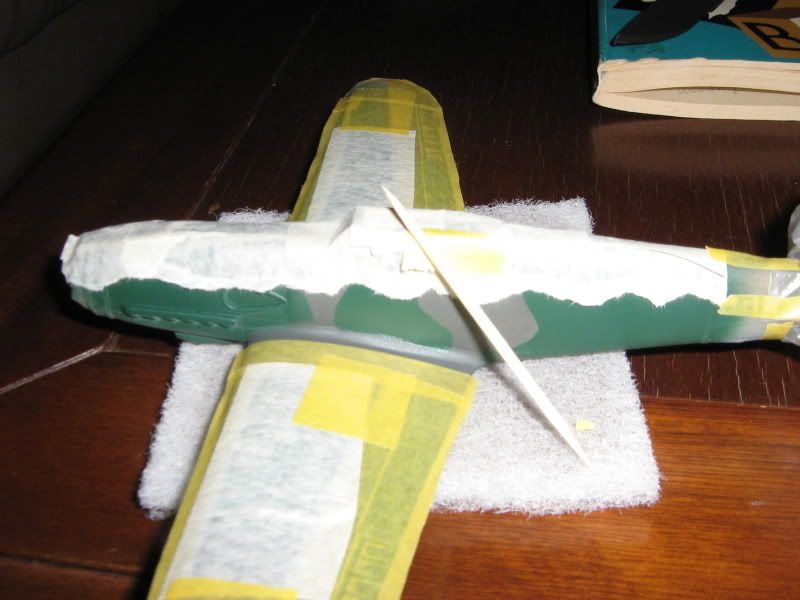

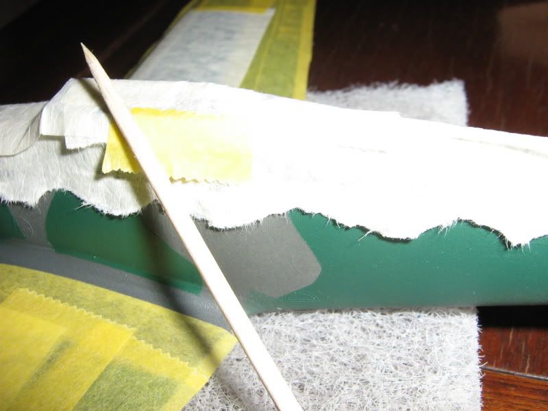

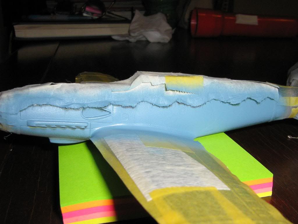

here's how I lift up the tape with a toothpick to achieve the feathered edge

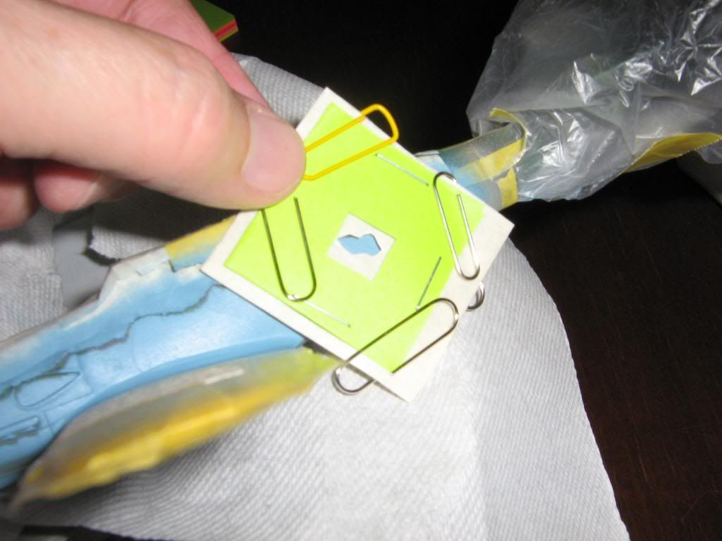

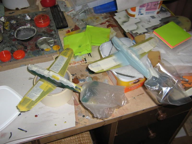

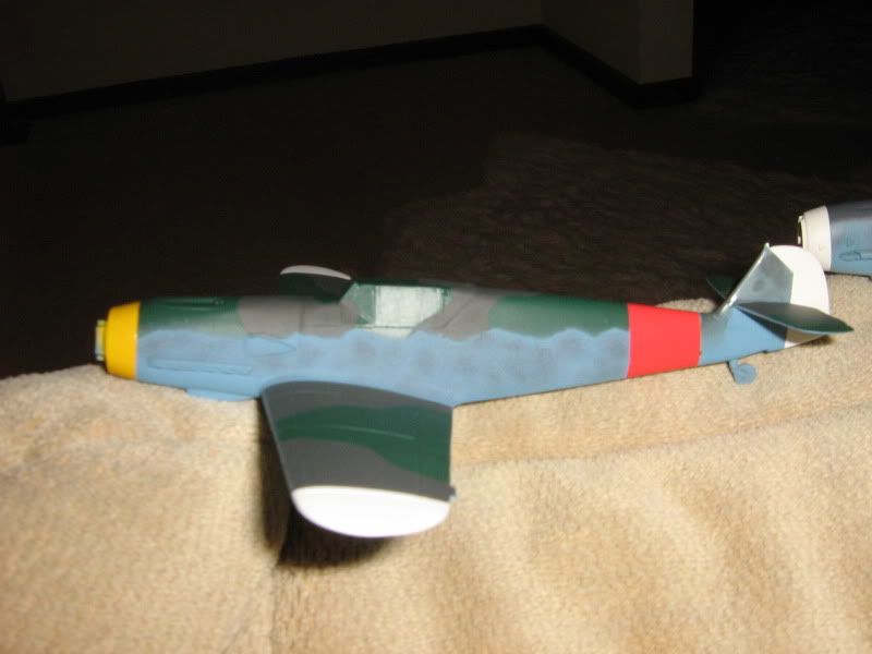

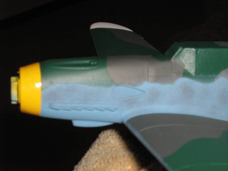

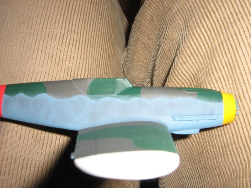

my first attempt at mottling failed (paint too thin) and was too amateurish to show you so I've painted over it...on the other 109 the matt Humbrol blue went on very well...I've thought up a scheme to perhaps produce good mottling so please have a look...I may not even need the paper with the square cut out of it...I made it to prevent overspray

matrixone
Allan,
If your paint was that thin and looked liked it would not work in your tests drop the PSI down to a point to where it will work with your paint. If I had a choice between having paint being too thin or too thick I would rather work with paint that was too thin because its so easy to just lower the PSI to make it work.
I keep my air compressor within arms reach so I can adjust the PSI right away if it needs it.
Hope you keep working with your airbrush and try doing the mottling with it. Once you get the hang of it you will be amazed at how easily and quick you can paint a Luftwaffe scheme on your models. Using a mask for putting on the mottling is one way to go but doing it that way is a massive amout of work compared to doing it free-handed with an airbrush.

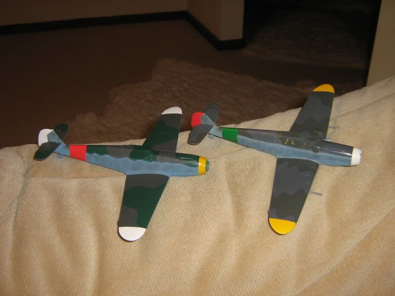

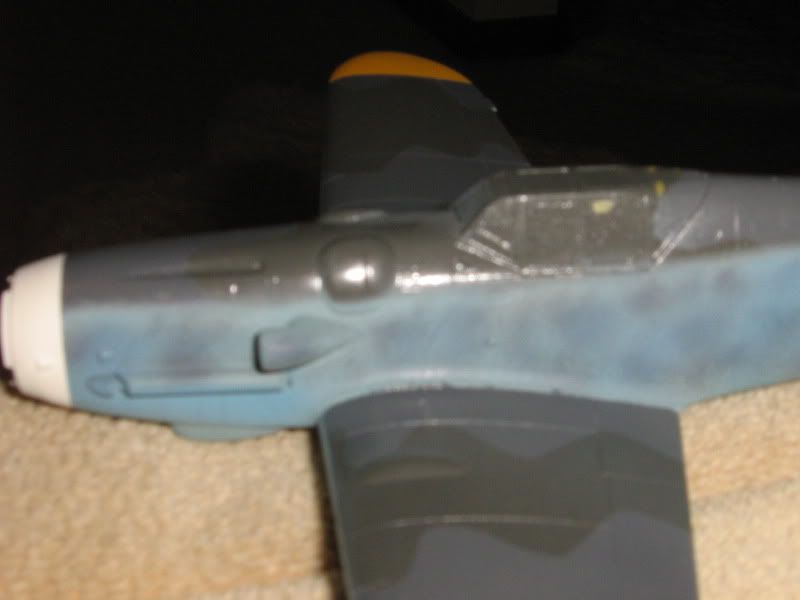

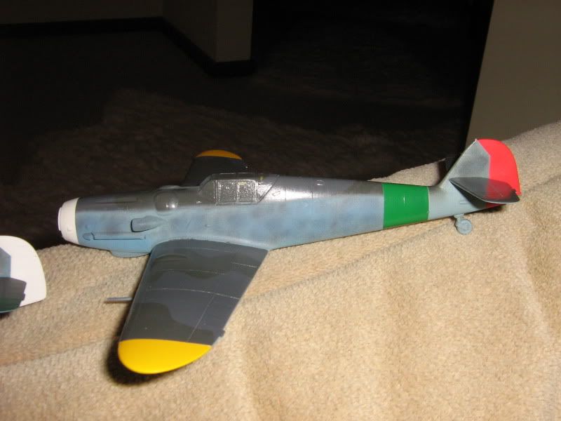

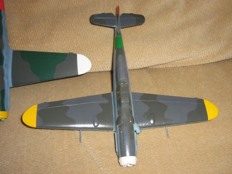

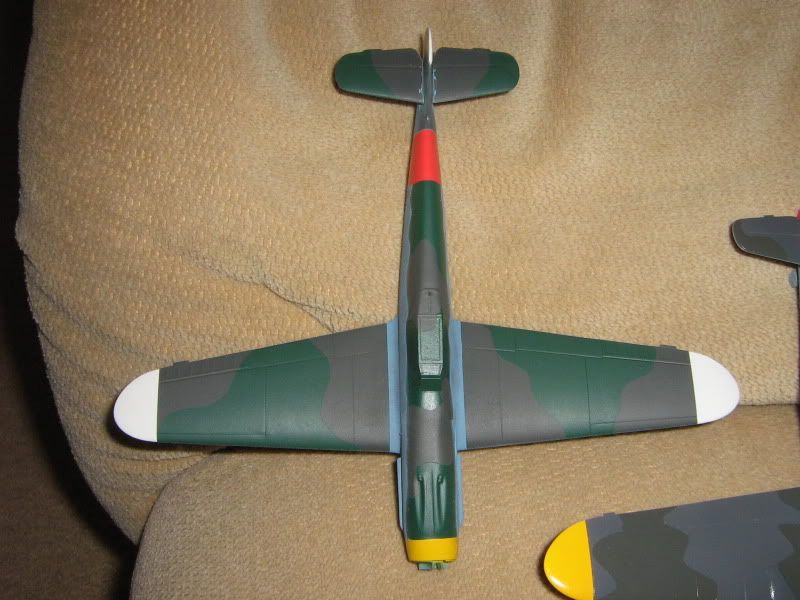

good advice as always Matrix..and taken to heart...well, here they are with sort of mottling applied and tape removed...really this is about the best I can do so next it's on to the decaling and weathering...on one of these two planes the paint has cracked here or there but maybe, just maybe, it won't be too noticable

matrixone
Looking good Allan! :thumbsup:
