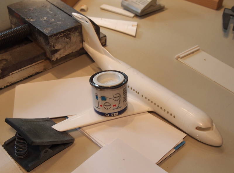

I've added the wings. Here's my alignment jig. Using business cards as shims to get the correct height, and a tinlet of paint as weight, this would keep the wing and fuselage in position while the glue cured.
Because I'd removed the locating pins from the wings, it took a few tries, but the wings are now in place.
Love the aliment method  :thumbsup:
Great work/improvisation. Exactly what I would do... just use what's around and make it work for you  :thumbsup:
Awesome work.....great use of everyday materials.... :thumbsup:

Yup, gives a great idea of scale as well

I love the clamp on the rudder! THAT will not move. Nice show of the scale of that kit. I had no idea it was so small. It makes your work on the gear even more impressive.
