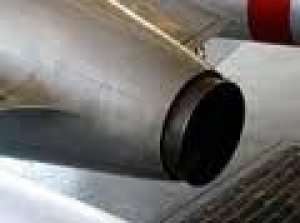

The Hornet was a very compact aeroplane, even its engines were specially designed by R-R to have the smallest possible frontal area, but once the exhaust gases were outside the airframe they were gone, ejected clear of the cowlings and off into the wild blue yonder. If they'd had a turbo to wriggle through before escaping the turbo itself would have got very hot and that heat wouldn't be able to escape, it would have been right there in the wooden airframe.
The Vampire had a much bulkier fuselage and the hot engine and exhaust went down the middle with cooling air around it. Looking in the back of a Vampire's exhaust you can see the cooling duct round the outside of the jetpipe. Plus the Vampire didn't have so much emphasis on small frontal area.
