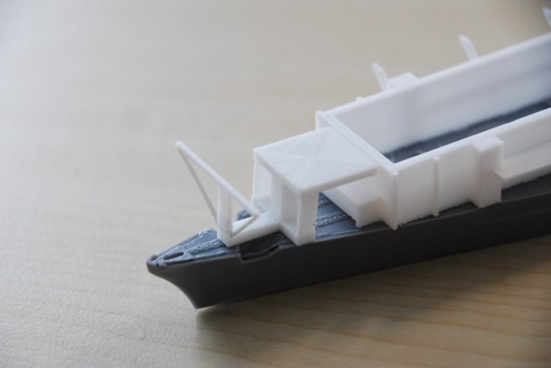

Finally, I got a working support structure for the bow. Had to enhance it a bit with hand-cut plastic sheets as I did not get the printer to print it as I wanted it to be. Now working on a structure for the stern.

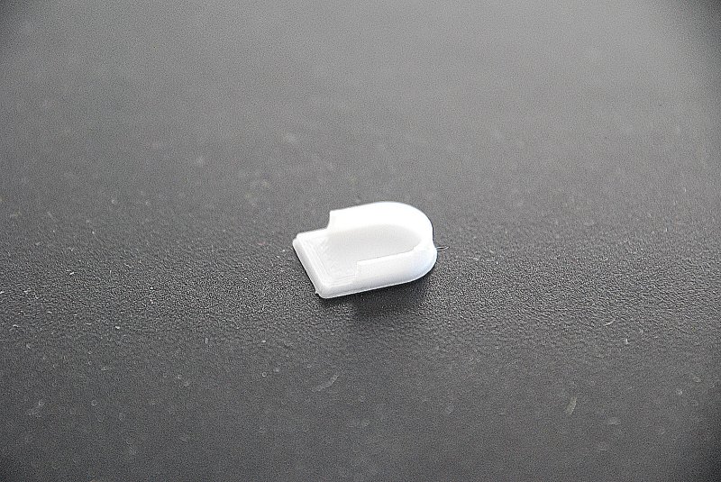

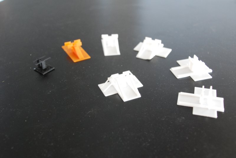

In the meantime, I made some mounts for heavy !! guns which can be added to the flight deck.
Testprint:
Added four of them to the flight deck, Plan is to put the 10,5 cm guns there later.

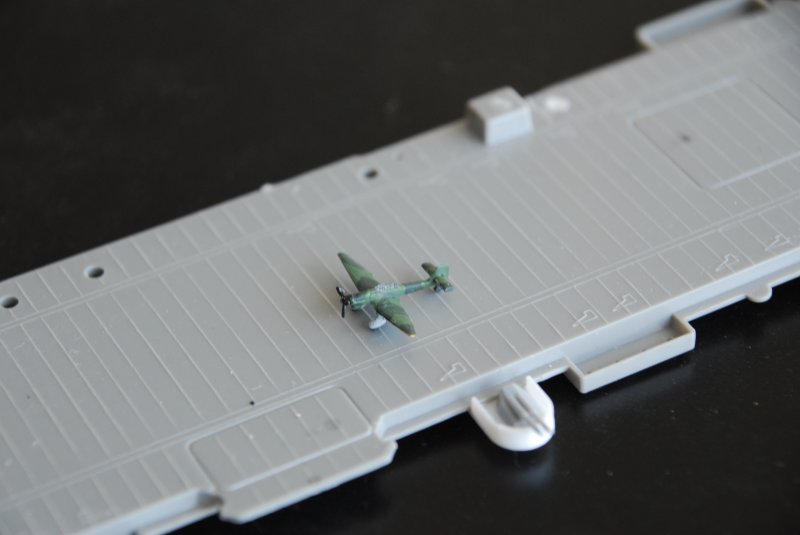

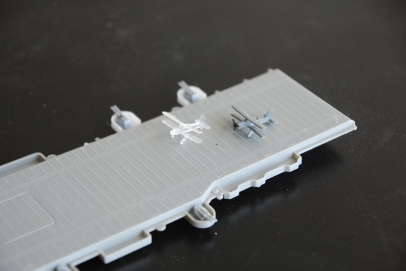

Some planes for the air wing have arrived. I first wanted to get some 3D printed ones from Shapeways as my printer cannot print such tiny aircraft. But i then got those three boxes quite cheap - 4,50€ per box.

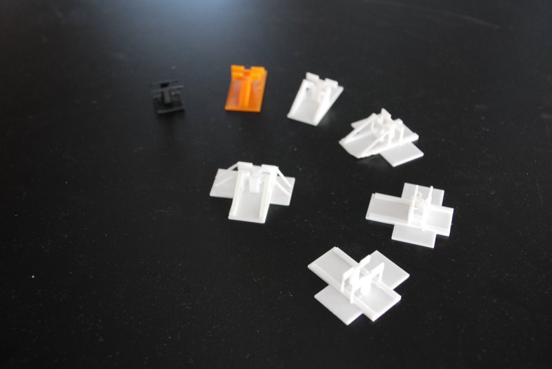

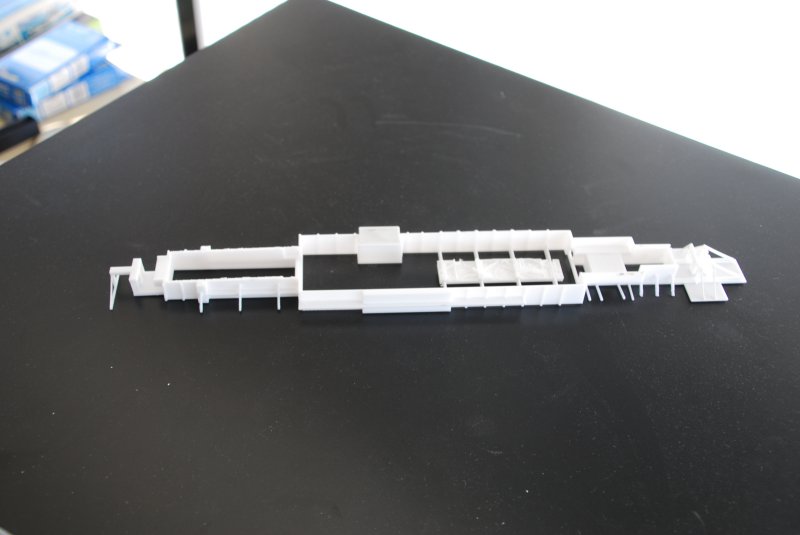

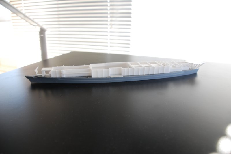

I finally managed to complete the support structure at the stern. Like for the thing I made for the bow, it could not be printed competently, the diagonal struts were added in the conventional way.
Here is the evolution of the structure element with various test prints until  i got it right. The one in the middle is the final one. Some are made with different color filament which was just in the printer at that time for other prints.
The complete hanger upside down. Parts can be glued with super glue or normal plastic glue.
Hangar on top of the hull:

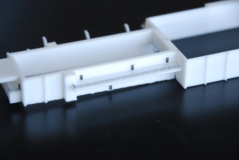

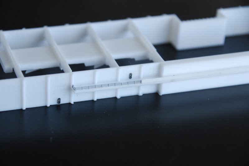

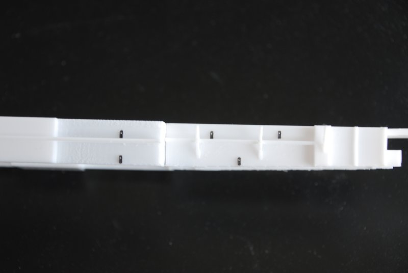

Before painting, i will now add a few PE parts to the hangar, starting with some doors:

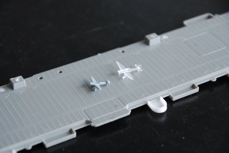

Those tiny Trumpeter aircraft are nice, but horrible to build. The Me 109 consist of 6 parts: Fuselage, wings, two wheels, drop tank and propeller. All to be added in this small scale. The wheels are tricky, i already lost three of them when they simply jumped away into nowhere....
I still have to build one of those Fi-167.

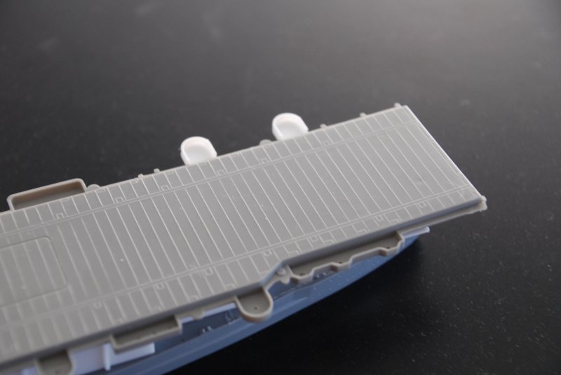

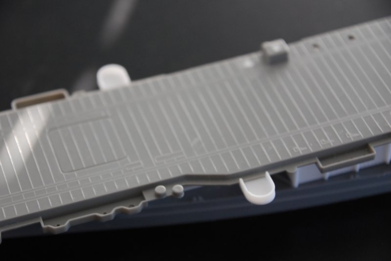

Work continued on the hangar structure by adding some more PE parts. But more or less its done now.
I still have no real good idea for the light AA guns. The PE ones from Voyager look quite good, but i have not found a shop where you could get them.

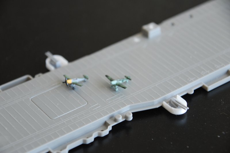

In the meantime, I added the heavy AA guns to the flight deck and continued with the aircraft:
Great work, especially with the P.E. and the aircraft  :thumbsup:
