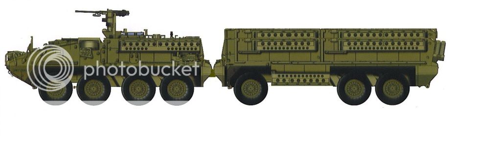

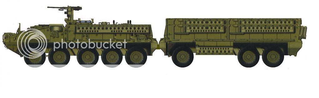

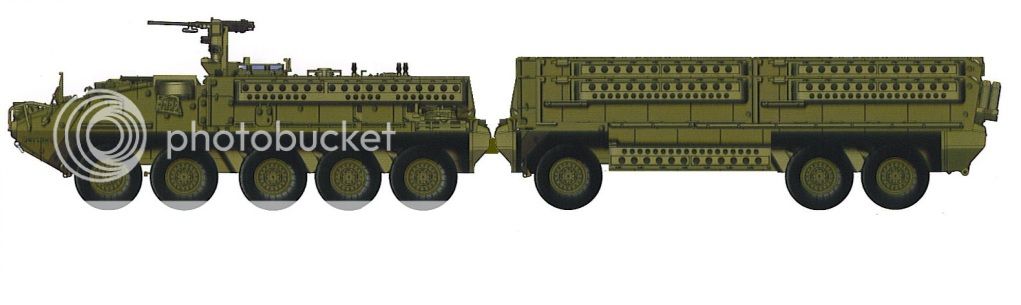

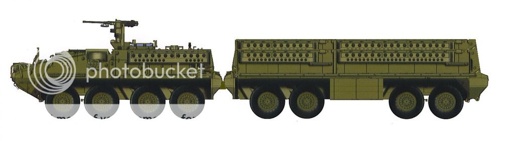

Some more playing with "Paint";
These are all ideas based on a modified up-scaled Volvo/BAe linkage. The shaft between the tractor & trailer incorporates a drive shaft from a 2nd engine in the rear of the tractor, & electrical & hydraulic linkages within an armoured tube. The joints at either end are protected by armoured housings to prevent direct fire to these weak-points.
These are growing on me! Maybe... :-\
Guy
Quote from: rickshaw on July 01, 2012, 07:06:04 PM
The real problem with your design is steering.  That middle pair of wheels is going to make it a lot harder.  Much larger turning circle.  They will ease cross-country movement though.
It's not a real problem. You just have to make all of the axles steerable. Given enough articulation, you can make the thing turn in place.

Hmm, looks like I've managed to forget to answer that question every time, so far. :blink:
As the trailer is based on a Stryker, too, each of the designs, so far, has at least one set of steering wheels. Mostly at the front but the last one has them at the rear.
So, in these latest efforts, the trailers have powered wheels & steering. The last one has rear-wheel steering because I vaguely recall, from somewhere in the distant past,
that this allows better performance around obstacles.
However, I'm a former naval aircraft mechanic who dropped out of physics at uni, what'd I know about ground-pounder engineering! :P
Guy

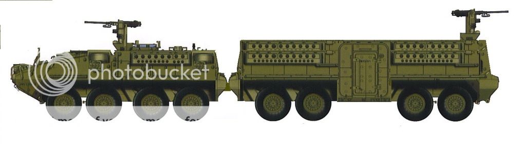

Another variant. This time a side-loader, doors on both sides for faster on & off loading, with a remote weapon station at the rear for added protection from RPG-wielding bad-guys.
PS: Thanks to Trumpeter for the original artwork, that I'm butchering.
For a sideloader, I'd bring the two trailer wheel stations closer together.  You don't want to belly.  Now, unless you're planning of legions of men to handload this vehicle through those generous side hatches, I'd simply have a flatbed with drop sides.  Rely on MHE (Mechanical Handling Equipment for the non-qualified.  In otherwords Forklifts).  Put on its back a little cubby for a self-loading forklift.  You'll see them on the back of civilian trucks.  Basically they drive up to the back of the truck, insert their forks in the appropriate slots and hoist themselves up and are then strapped on and that is how they travel until needed.  They're three-wheeled with power to the front two and the third on a pivot for steering (although steering is actually accomplished usually for gross movements by differential hydraulic power to the front two).    The key is speed - fast load, fast unload, gone!  The less time spent at an RV or distribution point (DP) the less time the enemy has to detect what is going on.  Giving each vehicle the ability to load and unload itself is the best way of achieving that.  Everything is palletised from ammunition to fuel, to water, to rations, etc.   You drive up, drop your sides, drop your forklift and off comes the pallets in a long line on one side.  The units which are being supplied drive up on the otherside, select what they need, load and drive off.  Whats left gets reloaded and you're gone.   If done properly it looks like absolute mayhem, moving vehicles, shouting people, masses of dust, confusion but its all got a sort of order to it and the DP Master controls the lot and if things a really bad, has a stop watch and when he says, "that's it!"  That's it and everybody clears out.
Saw 1 Armoured Regiment do a complete regimental resupply in 1 hour and 45 minutes.   Ammunition, fuel, water, rations, clothing (if required) and they were gone.  Hardest 1:45 I've ever worked in my life and I was a runner, dashing up and down, organising which vehicle had to go where.  We used a herring-bone pattern for that one.  Two lines of Log vehicles with a centre lane each AFV, etc. came in, in and they peeled off to the vehicle they needed.  They'd then go exit the outside and come back around to the centre to find the next vehicle needed.   We had amusing signs made up for the POL Bowsers, the Ammo vehicles, etc. so they wouldn't miss them.  By duplicating the lanes we speeded up the process.  In the debrief afterwards, I suggested to the boss we should have added "Med & Dent" to the end for a proper "one stop shop" and he thought about it but decided it'd slow things down too much.  ;)
