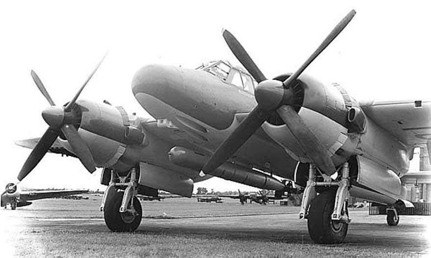

How about a navalised Brigand? LOTS of power and big wings, and a crew of three, enough to aim the things properly and fly the aircraft too.
Logan Hartke
Quote from: PR19_Kit on July 27, 2012, 11:02:46 AM
That was my thought, too, but the Brigand was only rated for two 1,000 lb bombs.  Do you think it could lift that weight?
Thanks,
Logan
Wiki says the Brigand could carry one 22" torpedo plus two 500lb bombs, or one 2000lb or two 1000lb bombs, so I think it's possibly more to do with layout of the pylons than actual weight limits. The Buckingham (the wings and tail of which were used for the Brigand) was specced for 4000lb, so I see no reason why the Brigand couldn't lift a similar load.

The Brigand TF Mk.1 could carry a single torpedo on the fuselage centreline.

It could take two torpedoes.  I guess this was what Jon was alluding to, much shorter torpedoes were available post-war, I think the Gannet would have struggled to fit the WWII era fish into it's weapons bay.
Quote from: tigercat on July 27, 2012, 03:27:18 PM
or a Centaurus powered Beaufort or Beaufighter.
That pretty much is a Brigand.  ;D
