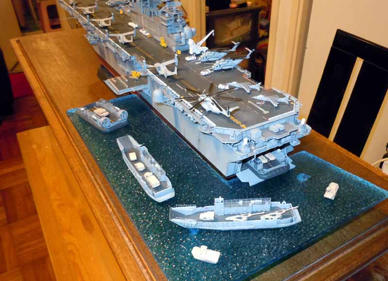

seadude
This is gonna be a multi-part post.
PART 1
Maybe most people know this already or maybe they don't. For those that don't, let me try to explain. ;) Gallery Models has gotten the upper vehicle deck and the starboard side cargo/vehicle loading hatch all wrong.
Some people may already know that I have talked about converting my Wasp kit into an amphibious hospital/humanitarian relief ship. But I'm not content to have the well deck, hangar deck, and upper vehicle bay deck covered and not very visible. I don't want to see stuff through the stern well gate or the hangar elevator openings. I want to do something like this:
http://www.modelshipgallery.com/gallery/am/ijn/shimokita-700-pv/shimokita-index.html
........and cut out certain sections of the hangar bay floor as well as sections of the flight deck and insert clear acrylic sheet so that onlookers can see down into the hangar bay, well deck, and upper vehicle deck.
But in order to view the upper vehicle deck, here's where Gallery screwed up. Mind you, I want to show the ENTIRE upper vehicle deck.
Here is a pic looking from starboard (Bottom of pic) to port (Top of pic).
http://img.photobucket.com/albums/v216/icyhusky/Amphibious%20Hospital%20Ship%20Model/DSC05469.jpg
The small piece of tape on the outside of the starboard side hull is where the starboard cargo/vehicle loading hatch is. The small piece of tape on the interior port bulkhead is where the port side cargo/vehicle hatch is. Now when you line the tape up going straight across the hull as in this pic:
http://img.photobucket.com/albums/v216/icyhusky/Amphibious%20Hospital%20Ship%20Model/DSC05470.jpg
..........both hatches should line up, which they sorta do.......almost.
Now look at this pic:
http://img.photobucket.com/albums/v216/icyhusky/Amphibious%20Hospital%20Ship%20Model/DSC05461.jpg
........with the starboard side at the top of the pic, and the port side of the ship in the middle of the pic. Look at the far right piece of tape going across the hull. When I was inserting parts for test fitting, I noticed there was no molded/scribed interior starboard side cargo/vehicle hatch doors. Also, Part H2 bulkhead wall would block where the starboard hatches would be. See instruction sheet pic here for Part H2:
http://www.modelwarships.com/reviews/ships/misc/amphib/350-lhd1-mrc/instructions-06.jpg
Another pic below to help show what I am talking about:
http://img.photobucket.com/albums/v216/icyhusky/Amphibious%20Hospital%20Ship%20Model/lineedits.jpg
What the interior starboard side SHOULD look like is this from what another modeler did:
http://img.photobucket.com/albums/v216/icyhusky/Amphibious%20Hospital%20Ship%20Model/IMG_34623.jpg
And here's a pic of the upper interior vehicle deck. Notice sunlight coming through both the port side hatch (On the left) and the starboard side hatch (On the right).
http://img.photobucket.com/albums/v216/icyhusky/Amphibious%20Hospital%20Ship%20Model/r3.jpg
Also notice the Conflag station on the right side of the pic, and how this looks exactly like what the modeler did in my link slightly further above.
So, in short........Part H2 is too long and should only be half as high. And Gallery forgot to mold/scribe the starboard side interior hatches. Granted, most everything I explained won't matter to a lot of modelers since a lot of people aren't going to show the interior anyway in their Wasp kits. But for me, it is important. ;)
PART 2:
Concerning the upper vehicle deck again, it seems Gallery didn't make it long enough. Using this pic that I found on the Net as a guideline:
http://img.photobucket.com/albums/v216/icyhusky/Amphibious%20Hospital%20Ship%20Model/interior.jpg
........the upper (and lower) vehicle decks should extend well forward past the RAM missile system (See red line). But in the pic below, the decks don't.
http://img.photobucket.com/albums/v216/icyhusky/Amphibious%20Hospital%20Ship%20Model/DSC05466.jpg
The upper vehicle deck should reach all the way to the piece of tape on the right, but the deck is roughly 1 1/8 to 1 ¼ inches too short. Looks like I'm in for a bit of scratchbuilding.
PART 3:
Using these pics as guides, there is a ramp that goes down from the upper vehicle deck to the lower vehicle deck (See yellow line in first pic link).
Opening in floor below the words "Live it" on the banner.
http://img.photobucket.com/albums/v216/icyhusky/Amphibious%20Hospital%20Ship%20Model/Photo9_11.jpg
Green rectangle in this pic:
I want to create that same opening/ramp that leads down from the upper vehicle deck to the lower vehicle deck. Is the green rectangle in the third link a good enough approximate location? I'm not going to create a complete lower vehicle deck. I just want to show the floor opening/ramp.
PART 4:
I also want to cut out a section of the hangar bay floor and replace it with clear acrylic sheet so people can see down into the well deck. The following pics show a taped section I was thinking of cutting out. It measures approx. 7 ¼ inches long x 1 1/8 inch wide. I think the length might be ok, but I'm not sure on the width. Any suggestions? Further additional pics show red lines where cuts will be made, and green lines where the well deck wall bulkheads go.
http://img.photobucket.com/albums/v216/icyhusky/Amphibious%20Hospital%20Ship%20Model/DSC05463.jpg
http://img.photobucket.com/albums/v216/icyhusky/Amphibious%20Hospital%20Ship%20Model/DSC04983.jpg
http://img.photobucket.com/albums/v216/icyhusky/Amphibious%20Hospital%20Ship%20Model/DSC04985.jpg
http://img.photobucket.com/albums/v216/icyhusky/Amphibious%20Hospital%20Ship%20Model/DSC04980.jpg
http://img.photobucket.com/albums/v216/icyhusky/Amphibious%20Hospital%20Ship%20Model/DSC04981.jpg
http://img.photobucket.com/albums/v216/icyhusky/Amphibious%20Hospital%20Ship%20Model/DSC05008.jpg
PART 5:
So if you've read this far, then congratulations. ;) I still want to cut out certain sections of the main flight deck itself and replace them with clear acrylic sheet so people can look down into the upper vehicle bay and the hangar bay. But I'm undecided on where to cut and how long/wide the openings should be? Any suggestions?
http://img.photobucket.com/albums/v216/icyhusky/Amphibious%20Hospital%20Ship%20Model/DSC05465.jpg
PART 6:
According to the bottom of this diagram:
http://img.photobucket.com/albums/v216/icyhusky/Amphibious%20Hospital%20Ship%20Model/wasp.gif
........there is a ramp that goes from the flight deck down to the hangar bay. I'll assume it's this ramp here in this next pic that the Marines are walking up on.
http://img.photobucket.com/albums/v216/icyhusky/Amphibious%20Hospital%20Ship%20Model/jhgfds.jpg
Is this a special ramp for flight deck vehicles to go up/down from the flight deck to the hangar bay and vice versa?
