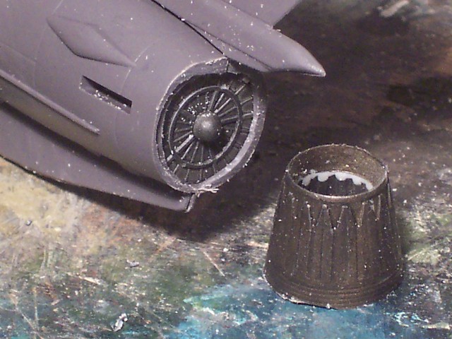

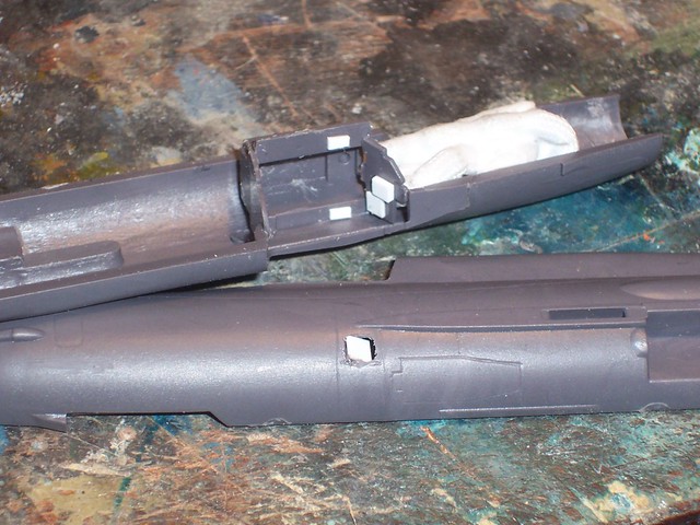

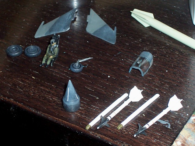

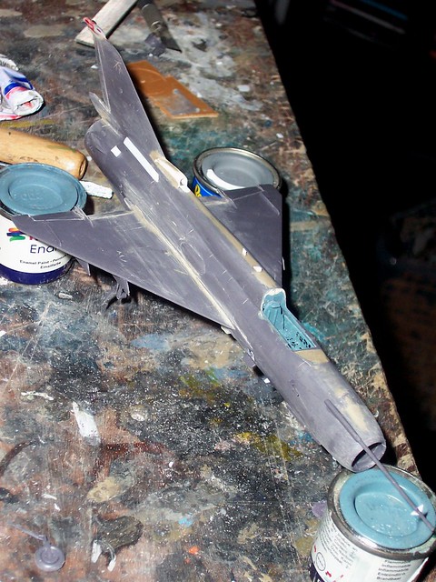

The kit is a Mastercraft MiG-21 in 1:72 scale, one of the many clones of the vintage Kovozavody Prostejov (a.k.a. KP) kit with some mods, including engraved panel lines. It is a good basis for such a conversion since almost no part fits to another... It was cheap, though, but you get what you pay for. BTW: especially funny is the nicely depicted KM-1M ejection seat in the building instructions, with a detailed description and painting instructions - but the kit just includes a crude, L-shaped "thing" with a blob as a head rest...
1:72 Mikoyan Gurevich MiG-21G (Whif) - WiP by dizzyfugu, on Flickr

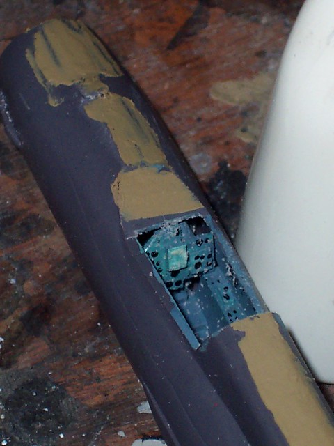

Additions include a new engine exhaust nozzle (a shortened piece from an Italeri F-15), the new gun blister under the fuselage, the IR sensor under the nose, a RHAWS pod on top of the fin and the extra air scoop at its base, the blow-in doors under the wing roots were opened, chaff/flare dispensers added from scratch, a pair of AIM-9Ls with respective launch rails and a different drop tank (from an Academy MiG-23).
A new seat was added, from an Italeri Tornado, as well as a Matchbox pilot figure. Landing flaps and the rear fuselage air brake were opened for a more 'lively' look. Changes should only be visible at second glance and in superficial details, but still set this fantasy variant apart from the real thing - much like an IAI Kfir from a Mirage V.

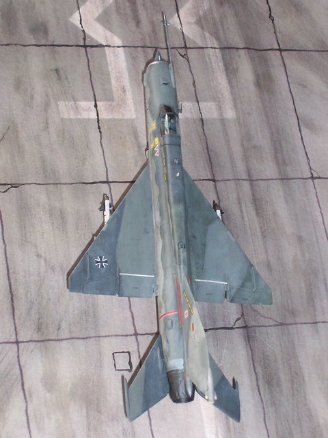

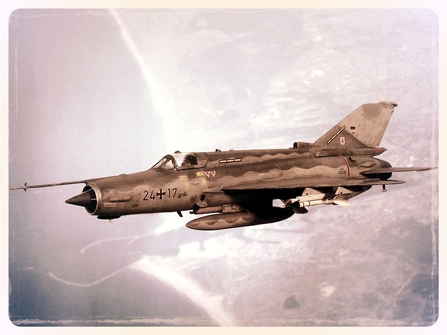

Painting and markings:

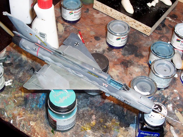

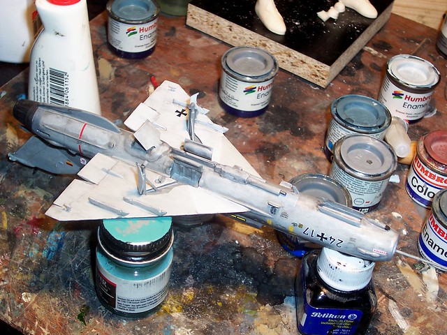

This whif rather draws from its livery, even if it is subtle, too. For the MiG-21G I tried to transfer the German F-4F's so-called 'Norm 81A' paint scheme, which is appropriate for the model's time frame, even though rather late: Norm 90J was next, which was introduced with the F-4F KWS.
1:72 Mikoyan Gurevich MiG-21G; "24+17", JG 71 'Richthofen', Deutsche Bundesluftwaffe; Wittmundhafen, 1995 (Whif) by dizzyfugu, on Flickr
Norm 81 is REALLY complex. There are two basic patterns, comprising alone four(!) grey tones for the upper sides, one light grey tone for the sides and then, additionally, a two-tone scheme for the lower sides! Huh!
Since these colors are all RAL tones, I had to approximate them:
Upper sides:
RAL 7009 Grüngrau à Revell 67 (authentic)
RAL 7012 Basaltgrau à Revell 77 (authentic)
RAL 7037 Staubgrau à Humbrol 106
RAL 7039 Quarzgrau à Humbrol 92 (not available anymore, used Revell 47)
Fuselage sides/fin:
RAL 7030 Steingrau à Revell 75 (authentic, but used Humbrol 64)
Lower sides:
RAL 7001 Silbergrau à Humbrol 127(used Humbrol 166)
RAL 7035 Lichtgrau à Humbrol 196 (used Humbrol 147, which is a tad darker)
Authentic RAL tones are available (e .g. from Revell), but emulating them is not a true problem since the Norm 81 scheme quickly deteriorated and lightened up in real life, so much that you can hardly tell one color from another. Besides, you rarely see a 'clean' German F-4F in Norm 81 livery. Hence, the model received a double wash with very thin black ink and also a treatment with very fine sand paper, which helps blend color edges and creates pretty realistically 'worn' areas and flaws. This was further enhanced through  dry-brushing with shades of grey.

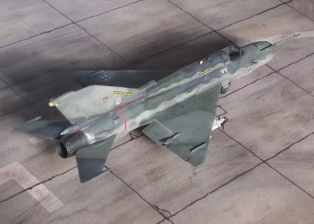

Other external color mods are the di-electric panels, e .g. the shock cone in dark grey or the fin cap in medium grey instead of the typical bright green of Russian origin. I mixed Humbrol's 32 with 168, for an unidentifiable tone which was later dry-brushed with light grey for a worn and 'plastic-like' look.
The markings were puzzled together from various sources: national insignia, the tactical codes and the JG71 emblems come from TL Modellbau aftermarket sheets. Stencils and other small markings from a German MiG-21 and other appropriate scrapbox findings. Another nice detail are the formation light strips - it adds some color to the grey-in-grey aircraft.
A further 'copied' detail are the four thin white stripes on the radome, an idea I took from German Tornado fighter bombers.
Since Revell enamels do not go well with Humbrol matt varnish (which I prefer), I tried Revell's acryllic matt varnish - and the expeiment was a real success. Good stuff!
So, a small project with little effort – done in just four(!) days from sprues to varnish. Painting the model kit was the most complex task. But even though the MiG-21G looks a bit 'grey in grey', the result is pretty plausible, even elegant. Nice whif!

Norm 81 in its usual tatty state rather suits the Mig21  :thumbsup:
Nicely done, and quite believable.
Keith
Many thanks to all of you - highly appreciated!  :cheers:
I was actually very amazed how "natural" the MiG looks in this shabby livery - as if it had always been the plan to have the machine in Luftwaffe colors. The finish also came out much better than expected, and for the rather poor/primitive kit base, the result is much better than even hoped for.
I mean, it is not a blatant whif, you have to look at least twice and there have been MiG-21s in Luftwaffe colors. But this one is so "underneath the radar", I am looking forward for the first critical comments at FlickR for forgery and confusion of the masses...  ;D
