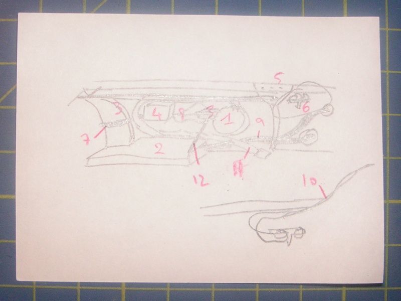

Here is one more tip: when you go the whole hog and do everything you can see on your reference pictures it's a good idea to work out a sequence of steps. Because it's very easy to be a fraction of a mm off and the next part does not fit. Plus things have depth, so that one part cross over another but if you don't notice and you glue it first you won't be able to fit the next part under it!
Like the build as a whole you need a strategy, a plan. You can even sketch all the parts of let's say one side wall on a piece of paper and number each as to sequence of putting them in place. You avoid some nasty surprises this way. Trust me, I know!

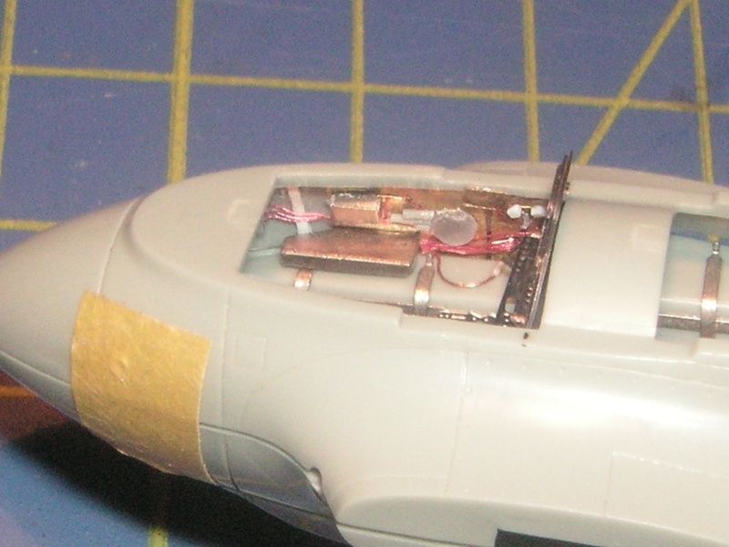

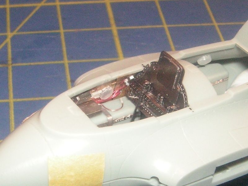

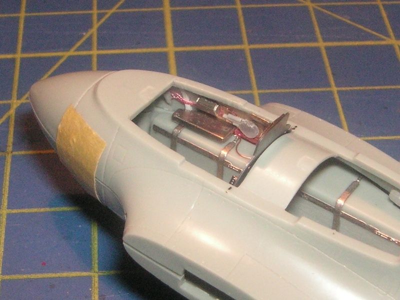

Here is the other side wall, finished.
Before getting started on it I sketched out the parts, including the Eduard etch and my home-made stuff, and numbered them as to the sequence of attaching them. It helps a lot in speeding things up and avoid nasty surprises when the detailing is so dense.
And here is the end result:
I have left off the oxygen tube, which would have been an encumbrance during painting, and of course the pre-painted Eduard parts.

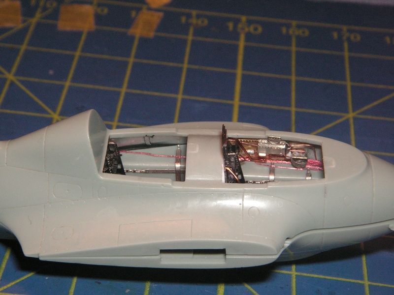

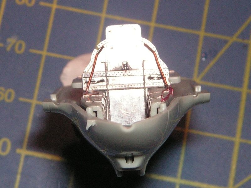

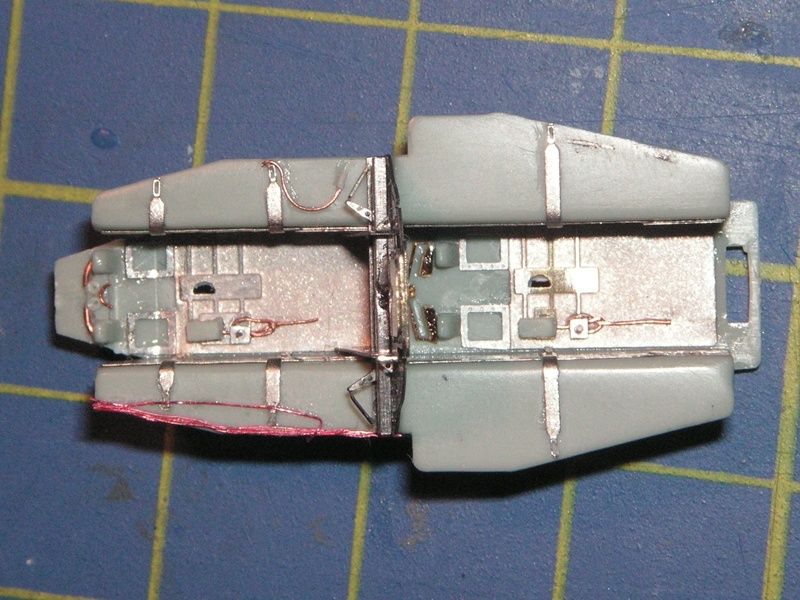

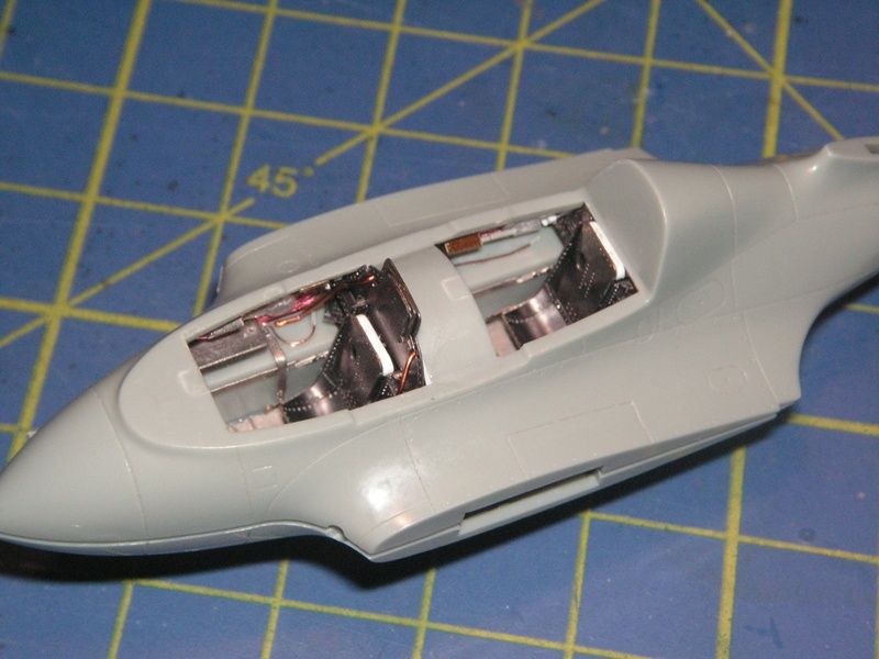

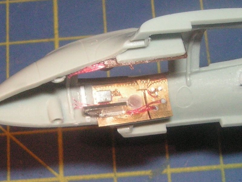

Hello everyone, this is your detail junking back for another round!  ;)
The detailing of the pit is finally complete, wheww...
In pictures:

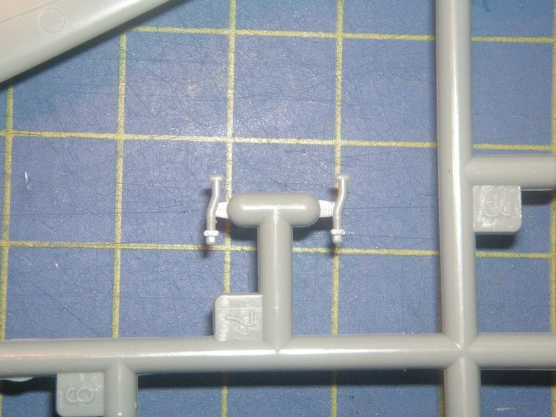

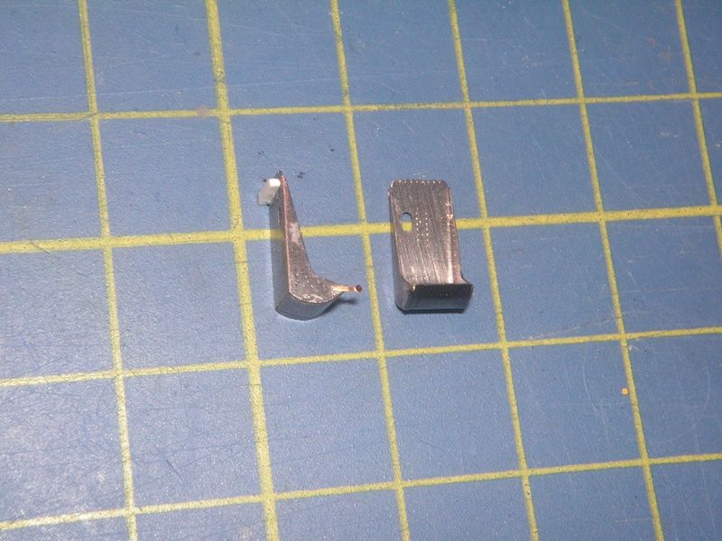

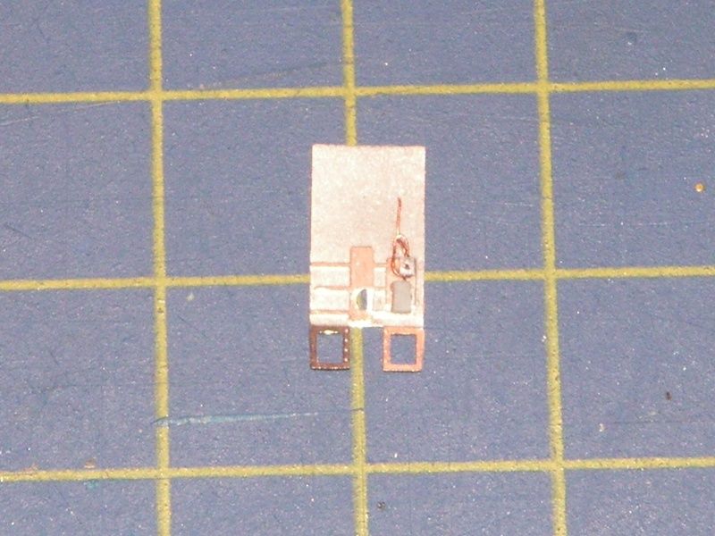

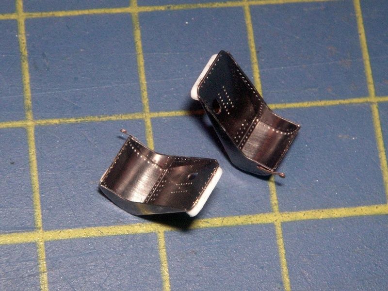

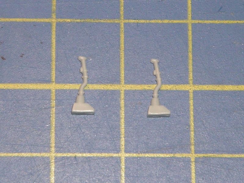

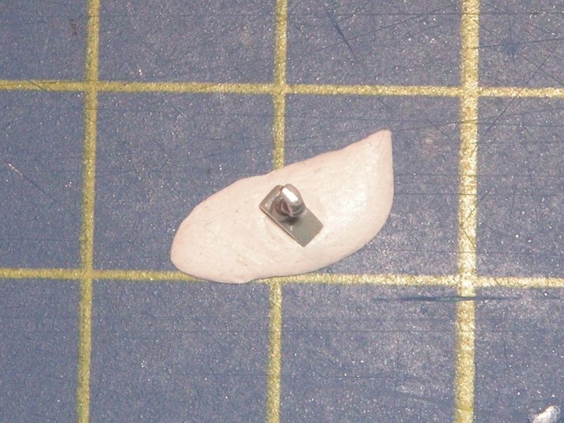

The seat received a scratchbuilt guide for the harness in the back and an adjustment lever on the side, the latter a  leftover from the PART PE set.

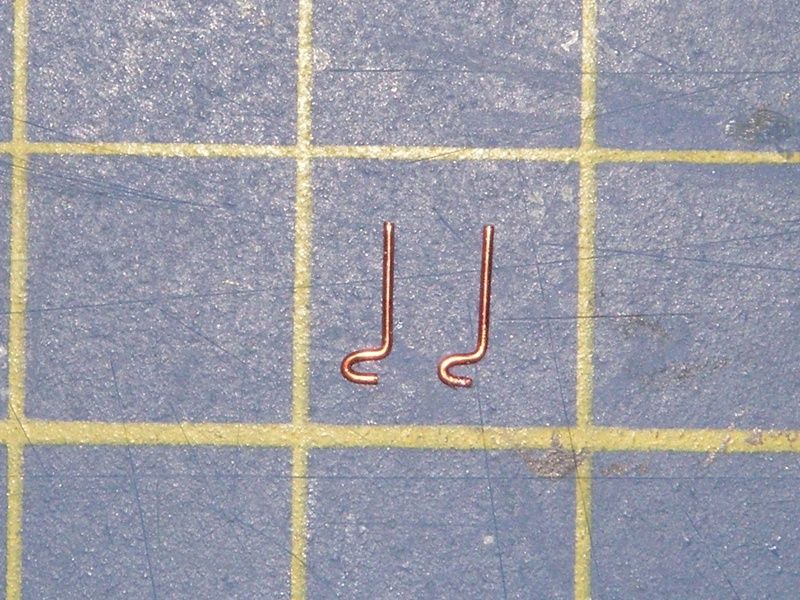

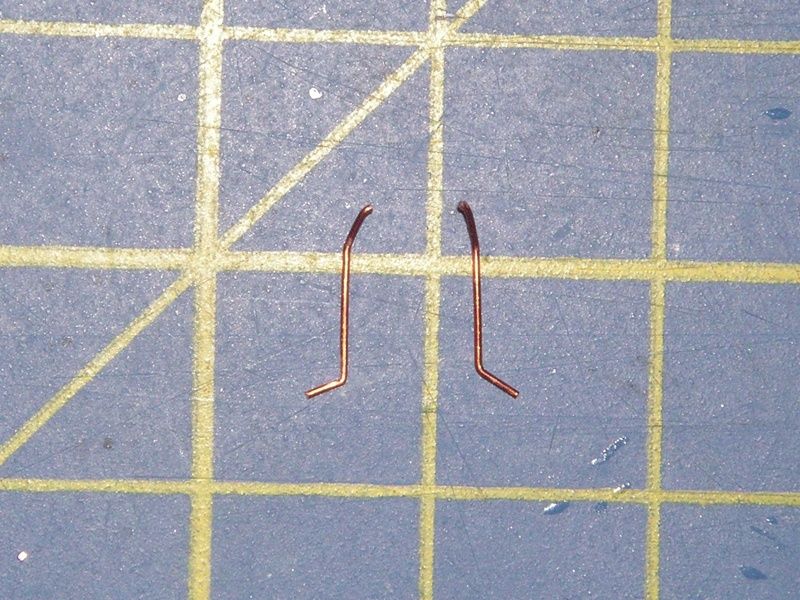

The flaps levers provided by Academy did not match reference pics.
So I made new ones out of copper wire. (I'll add blobs of white glue as knobs after painting.)

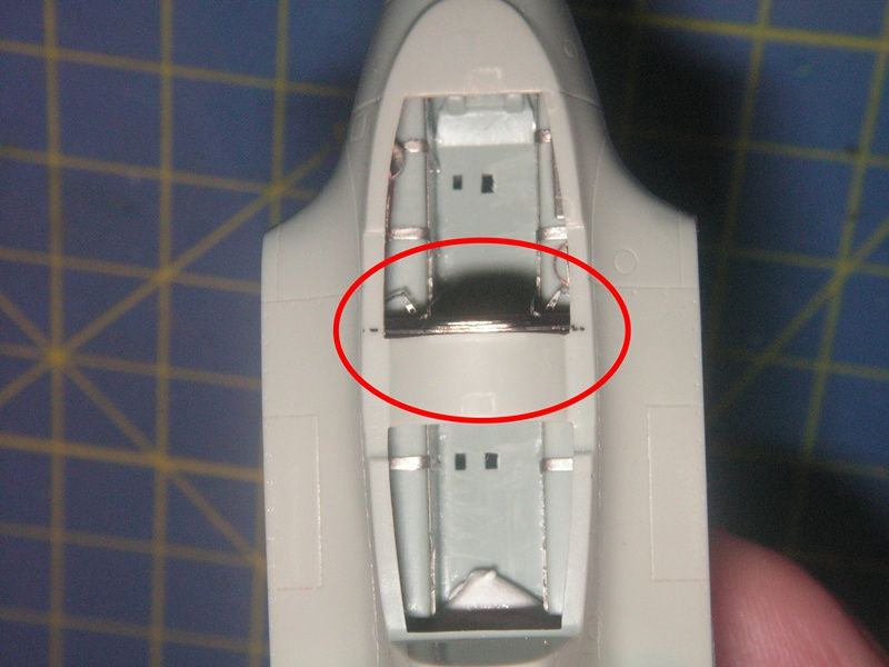

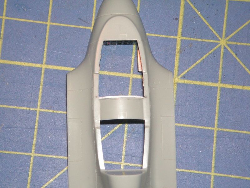

The floors:
Ouch, bad fit of the bulkhead.
Evergreen shim in place.
And shaped to fit.

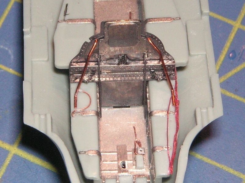

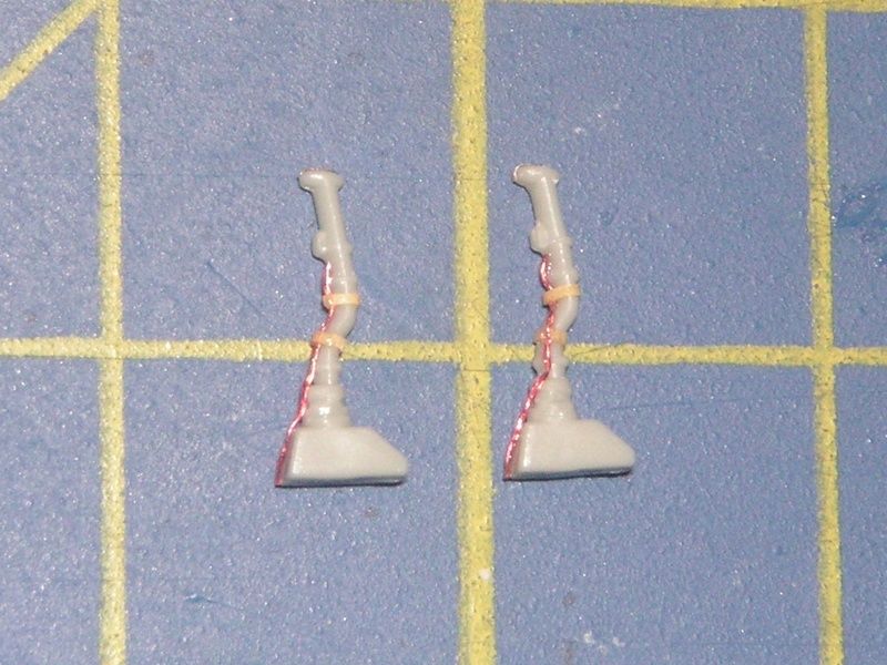

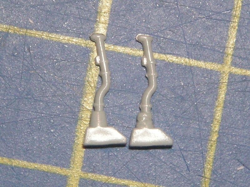

The control columns from the kit are pretty nice...
But, you know me now...they lack detail!!  ;D
The flexible cover at the bottom was shaped by making notches with a razor saw and rounding the hard edges with liquid cement.

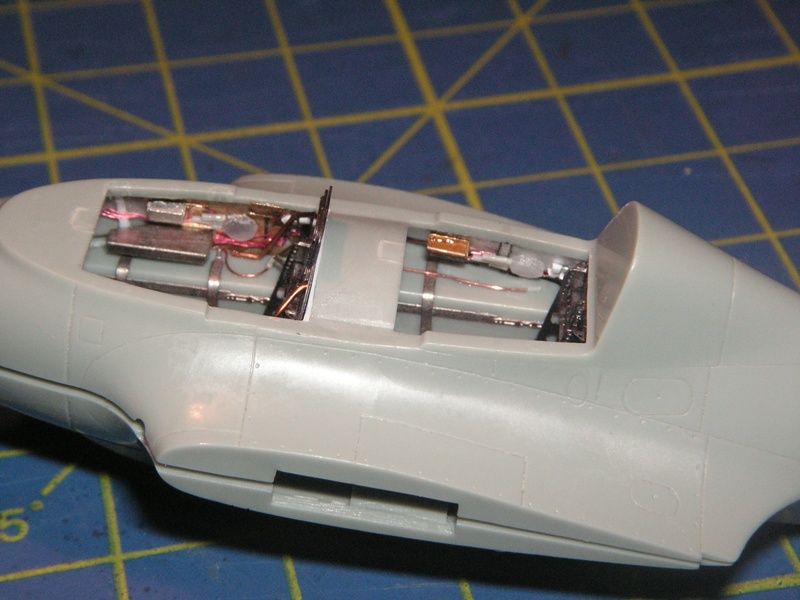

The trigger safety was made from a piece of foil.

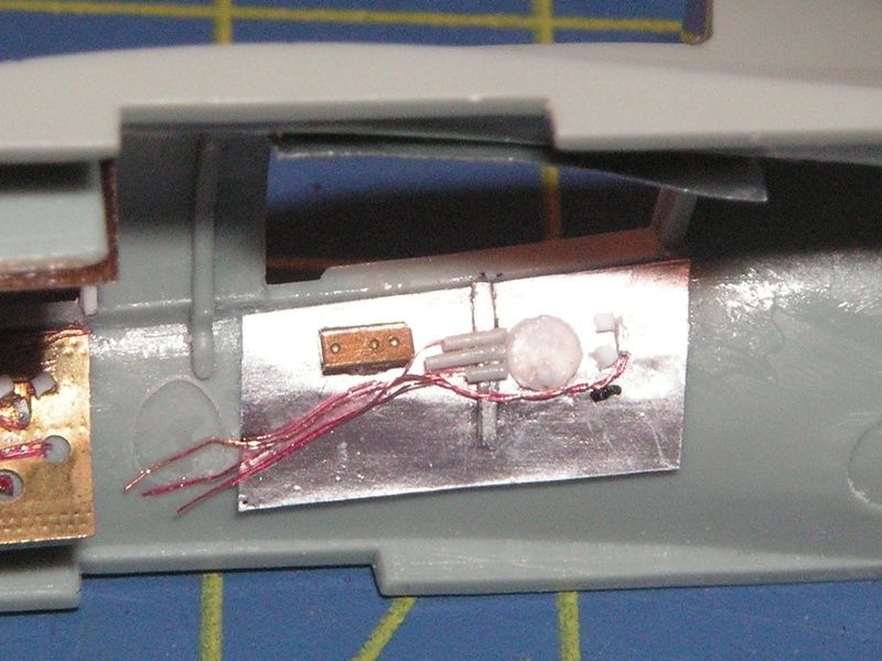

Electric wires: copper wire and Tamiya masking tape.

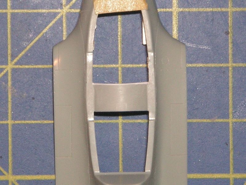

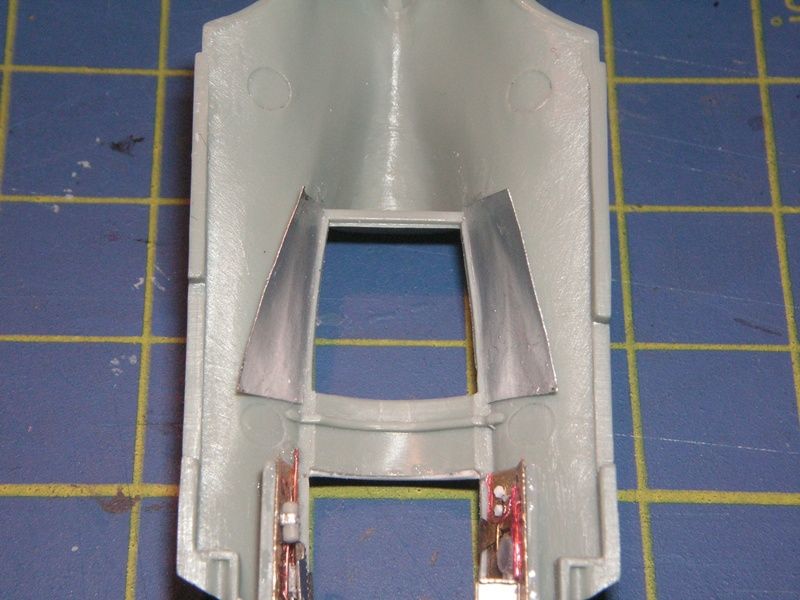

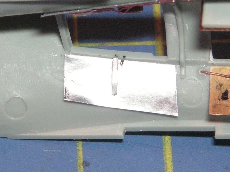

The back pit side walls were missing so I made some with alu foil.
The right wall received detailing similar to the front pit.

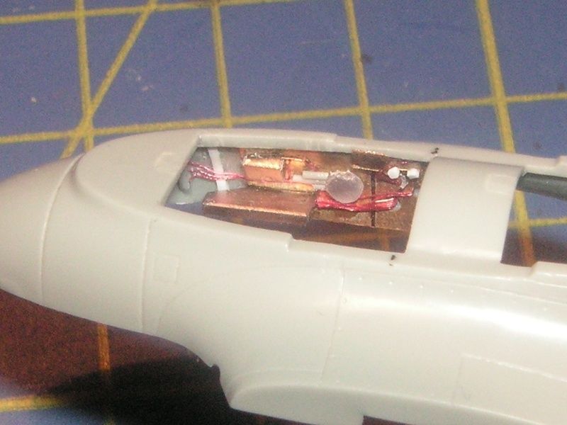

On the left side the hardest part was to resist temptation and refrain from adding detail which, per my research, wasn't there!  ;D
For the T-stoff lines I used copper wire. The lines are useless as the S had no engine. But as this version was converted from the B it's somehow plausible that they just left everything as-is in the front pit when they made them, including tanks and lines, doing only the absolute minimum work necessary.
Plus I like the look of them.  ;)
Putting it all together:
The time has come take out the paint jars!
