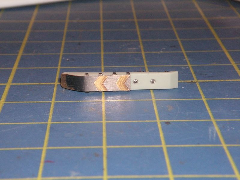

So, let's get this thing rolling !

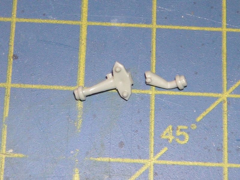

Here's what Academy has to offer in terms of landing gear.

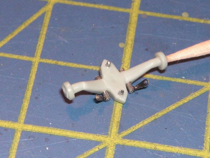

OK, it comes in one piece. It was me who broke it while snipping it off the sprue. ;D Before sticking the pieces back together I made some improvements.
The mounting lugs come from the Eduard fret. Their axles are bits of hypo needle. The alignment pins are bits of wire of the right gauge to fit into the holes under the skid.
This way no need to glue the dolly to the skid, which is something I didn't want to do. The fit is so good that the dolly traverse stays attached once you press it into place. Let's see if it still stays on with the additional weight of the wheels...

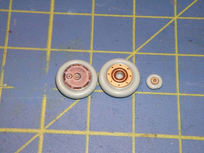

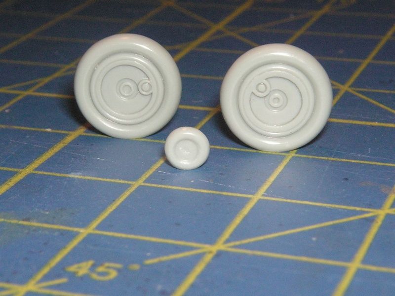

Talking of wheels:
I used the old trick of the hot pressing iron to flatten the tires. Wheel rims come from Eduard and PART. I'm really glad I bought both frets and I'd advise anyone who intends to super-detail the Komet to get both. Between them, they cover every single aspect of the kit.

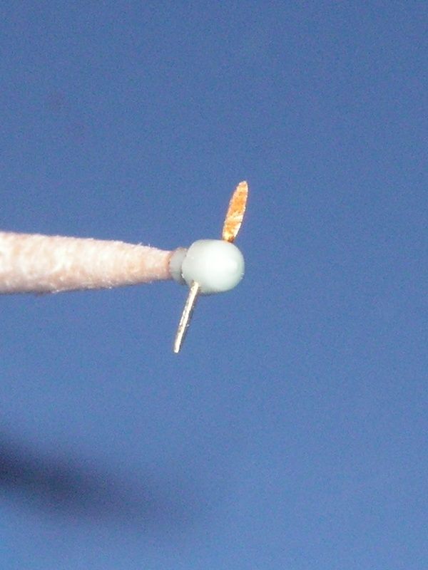

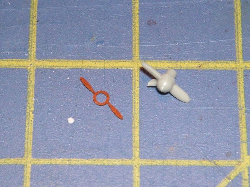

The generator prop, for example, is covered by PART but ignored by Eduard.
Rather than slip the PE part onto the axle, as suggested, which would place the blades behind the spinner, I cut them off and stuck them into small holes I made on each side of the spinner. The off-center is intentional, just like on the real thing.
