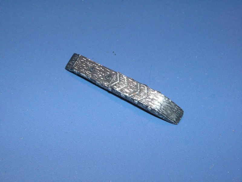

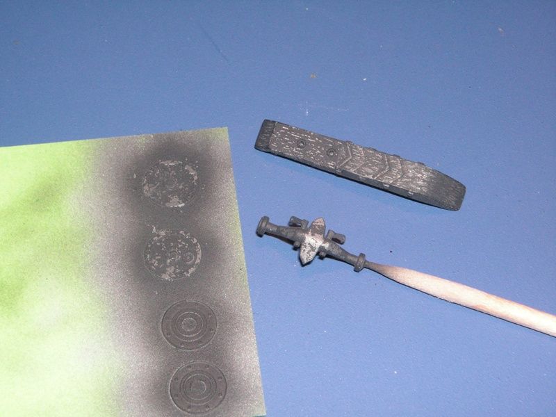

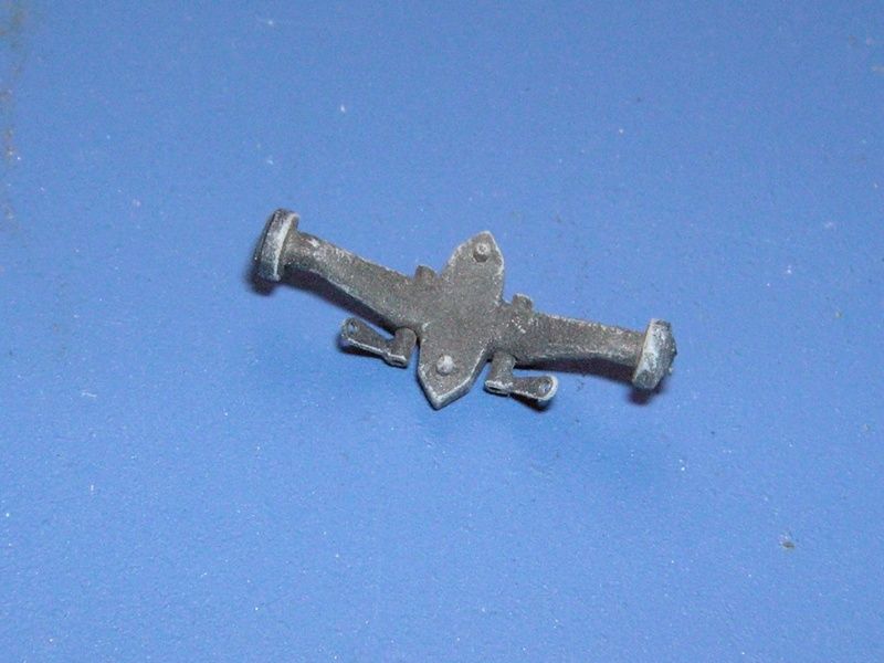

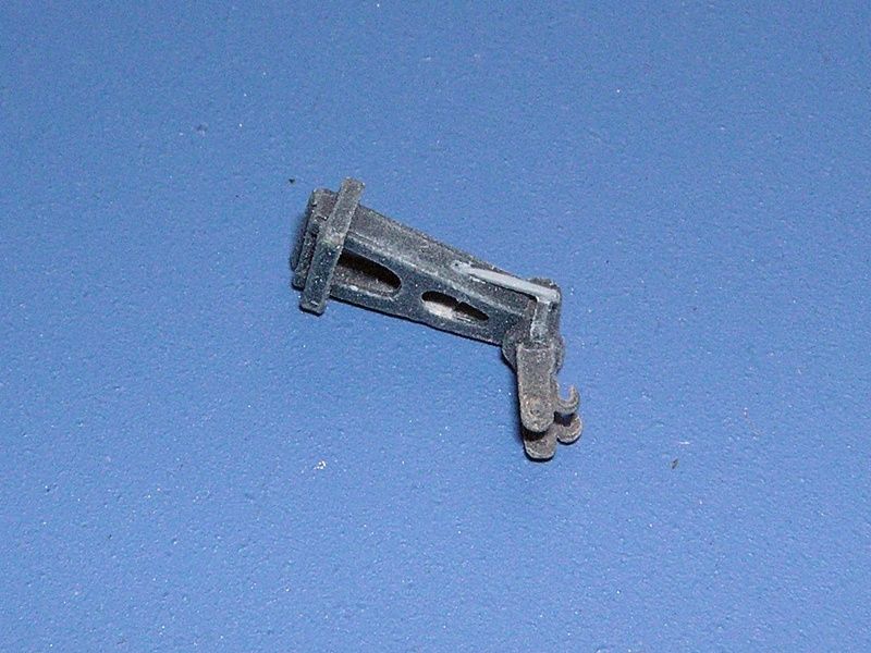

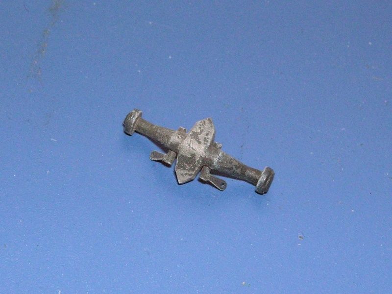

Here's (loosely) the sequence of steps I followed to paint and weather:
-   Priming with Mr. Surfacer 1200
-   Undercoat of MM Metalizer Stainless Steel (for those parts requiring chipping)
-   Liquid Mask applied with a sponge
-   Base coat
-   Unmasking
-   Light coat of the base color to tone down the flashy metallic paint
-   Detail painting with Vallejo paints
-   Acrylic sludge wash
-   Dry-brushing with Vallejo
-   Vallejo flat clear
-   Mig pigments
In pics:

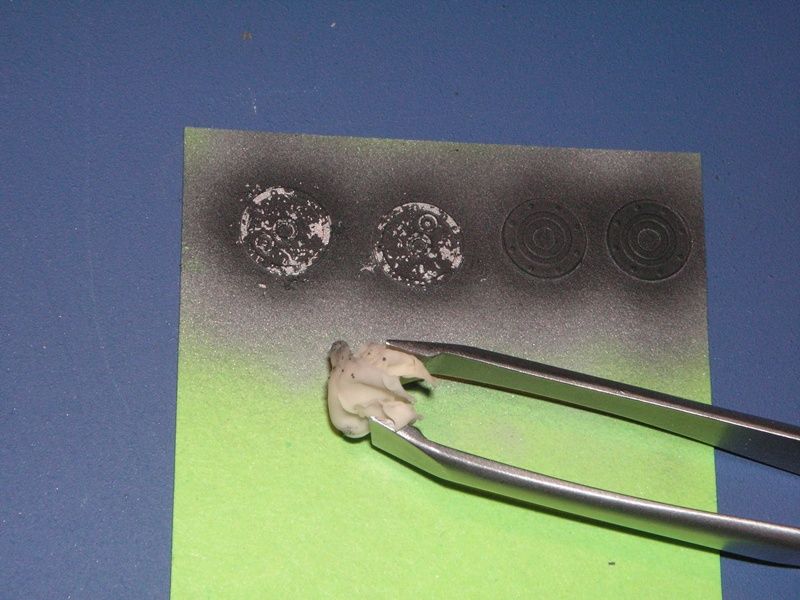

Metalizer and Maskol.
A trick to quickly remove the Maskol: bunch up a small piece of latex from your latex gloves, hold it in your eyebrow tweezers (yours, not your wife's, every self-respecting modeler has got eyebrow tweezers in his tool box ;D) and rub it over the Maskol. The latex will wipe the silicone-based stuff right off.
The result.

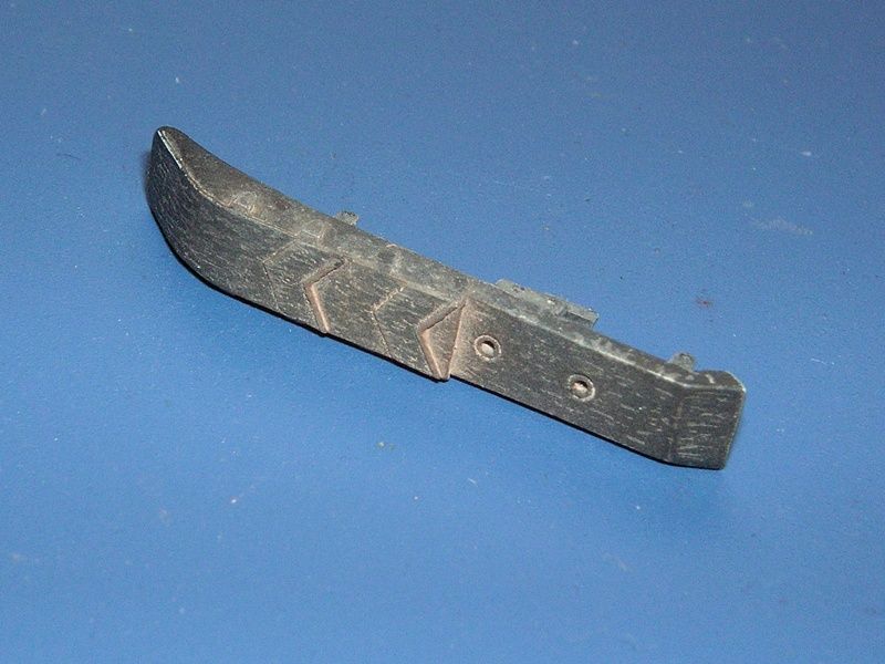

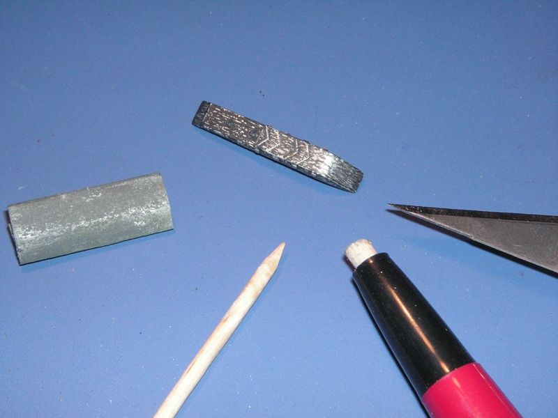

The skid's treatment was different. No Maskol here. Just metal undercoat, black base coat. Then the acrylic paint was scratched, making lengthwise marks.
One can use several different tools to do it. I used them all, including the fiberglass pen.
A highly thinned coat of Gunze Tire Gray was over-sprayed to tone it all down.

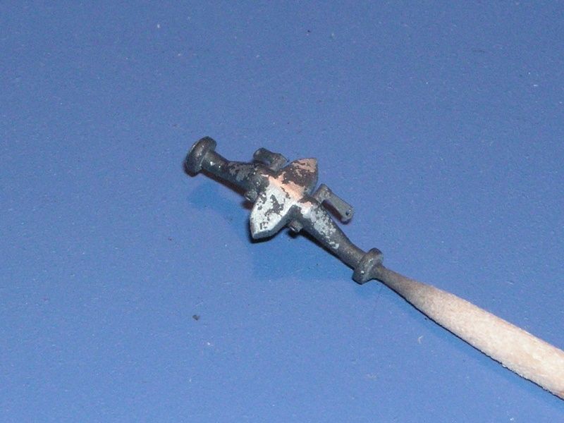

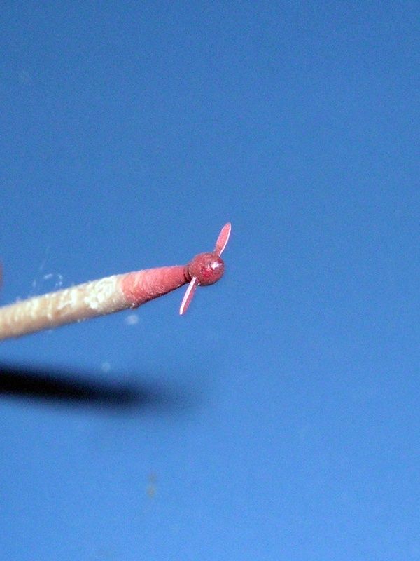

I got more pics but I gotta run so I'll post later. Here's a last one, of the prop.
Kit, blades' pitch is correct, I checked it against my reference pics before gluing them.  ;D As to the prop's diameter it's 5mm or 3/16 in.  ;)

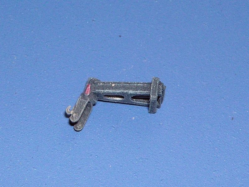

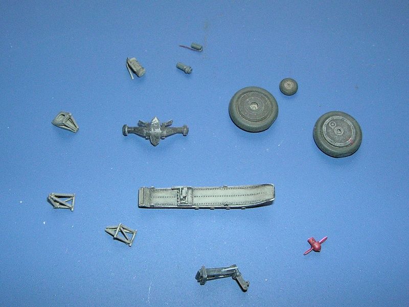

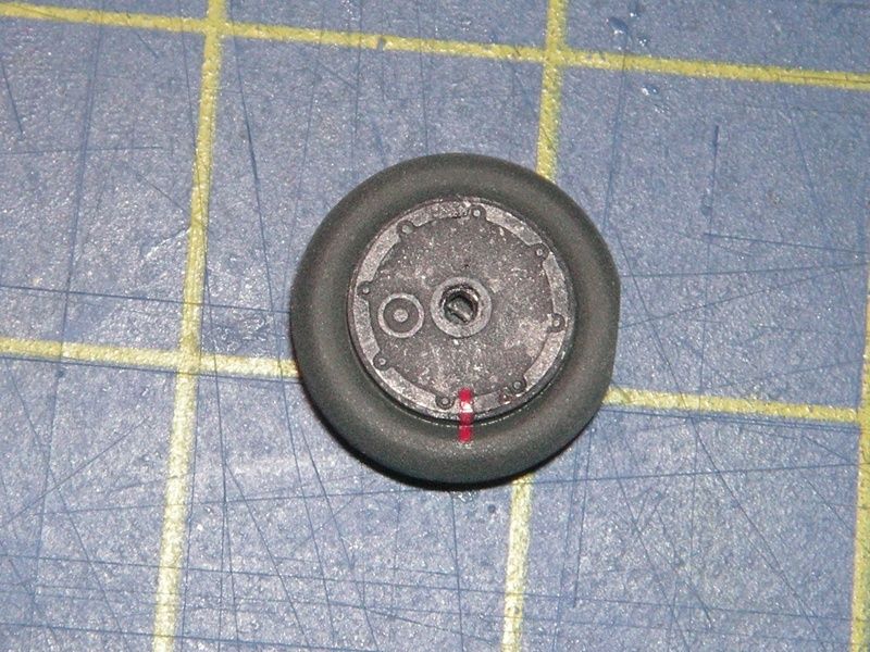

MichelC

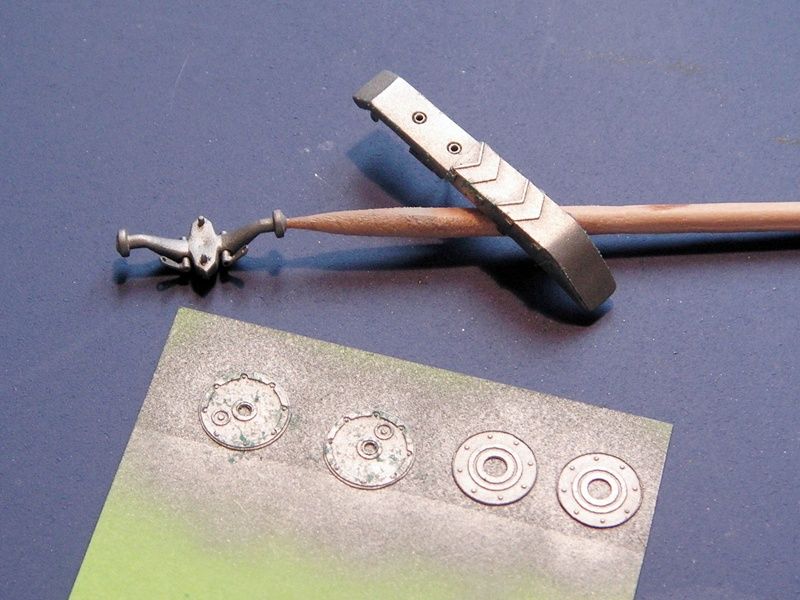

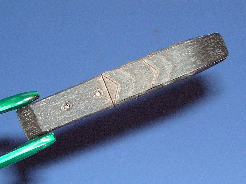

After the base coat, the detail painting, including the tire alignment strip, made from a piece of red decal.
Don't worry about the silvering, it's gone after the flat clear and pigments.
The pigments hide a lot of the earlier work but there's nothing like it to make a part look old and tired.
When used in conjunction, the different weathering technique tend to tone each other down so that the end result is a subtle, very real looking part (IMHO).
I made every effort to keep the airframe as clean as possible because gliders a generally kept very clean. But I saw no reason to do the same with the landing gear. Who's ever heard of a spotless Me 163 skid and dolly apart from a museum curator? So I let her rip.

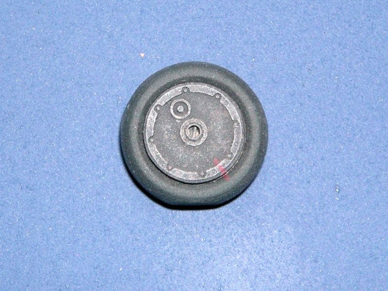

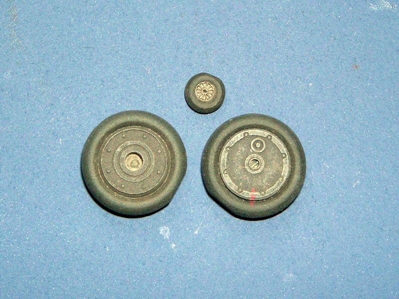

I went up and hauled my own un-built Academy Me-163 out of The Loft and measured the main wheel. Michel's piccie above is EIGHT times full size!!!!!

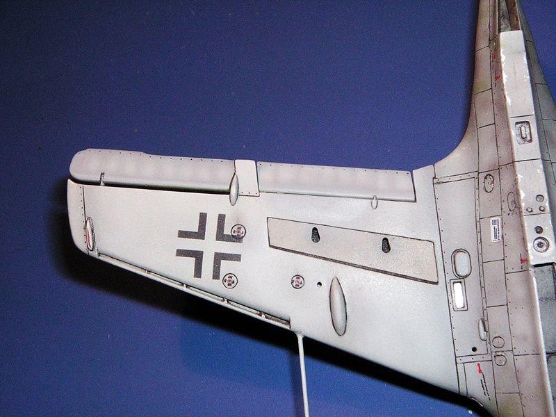

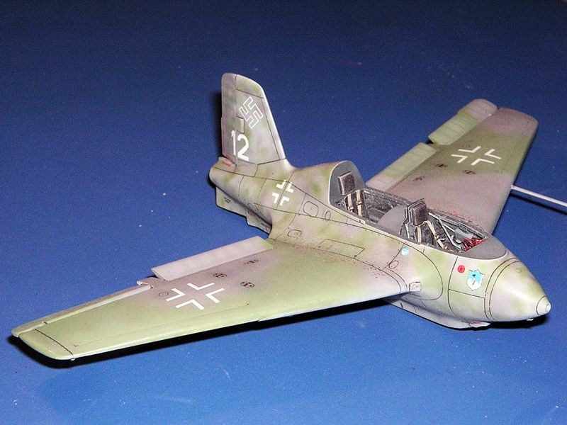

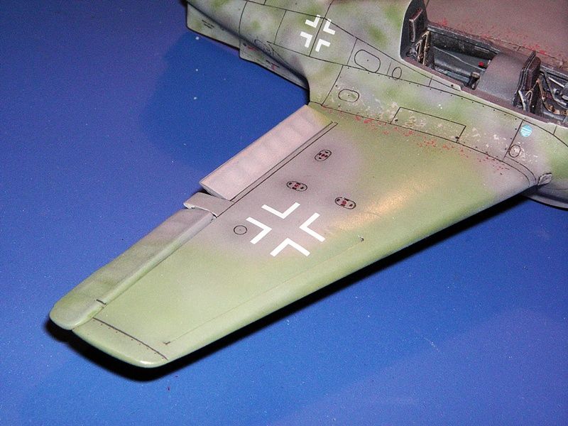

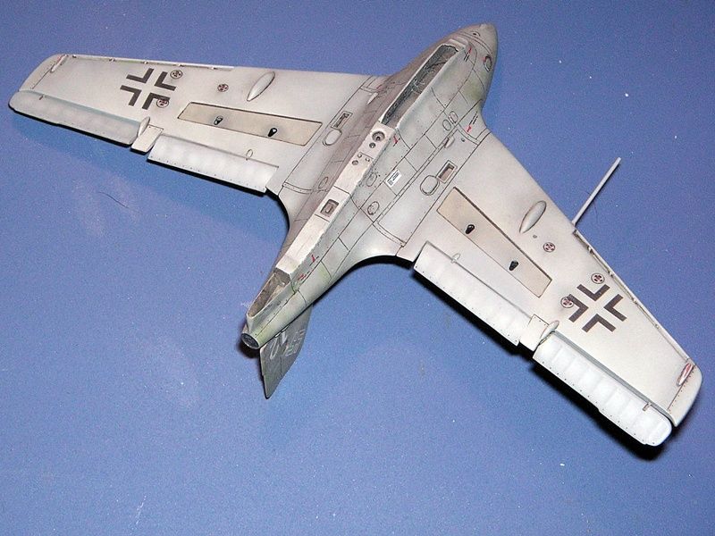

Got some more done today, namely the trip flaps and elevons were painted. I think they'll look sharp once they're attached in their up and/or down positions.
Home stretch now!  :mellow:
M
Father Ennis
Just incredible ... !!!   I'm in awe of your work. It looks real in the photos ... ???   The Gods have blessed you my son,go forth and multiply ...
MichelC
Thank you for your blessing, Father!  ;D

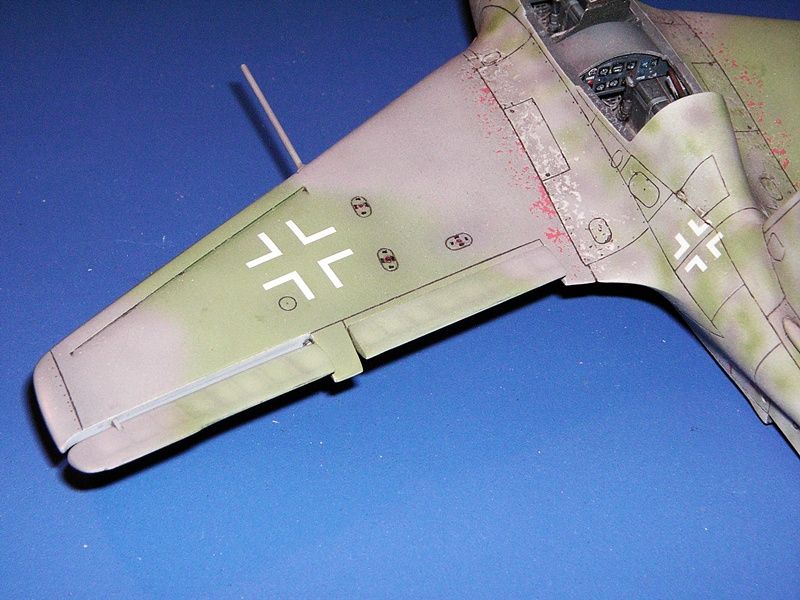

The control surfaces are in place. It was extra work but the result was worth the effort, methinks.   ;)
More soon.
